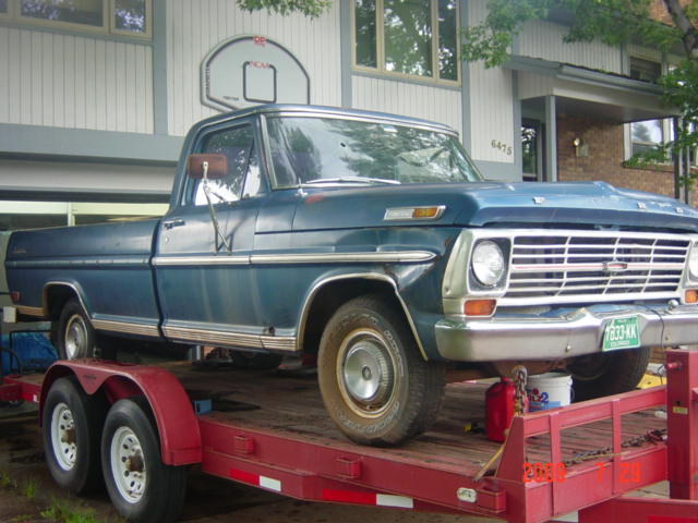

I need some help tuning my Carburetor, I have Manuals and have researched ways to tune it and I seem to find lots of different ways. I cannot get the Idle Mixture, nor the hot and cold idle to jive. It will fire up, but seems to stall randomly, I frequently smell gas, and I just can't seem to get it tuned. Can anyone advise me on how (from their experience) I can step by step, tune my Carb. I have pulled it out, cleaned and rebuilt the carb. Possible troubleshooting ideas as to why it may simply not tune correctly are also appreciated. The vehicle has sat for about 15 years and I pulled it out of the weeds.
I've got a autolite 2100 2B, model C9 TF K, Manual choke.
I really appreciate any help.
