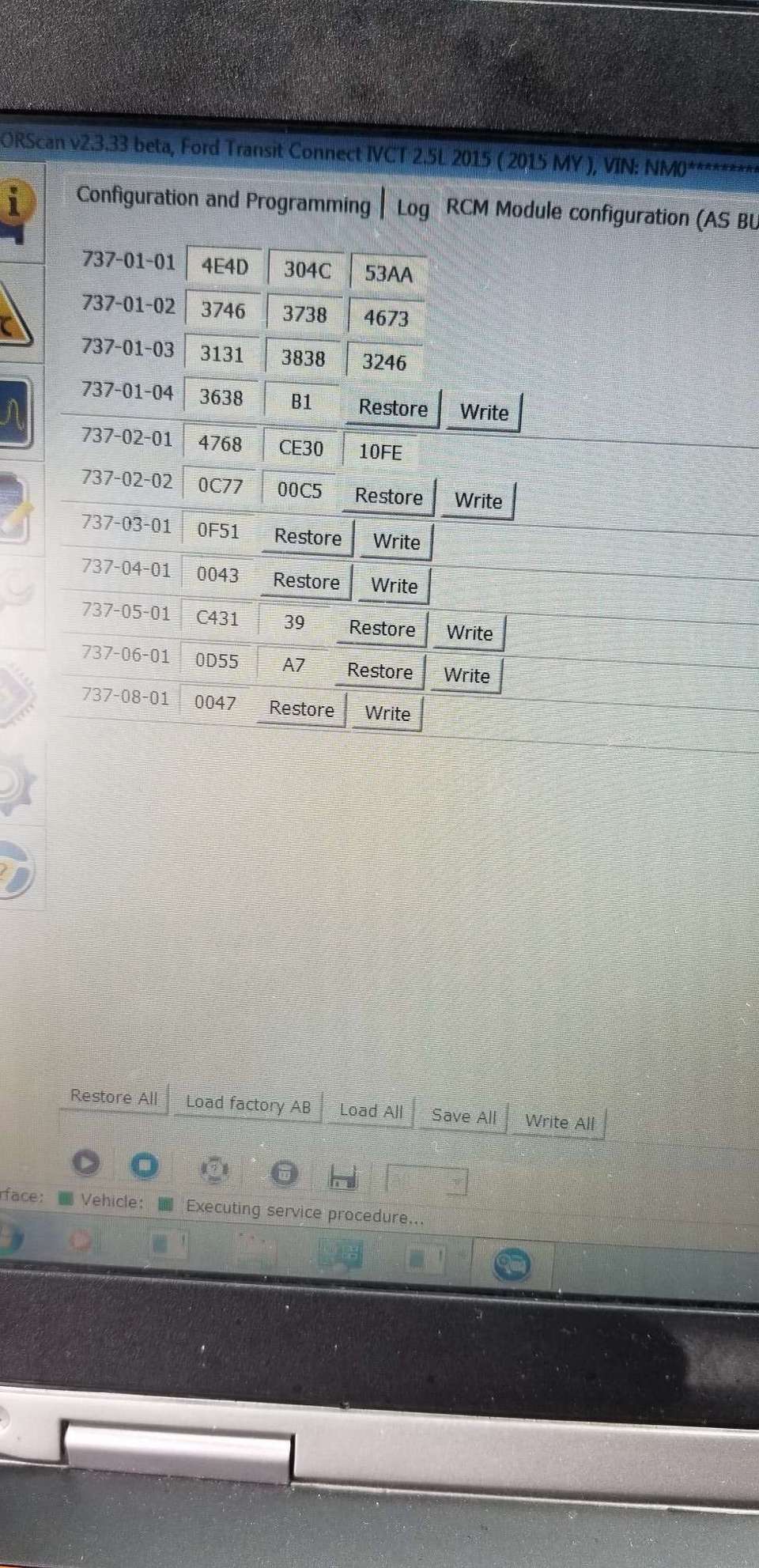

i have ford transit connect year 2015, need to disable occupancy sensor on the passenger seat. is possible to code airbag module without occupancy sensor?
i have forcan and i can change the code but i don't know which code is for occupancy sensor
regards

Isn't it listed in RCM module (not as built) when the list populates?

Does fordscan have programmable parameters? Using IDS its located under module programming. That is where I would look for it, you can turn individual settings on and off with it.

on forscan is not listed what to enable or disable, is just code like on pic. i thought maybe anybody has disabled eccupancy sensor and know which line code should to change

ids has not option to programming enable/disable
