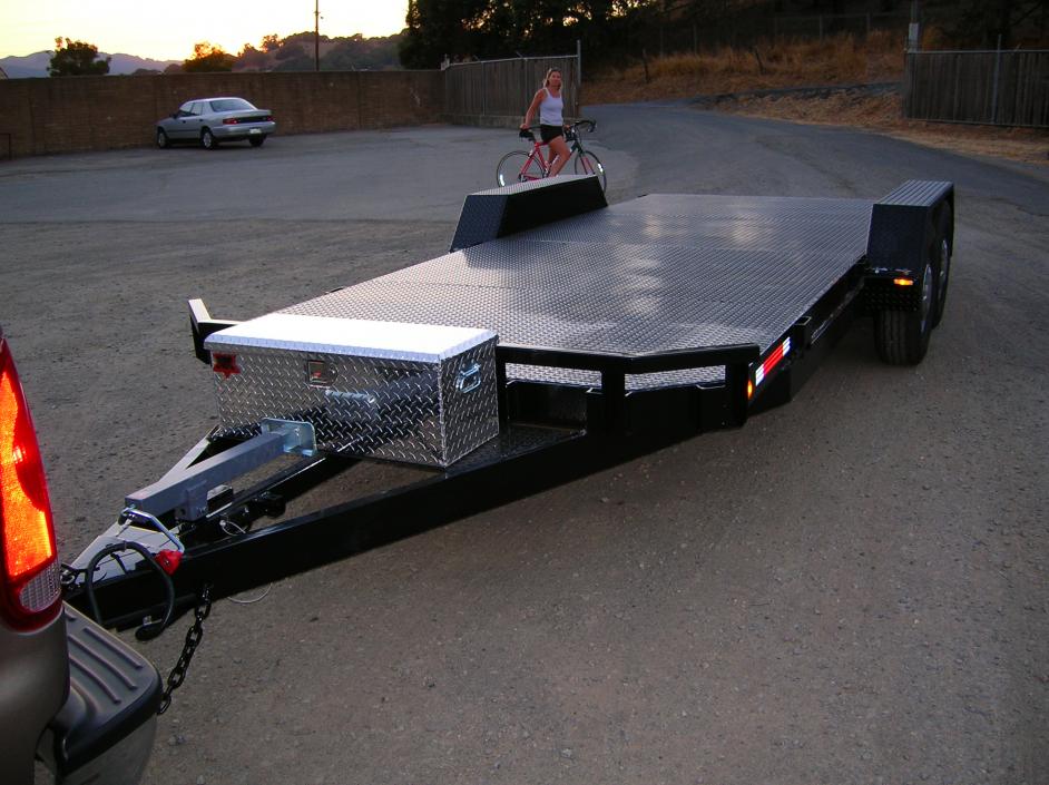

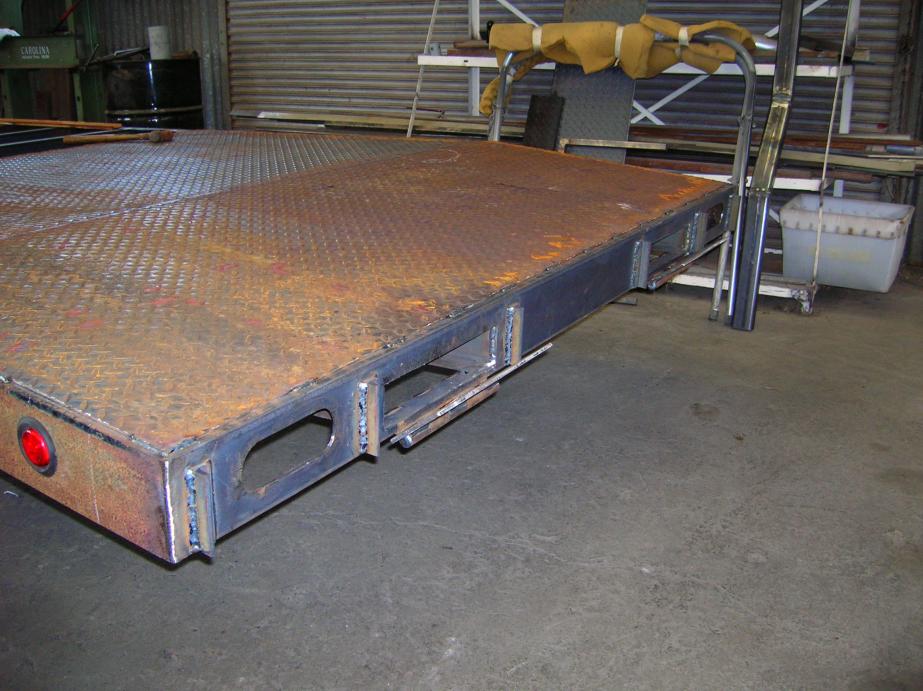

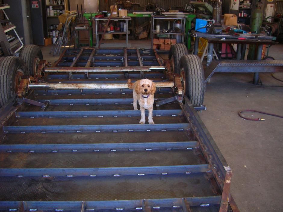

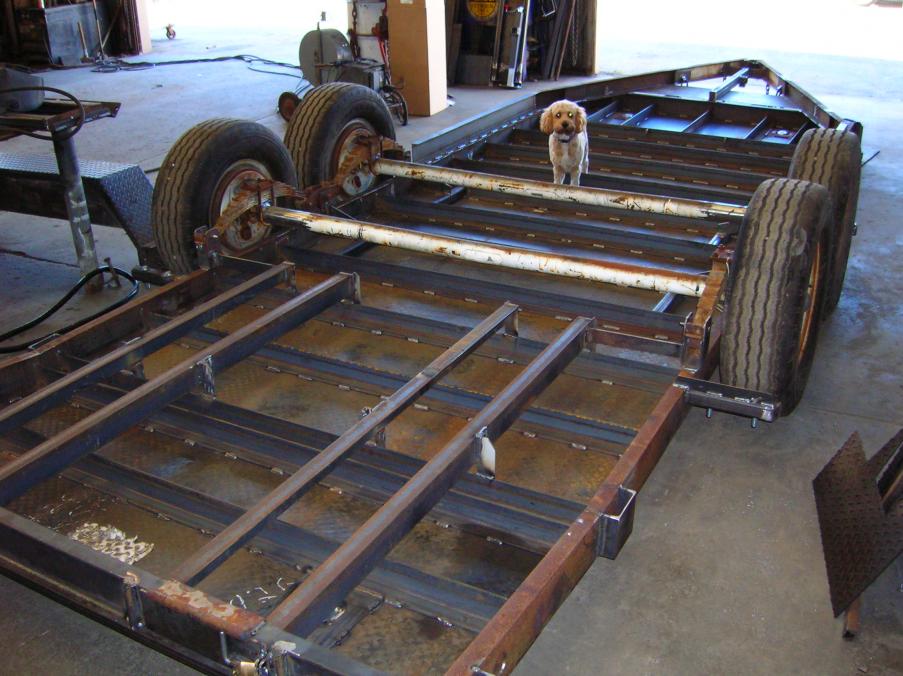

Here’s a few pictures of my car trailer I built from scratch using the Parker machine..
Attached Thumbnails LONGEVITY multipurpose review-dscn0383.jpg   LONGEVITY multipurpose review-dscn0235.jpg   LONGEVITY multipurpose review-dscn0384.jpg   LONGEVITY multipurpose review-dscn0415.jpg   LONGEVITY multipurpose review-dscn0414.jpg

You did a fantastic job on that trailer! Looks like it was purchased new!
