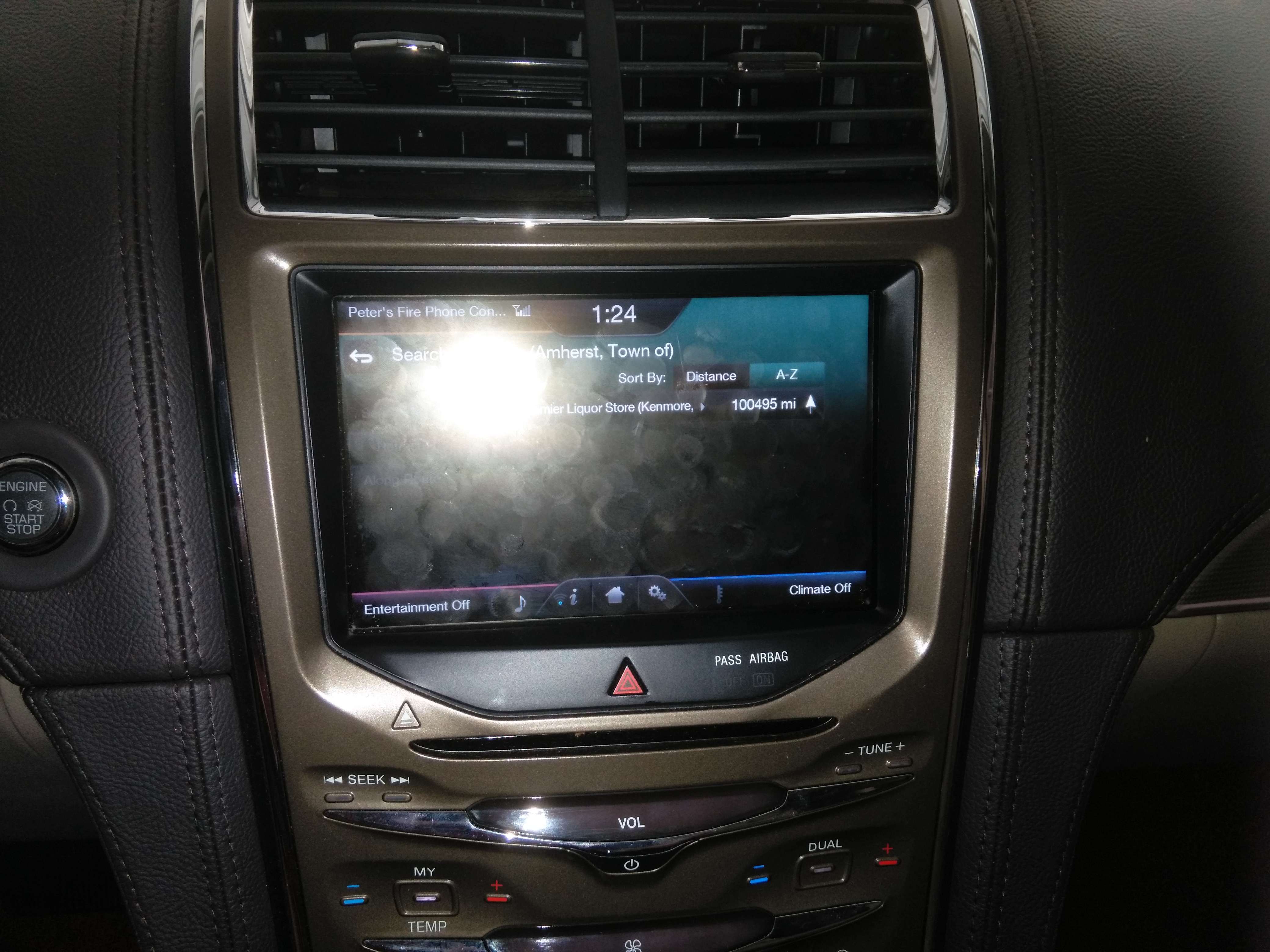

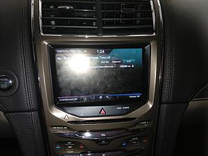

Well, the thread is over a year old but very current. To take it to the max, I was in Plymouth MI looking for a Home Depot. The Ford GPS couldn't find any within many many miles but I knew I had seen one as I drove around. I just didn't know where.
So I used Waze to find it. When I stopped in the Home Depot parking lot, right in front of the store, I tried the Ford GPS again. This time it found 6 Home Depot stores. But, get this, they all were over 100,000 miles away! Right, over 100,000 miles.
Also, at my house I asked for a store that is about 4 miles away (and has been for 20 years). See the attached picture of the Ford GPS screen. 100,495 miles to the store. Sorry for the reflection of the flash.
Ford should be forced to recall and repair this fault.
Note, it is not the maps. Many (perhaps all) GPS companies use the Navtec maps. It is the dumb Microsoft Sync route finding software.
I agree about using the many free cellphone apps that are updated almost daily. But it sure is nice to have information on the large dashboard screen. A lot easier to see then a cellphone screen....well unless you have one of those monsters I see now and then.
