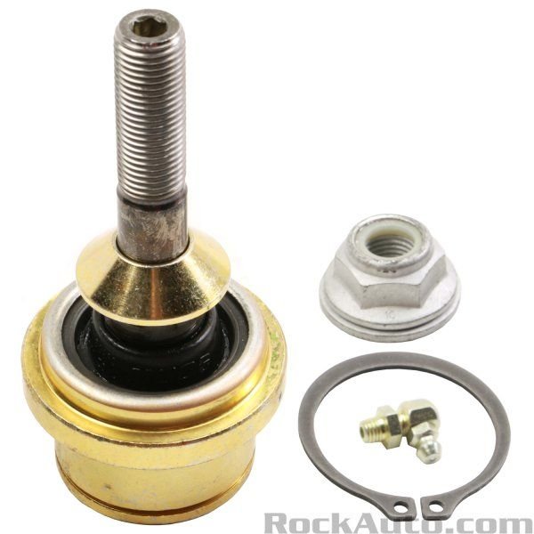

- The Moog BJ I'm considering at Rockauto doesn't appear to have a grease boot. Am I looking at this picture wrong? Is that black part a boot that will expand when it's filled up?

Haven't used Moog, but they look to have an inner boot.

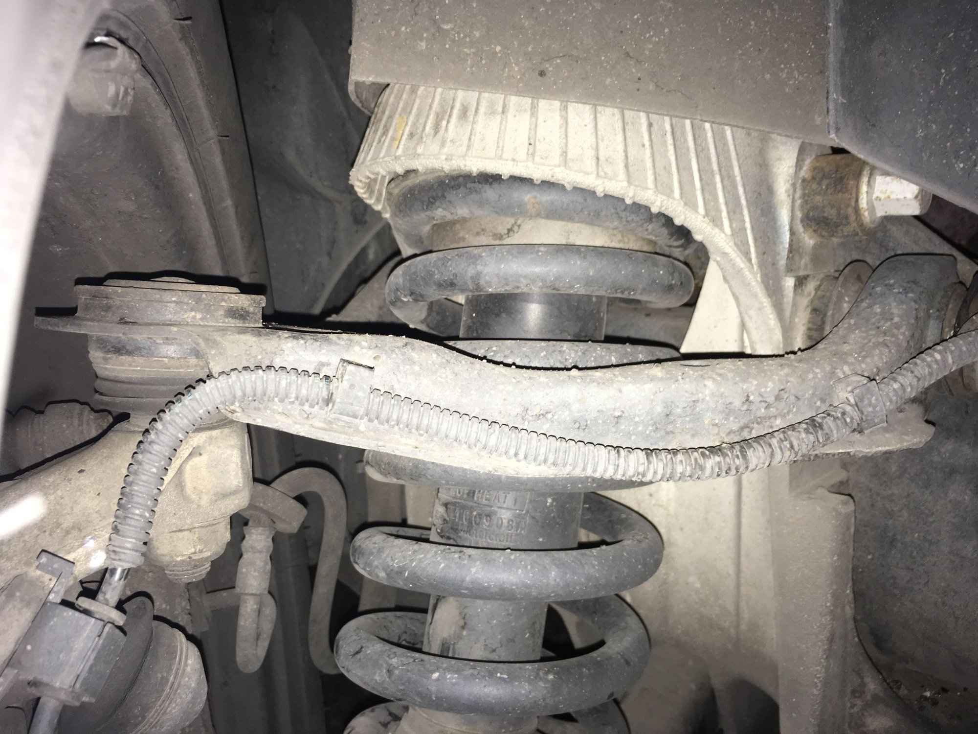

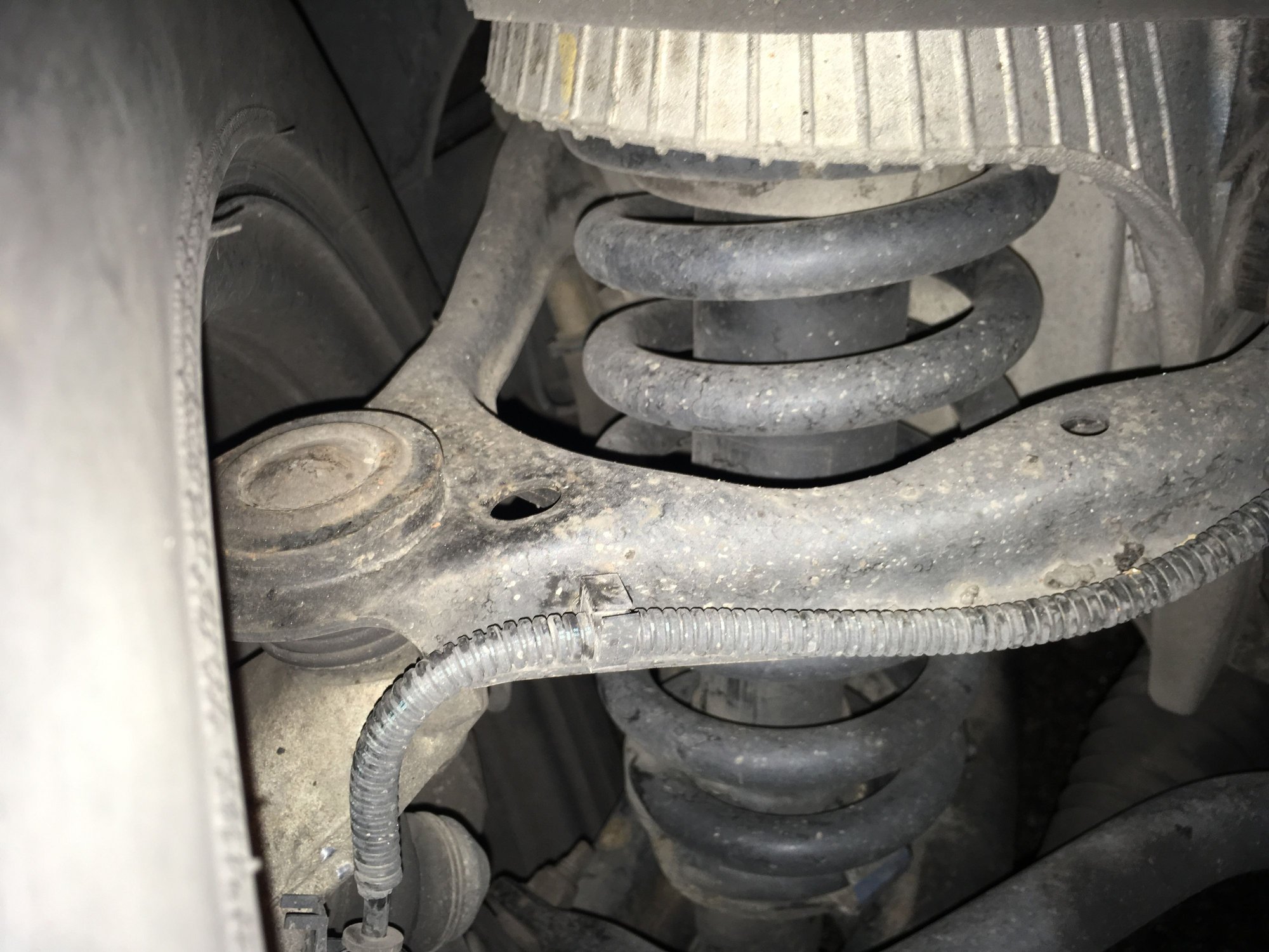

Do I have a stamped steel or forged top A-arm? I believe it's stamped but I'm not entirely sure.
Old Aug 27, 2019 | 09:21 AM
Stamped
