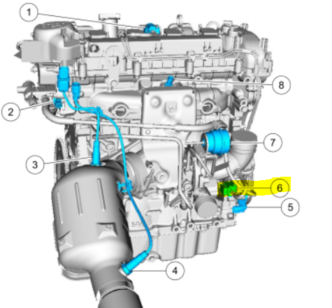

Check your charge air cooler tubes and your vacuum lines for any damage and tight connections.
If none is found then replace the turbo charger waste gate regulating valve solenoid. Take some pictures of where the clamps are and how the hoses are routed before removing the old solenoid.
The solenoid is number 6 below.
Buy a motorcraft solenoid, not some aftermarket brand.

Hi Thanks for the reply Thumbs up I replace the number 6 that is on the picture and it still over boost .Now reader reads that the absolute pressure censer at fault .On the reader it reads that it show a 14.5 lbs pressure at idle and up to 32 lbs when rev up that is probably why it over boosting .So I ordered a knew censer. Any way the way Im thinking if you subtract the normal air pressure which is about 14.5 lbs or so . the rest of the numbers of 17.5 lbs is fairly close to the right turbo pressure I hope I will let you know if im right the part will not be in till Tuesday. PS It is ok for the sarcasm or what ever you call it. Cool I am not perfect . I have no problem with any of it .That is all part of every day of life right. Wink Have a nice day and enjoy. Smile Lionel
