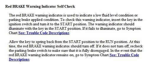

How about red brake light, does it prove out correctly? Check that bulb first, simply step on the parking brake with key in RUN/START position just to check and see if the bulb is good.

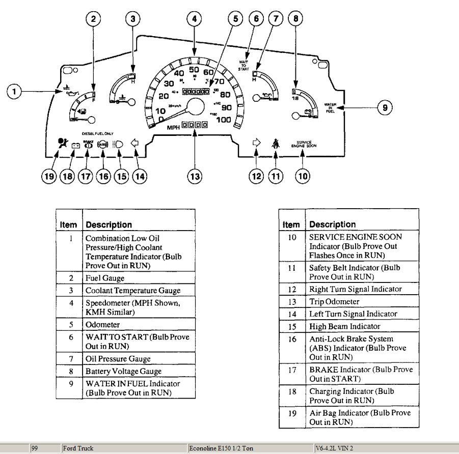

Check below for instrument cluster description:

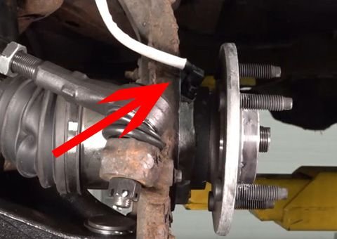

2) Check the inner side of your front wheel, do you see the wire for ABS sensor that looks like this?
You can tell what a brake hose is can you? The abs wire should have a wire loom on the outside.
If you have this on your front wheel then you have 4WABS.

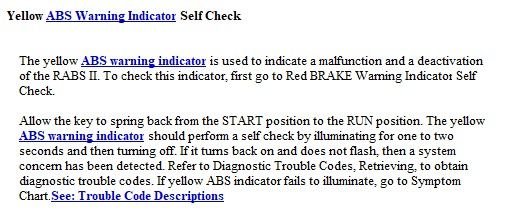

If you have RABS you can't use a scanner to check for codes you have to count the number for flash on your yellow ABS light on cluster.

I asked you previously about RED brake lamp, then you replied "ABS Light is on yes". ABS light is yellow, not red.
I gave you instructions previously to test the RED brake lamp you ignored that. I need to find out if your RED brake lamp is blown or not.

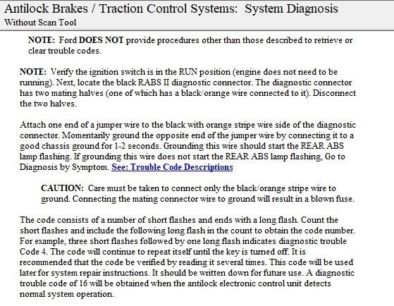

Now, to retrieve the DTC please follow directions below:

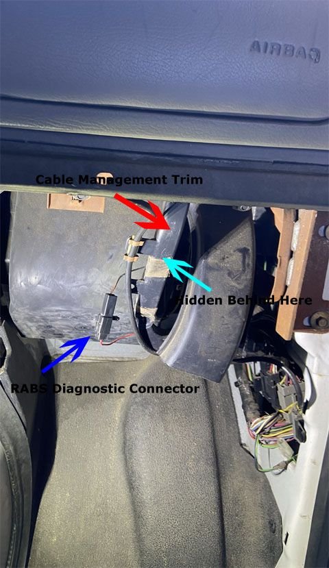

Where is the diagnostic connector?
Underneath dash on passenger side, remove the passenger side knee panel, then the metal knee panel support in the back, then you will see a vertical black plastic cable management trim, the diagnostic connector is hidden behind the cable management trim, feel by hand you should be able to locate it. Look at the pic below:
Then follow instructions above and separate the connector and short it to chassis ground, once you get the flash count number let me know then I can give you more details on that.

If your van can't brake and stop when needed in the middle that can be a major disaster. What else is more important than braking system, it's your instrument cluster, you need to do the bulb check test on all bulbs make sure they all prove out correctly. So when you get a chance to check on your red brake light, check other bulbs too. Later on if you want to upgrade all those to LED, start a new thread as well.
