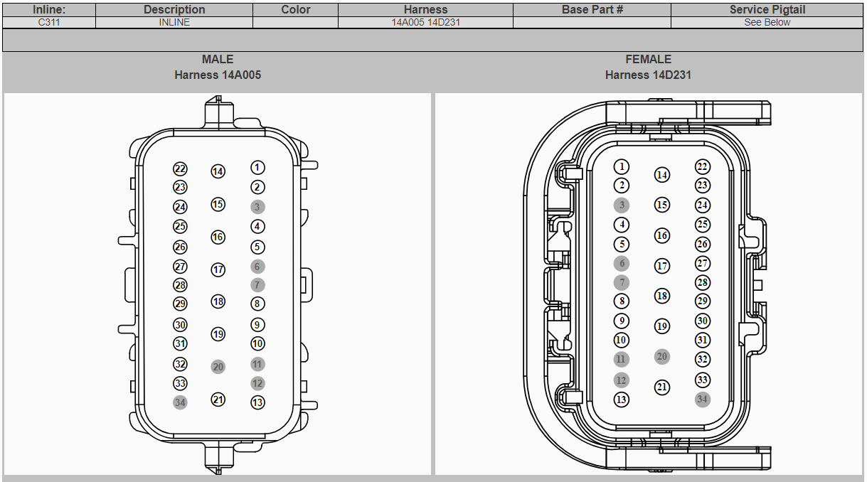

Here is the connector under the seat that you should have.

Look under the driver seat for that connector I posted earlier and check if the all the wires are present, in the picture shaded pins mean no wire in that spot.
The reason it would be electrically simple to add just a power seat is the plug is already there and everything for the seat is contained in the seat assemble itself - adjustment switch, seat track, motors, sensors, airbag, seatbelt.

Go check if you have that connector with all those wires, if you do then it's just plug and play for a power seat.
You may have to add the fuses for a power seat though, Ford likely didn't install the power seat fuses since the vehicle wouldn't need them.

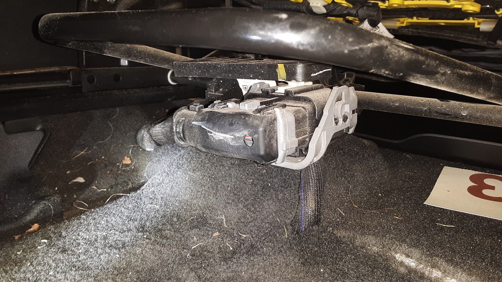

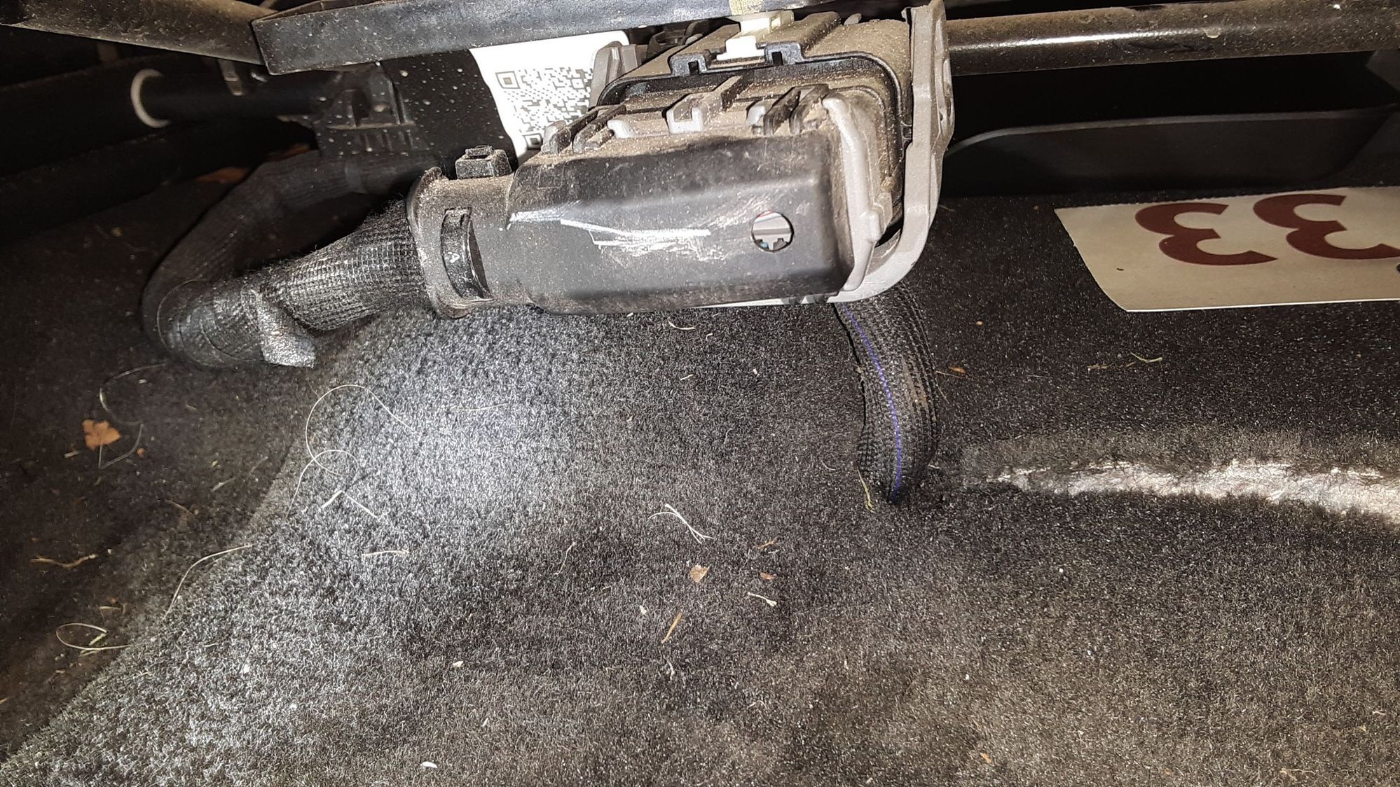

Default Wiring under my seat
Old Jan 23, 2021 | 01:26 PM
bigbass's Avatar
Joined: Nov 2020
Posts: 14
From: upstate NY
Hey sir, any idea what wiring this is? I hope its not just for the air bag....I sooo need an electric seat
Old Jan 23, 2021 | 04:33 PM
scott.butler4's Avatar
Joined: Apr 2020
Posts: 1,077
Thsts the correct connector, be best if you could disconnect it and make sure all the wires are there, look at my previous post for connector face, there is a 99.9% chance all wires are there on vehicle side of harness
Have you found a donor power seat yet?
