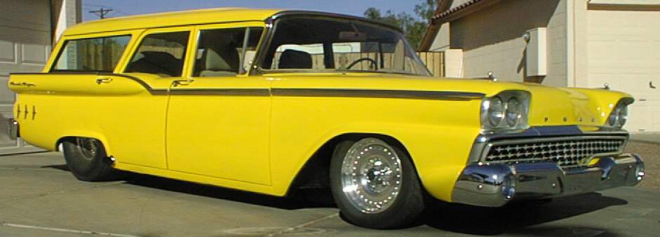

Here are a few pics of the car and motor. All built at home in my garage.
Attached Thumbnails New here, Need 460 oil pressure info???-59-rt-front2.jpg   New here, Need 460 oil pressure info???-dist004.jpg
