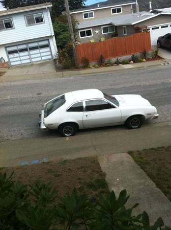

Attached Thumbnails 1977 Ford Pinto, my 1st car from the 70s - seems to be all-original . . help-00d0d_3hjsd7vy90c_600x450.jpg   1977 Ford Pinto, my 1st car from the 70s - seems to be all-original . . help-00v0v_cg9z1jjherg_600x450.jpg   1977 Ford Pinto, my 1st car from the 70s - seems to be all-original . . help-00c0c_be1gulx19wx_600x450.jpg

Your neighborhood looks familiar. I used to live in Daly City. My GP's lived in SF..

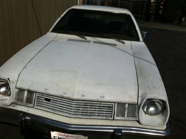

Car doesn't look too bad from here

That's outside my friend's place over along that way south of the city.
