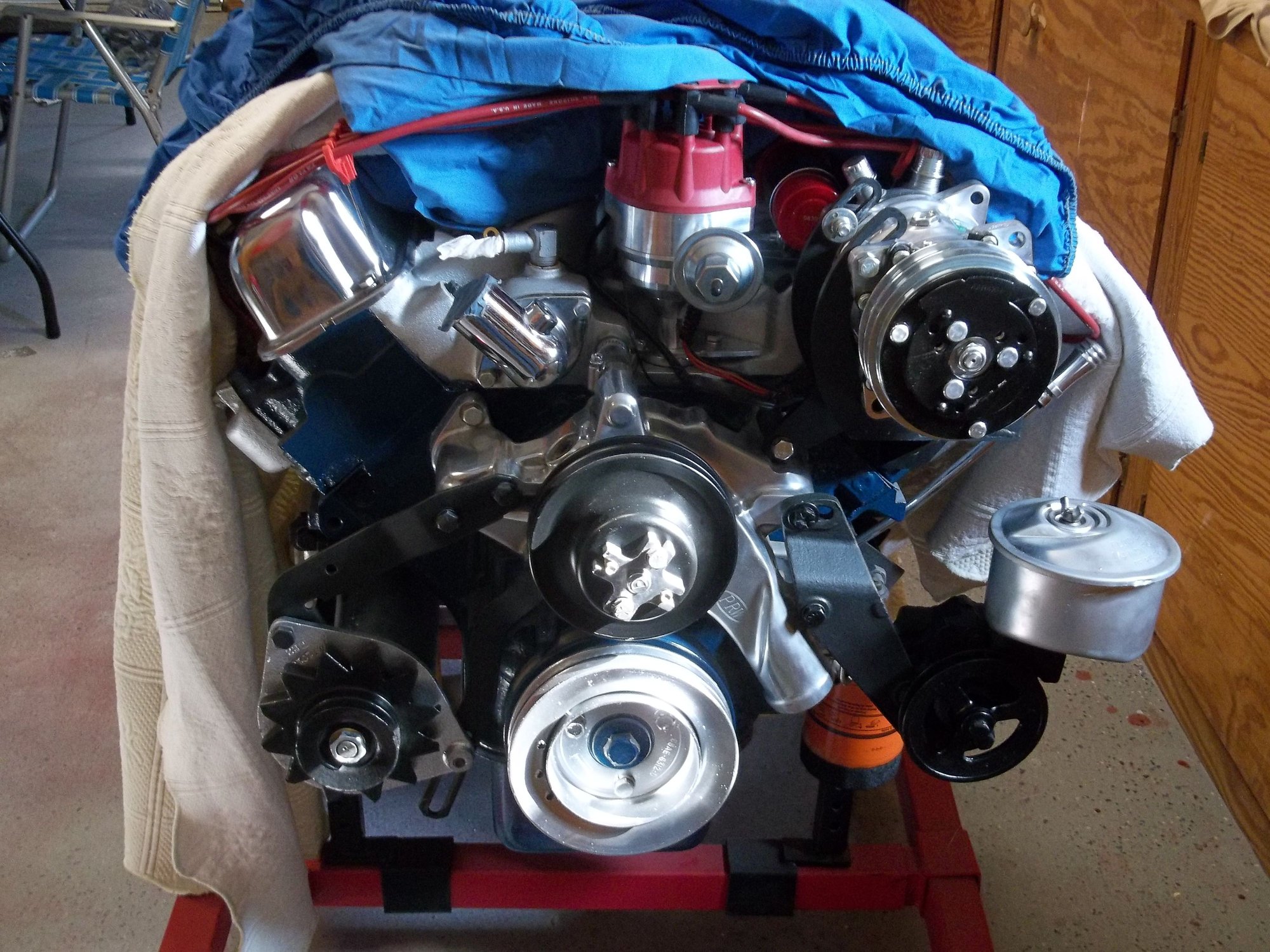

Default Motor
Picture of motor. Belt runs from crank to a/c up to a/c back to WP to crank. reservoir is in the way. Need to find someone that has a 59 that can show me how they did this.
