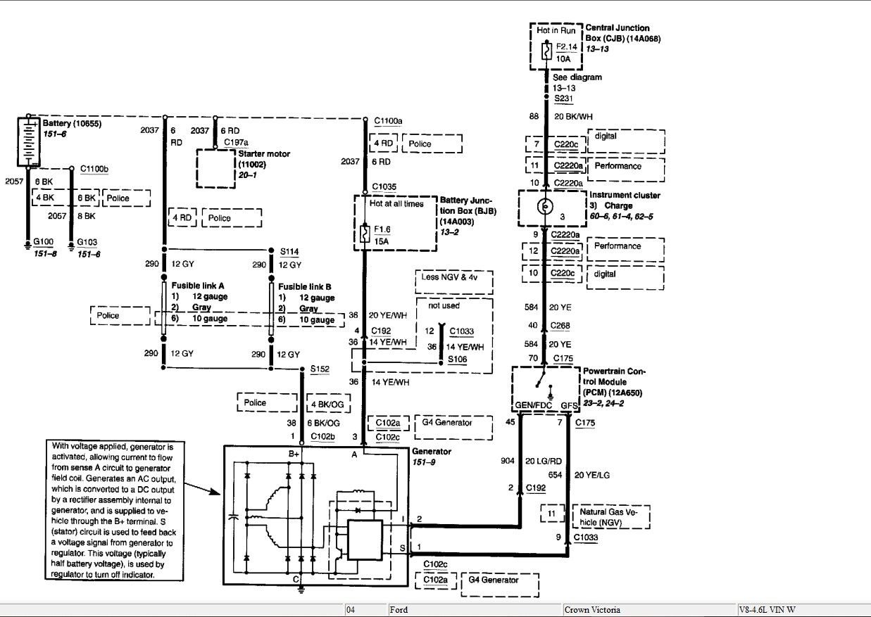

Hello. Recently, my car started overcharging like crazy (17-19v), so I replaced the alternator (totalpro brand 135amp) since my battery tested just fine. After replacing, it still overcharged, so I figured it was the pcm. I ordered and installed the new pcm (flagship1) and got my keys reprogrammed perfectly. After this, it is still over charging. I double checked the visible wires and then went back to the alternator wiring. I doesn't overcharge when lg/rd (generator field control output) and ye/wh (voltage supplied at all times) are connected to the harness, but goes crazy again overcharging when I hook ye/lg (generator field signal monitor) up. It runs perfectly fine when I have just those 2 wires connected to the alternator and pcm. Any ideas? I'll include the diagrams below. Is there any chance I've got the wires mixed up or maybe something is wrong with my newly programmed pcm? Not sure, thanks for any help.
this is what my old alternator had for the wires.
this is what the new alternator had that I spliced.

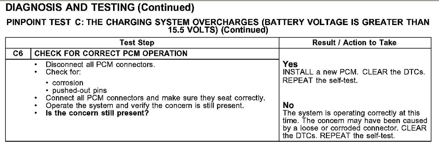

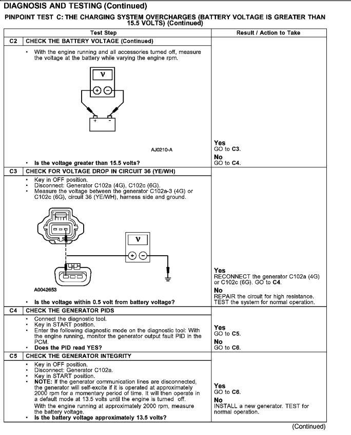

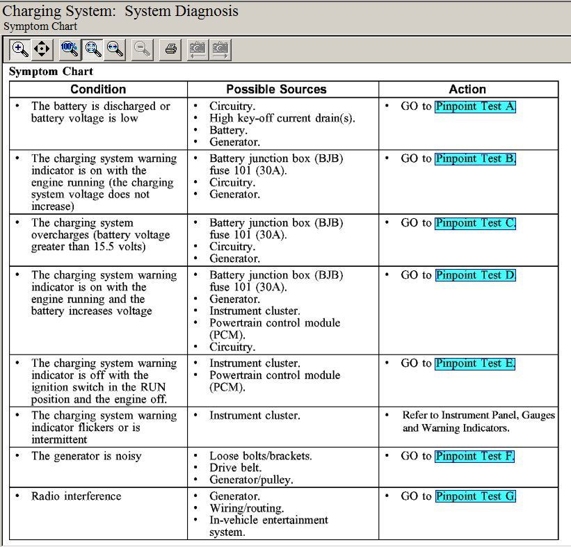

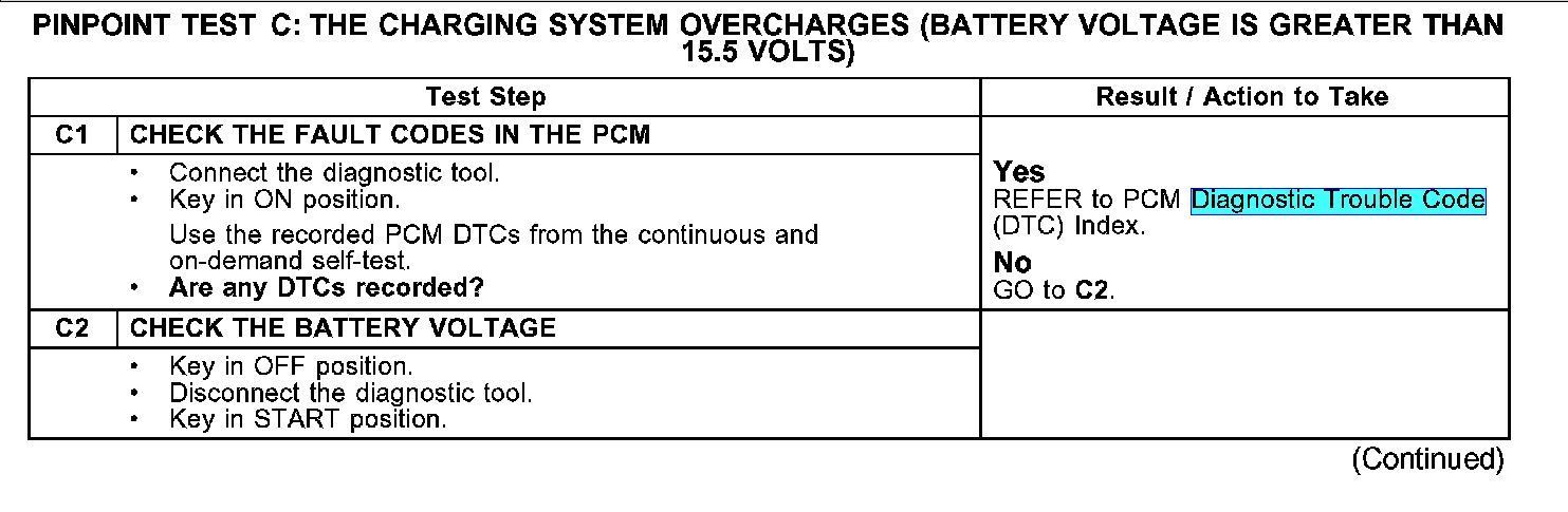

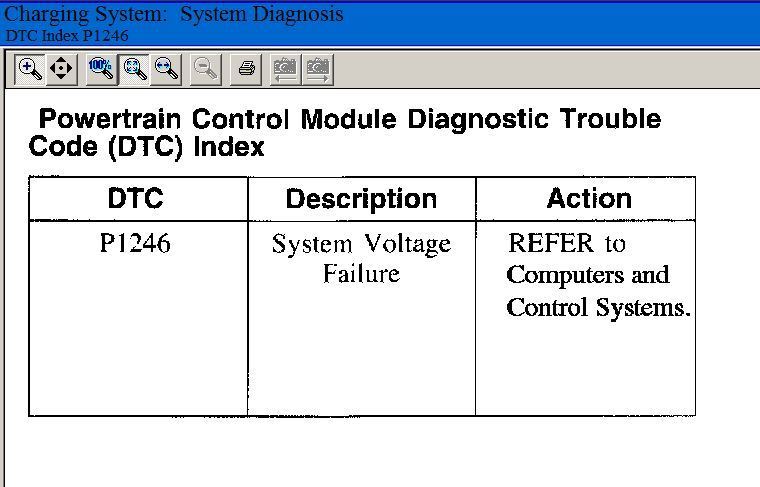

Even if you don't get P1246 check Test-HY.pdf below. Pinpoint C shown above, if you need to see others check Pinpoint-ALL.pdf below.
You said you switched to totalpro brand 135amp, how do you know it's made for 6G and not 4G? They are not interchangeable when you switched from 4G to 6G. You said you installed and programmed a new PCM are you sure it can communicate with 6G alternator? If so, then your totalpro is probably made for 4G. You said you spliced and converted the C102A (4G) to C102C (6G), how do you know the splicing are good and why didn't you buy the 4G to 6G conversion harness or just depin the 4G and switch that to a 6G connector? From what I see thus far, doesn't matter you have 4G or 6G, your totalpro just can't communicate with your PCM causing the overcharging.

Above diagram shows a 2005 that came with a 6G alternator you can compare with your 2004's 4G.
One more thing, you have digital or analog instrument cluster and how do you know it was overcharging? Did you see light show on the cluster? Red battery indicator turned on too? Next time you see it's overcharging can you pop the hood and check your battery voltage with a voltmeter and verify?
