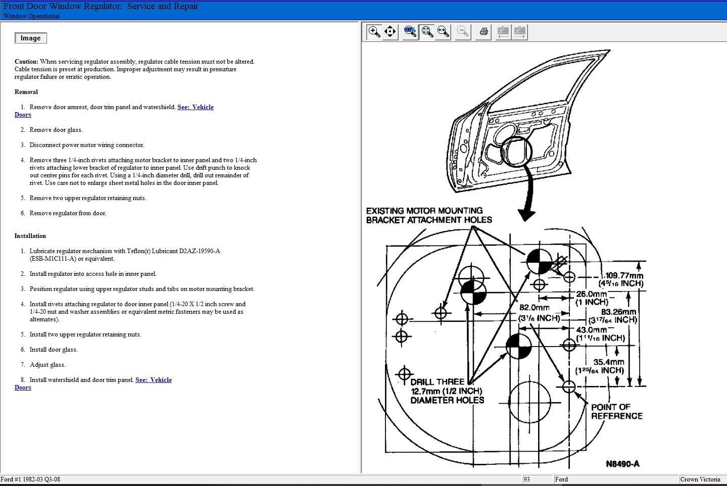

If you can't read clearly, double click or download the jpg image to view original readable size.
Cardone is a good brand for window motor, so check: Cardone 82382.
