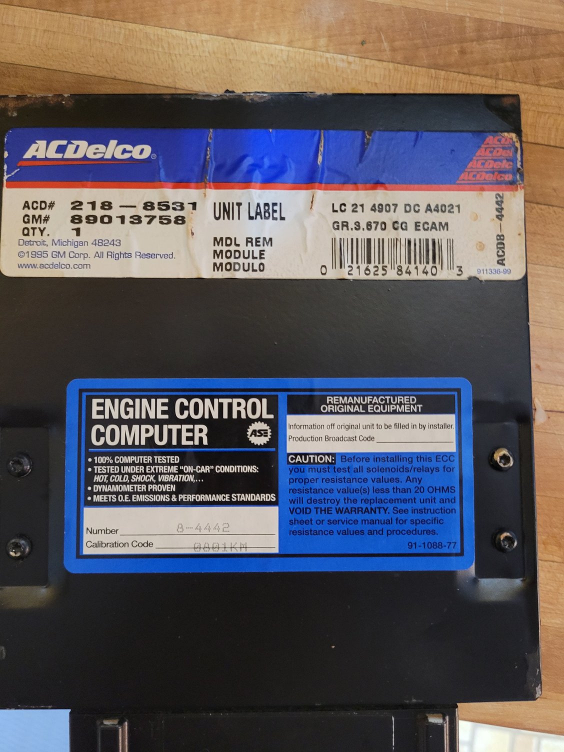

I'm thinking about getting a new ECM at this point, but the current one is an AC Delco remanufactured unit and not original. It has been impossible to get any ECM seller to guarantee fitment without the original ford part number.

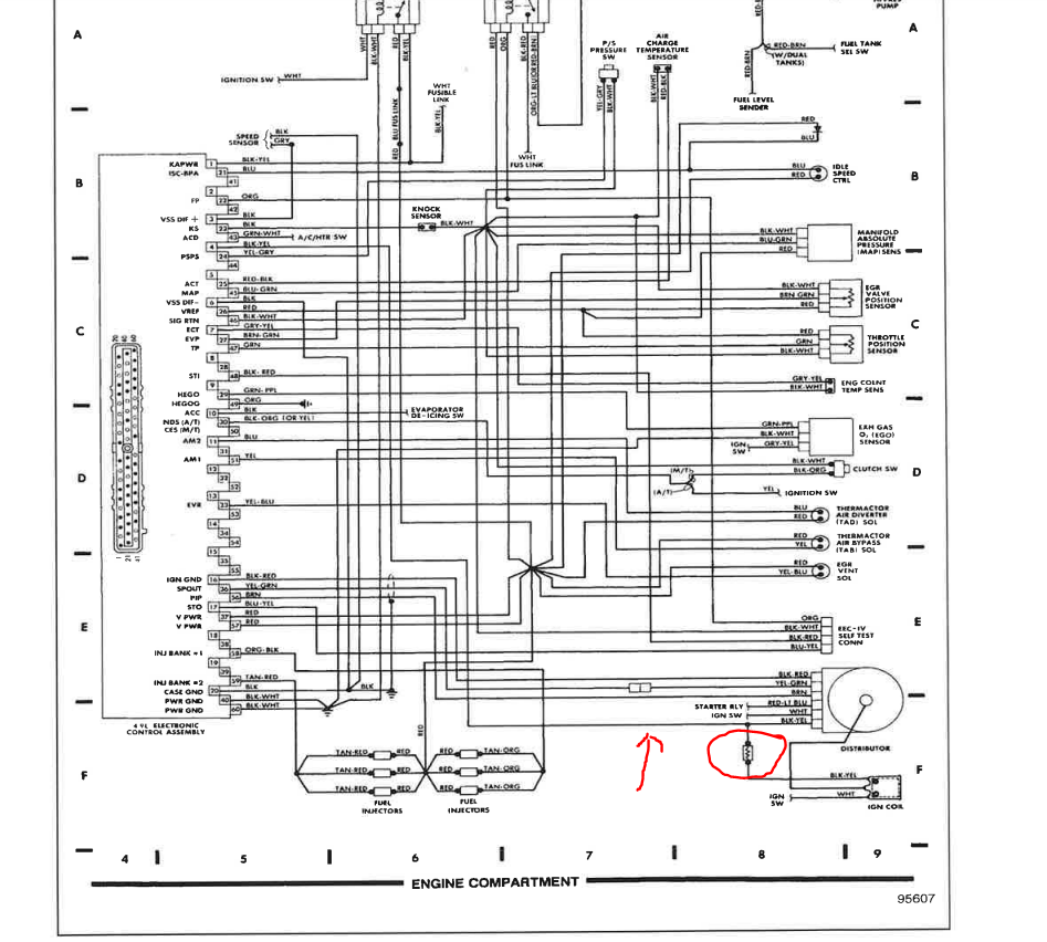

I used a noid light tester as well and they do not light up when cranking the starter. I tested this at the injector plugs and the ECM's 60 pin output using a wiring diagram I obtained from Shop Key Pro, which is supposed to be specific to my VIN number. However, I have noticed that some wire colors do not match what it says they will be on the wiring diagram.
I am wondering what items connect to the ECM to tell it when to send ground to the injectors, on this van specifically. When does it know when to pulse which injectors and what items could prompt the ECM to not pulse the injectors?

Got a new ECM and now when I turn the key to the on position, you can hear the fuel pump kick on for only a couple of seconds instead of running non-stop. The noid light tester confirms signal is now reaching the injectors, unfortunately, it still cranks but wont start. Ahhh!
I checked for spark with a spark plug grounded and there is now no spark reaching the spark plug. I'm not sure if I should start testing backwards for spark or plug the old ecm and see if I get spark.

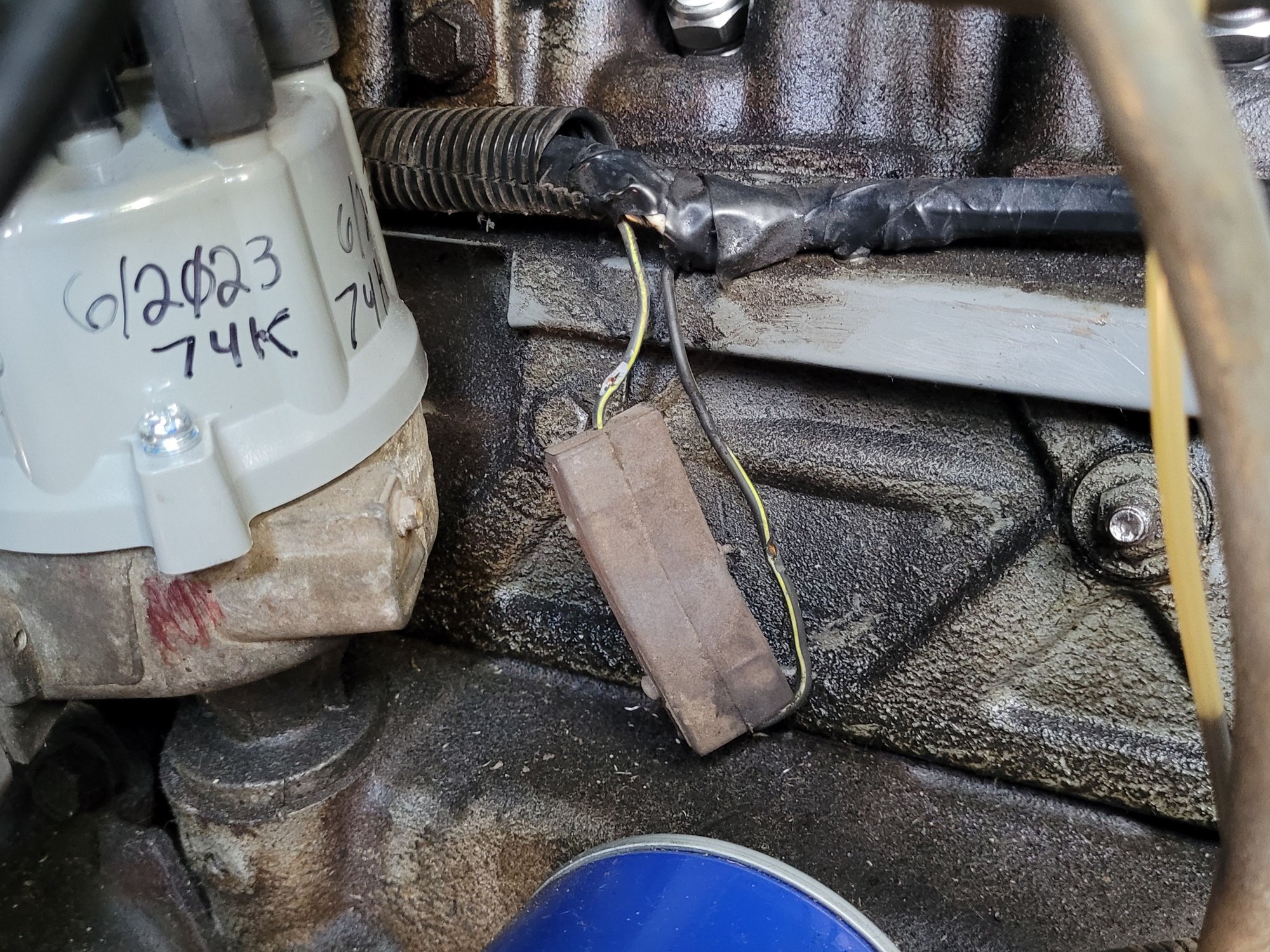

I found a fusible link that is bad between the coil, distributor, and ECM. The diagram shows the fuse slightly different from reality. In reality the fuse is where my arrow is in the pic.
I'm concerned that whatever caused this fuse to blow will burn up the ECM if I simply replace it with another fuse. Should I just replace it anyways and see what happens? It is a inline fusible link (popular in the 80's I guess) and it is located right next to the engine a few inches down from the spark plugs.

Okay turns out this is a resistor, not a fuse. I'm not sure if it's bad or not but it's probably fine.
