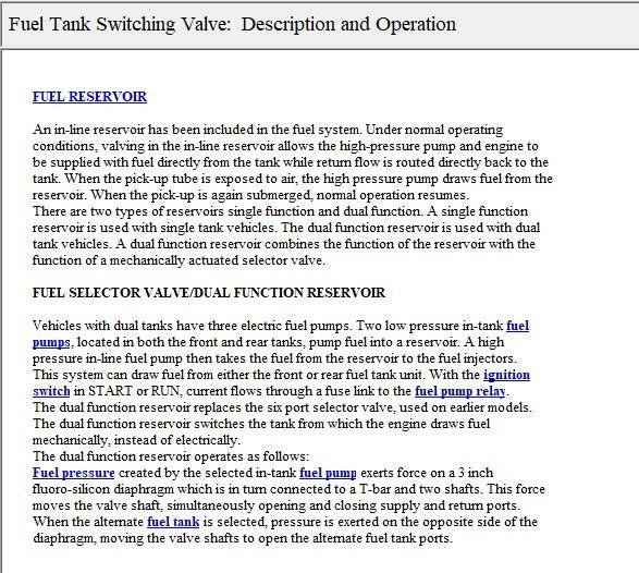

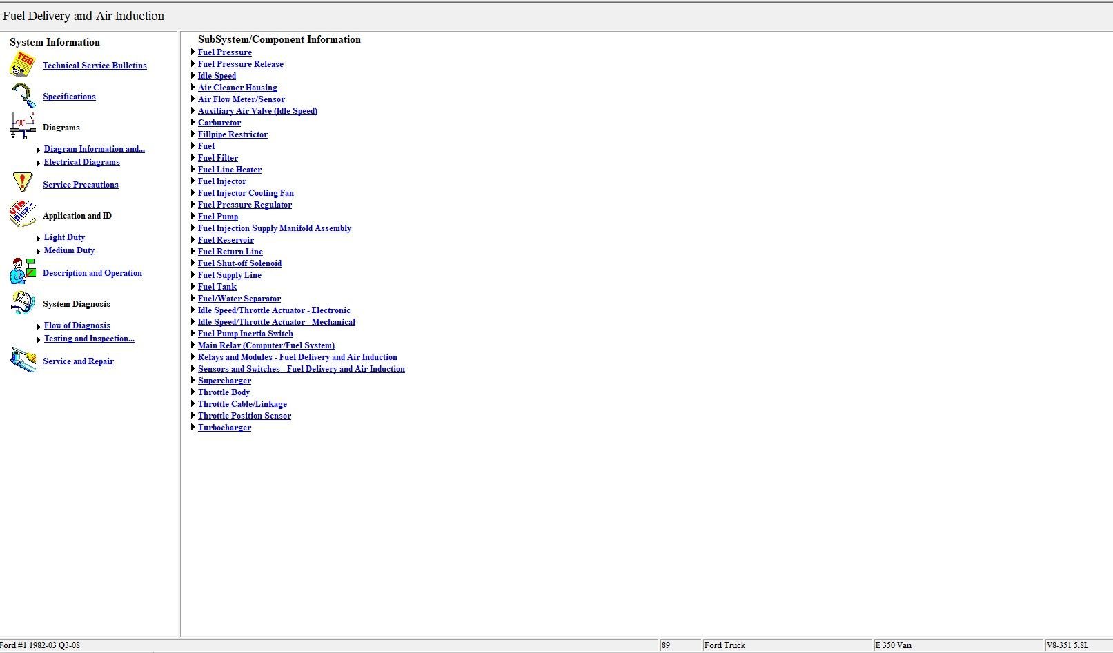

Check the index page below, let me know which particular component/section you want to take a look at.
Find below a pdf under "fuel tank" component.

The index is very blurry but can you look up what the pressure should be from those low pressure fuel pumps? Is that a program you have or a website you are looking at?
Old Oct 1, 2024 | 03:44 PM
It's not from a website but my alldata software for any car make/model 1966 to 2008.
