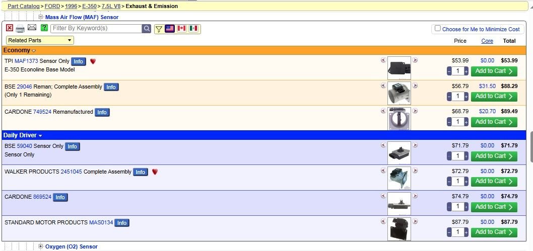

Old May 27, 2025 | 12:32 PM
Posts: 1,229
RockAuto above, red heart means popular so get Walker brand above.
Use 300461263265671655 coupon code (expires 6/6/25)

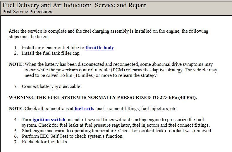

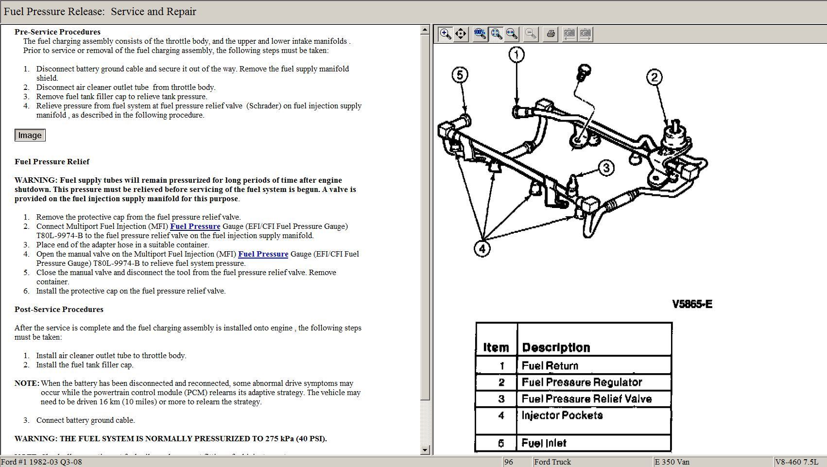

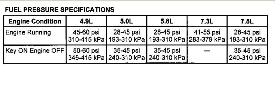

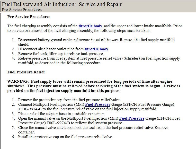

Old Jun 13, 2025 | 09:56 PM
Posts: 1,229
