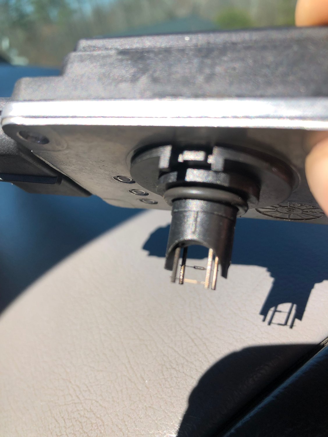

Well I finally figured it out! I tested the back pressure with a back pressure gauge in the O2 sensor port before the catalytic converter, this was reading normal while hot, so that’s not the issue, so thinking about what hanky said I looked at intake, the air filter was new already, but I’ve yet to look at or change the MAF, I figured if it was the MAF a code would have been set? I’ve gotten no codes this entire time, I pulled the MAF, the first probe looks just slightly dusty, but the second probe is like completely black, to me maybe some kind of oil got on it then got burnt from heating up? I know the previous owner said he had to spray starter fluid just to get the engine started previously, possibly the oils from starter fluid? I’m not sure, I’ll post a picture. Swapped the MAF with a new one, I’ve drove it 27 miles and no issue, drove it 55mph up hills no hesitation/stalling/slipping. Hopefully this thread may help someone in the future… check your MAF! Even if there’s no codes…it could still be the MAF. I hate that I swapped out a good reman transmission but it was leaking in two spots (one was the fluid pump seal so it would have to be pulled anyways) so it was good I no longer have one that’s leaking. But all is well.

Well it drove great for a month, then issues came right back, weird? Engine stalls/ bucks under load. I thought the new MAF sensor fixed the issue, because everything stopped after replacing it and been driving it for a month no issues until it just started again today, I tried changing the TPS with old one, that didn’t help, unplugged the MAF, that didn’t help, unplugged the vacuum on the fuel regulator and that helped some? Able to go to about 50MPH under some load, still have issue, going to check fuel pressure, I understand the fuel filter and fuel pump is new from previous owner but maybe faulty cheap pump? Engine stalling like I’m having under load makes me think it’s fuel related, since new plugs and refurb injectors.. thinking delivery is issue, catalytic converter is not issue

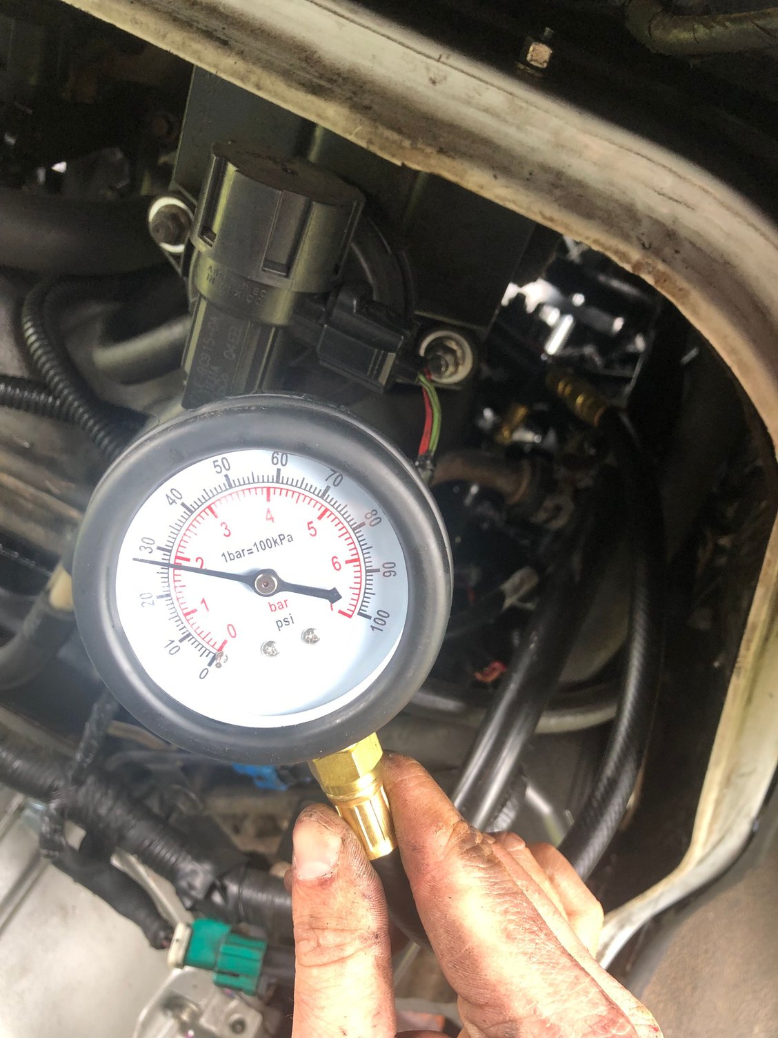

Well my fuel pressure is measuring 28 psi at cold idle, I believe I might know why the van worked for awhile, I had been keeping the fuel tank full and I just let it get below half a tank when the issues started, maybe that let the fuel issue show itself with less gas in the tank to cool the pump, it could have been a coincidence when i changed the MAF sensor i had filled the gas too before the issues started, I didn’t really want to drop the gas tank and I found on YouTube people figured out how to locate the fuel pump from inside and cut an access panel for it. The previous owner told me the fuel pump and filter had been changed when I bought it…the filter looks new but I’m not too sure about the fuel pump yet until I open it up. It could possibly be just a cheap fuel pump going out fast. I never had issues with cranking, only issues under load, possibly just a weak pump, I’m going to replace the fuel pump and fuel filter with both motorcraft brand, will keep updated

What does the pressure show when you increase engine speed to around approx. 2500 RPM ?
