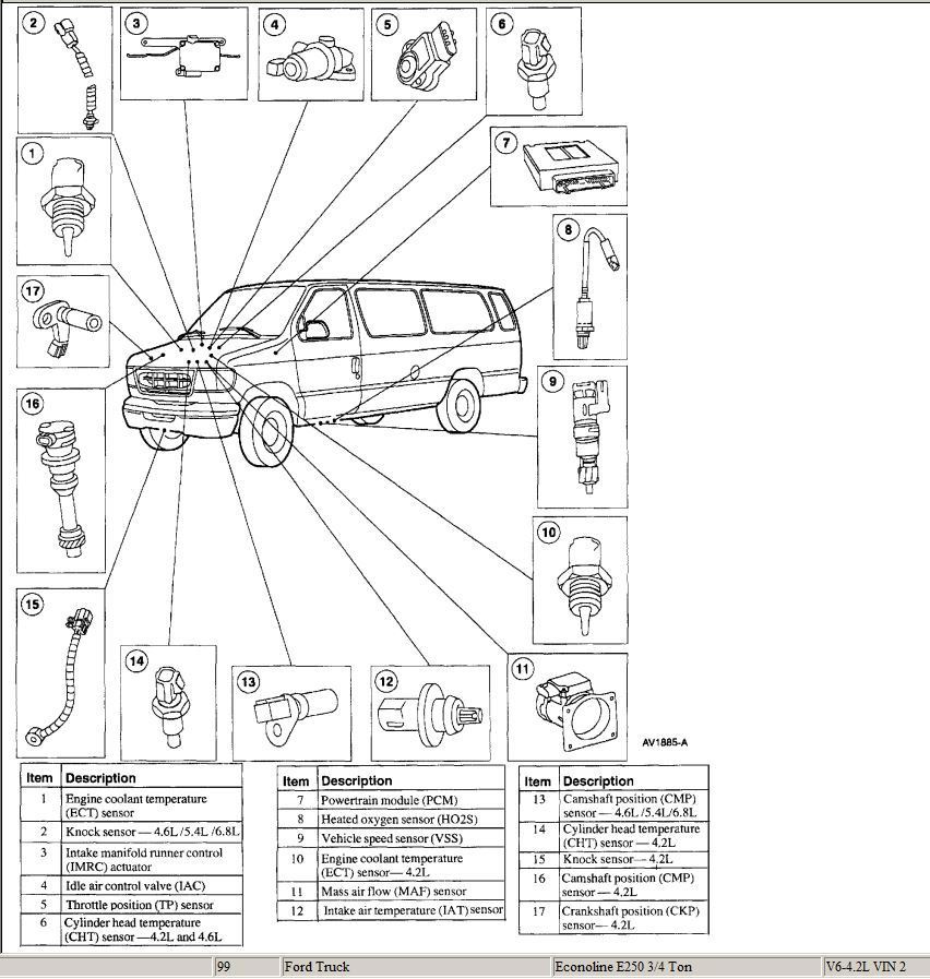

As you can see above, engine size matters and 4.2L is not no.1 but no.10 above.

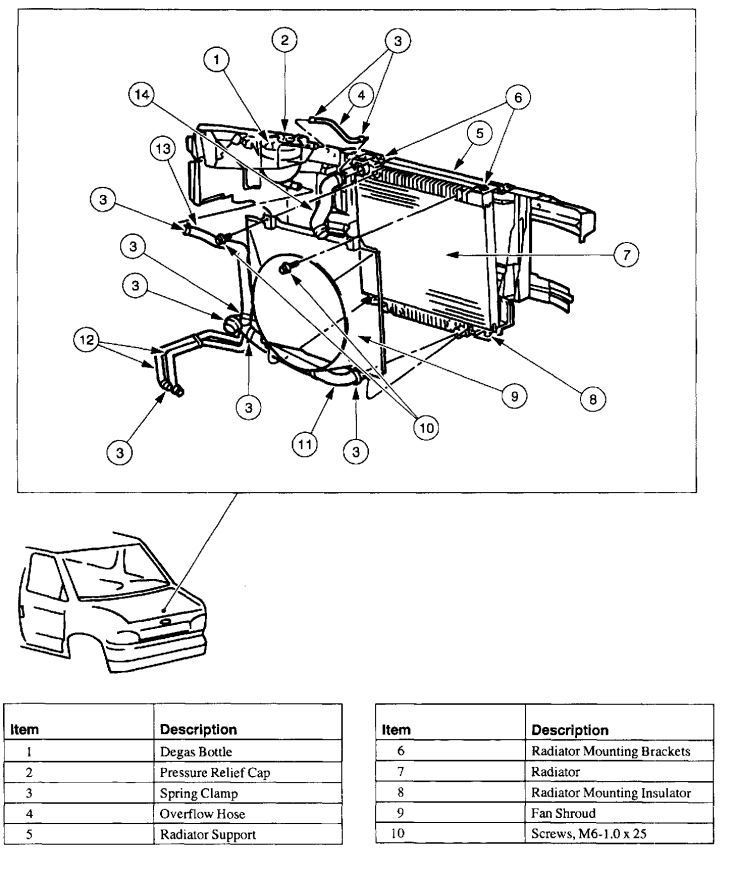

Below is the one for the gauge.

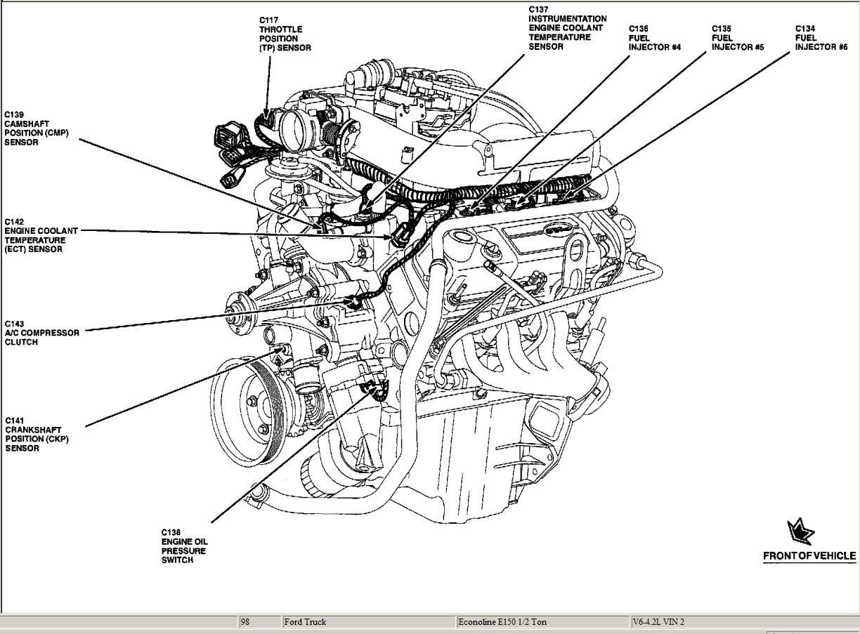

Find below #14 (for gauge), #15 (for pcm):
Below is the zoom out view where C137 (for gauge), C142 = ECT (for pcm)
(for 1998 e150 4.2L, I can't locate any good diagram from your 99 e250 4.2L but location wise they are the same)
As I mentioned previously your best scenario is issue with your sensor(s), just clean the electrical connectors on both sensors and inspect the wiring, but more than likely it's your thermostat that's going out. Why?
Because of the LIMP mode. Your PCM received the signal from C142 (ECT), you, at the same time, saw C137 (for gauge) the quick rise of temperature. For both sensors to go bad at the same time, the chance is almost next to zero. Anyway, just clean them, warm up and take short trip only.

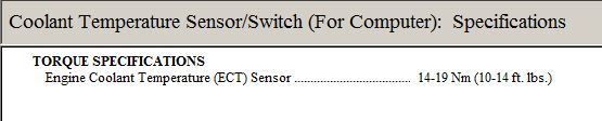

Also, why not replacing the ECT sensor? 70% of the time it's the issue of the connector, the wiring, the sensor itself has a long lifespan perhaps as long as lifetime of your van. If you think you want to replace it, go ahead it's dirt cheap anyway. But be expected during removal some coolant is going to spill out and get ready to catch those with a towel. Below is the torque spec if you decide to replace it. Same spec for C137.
