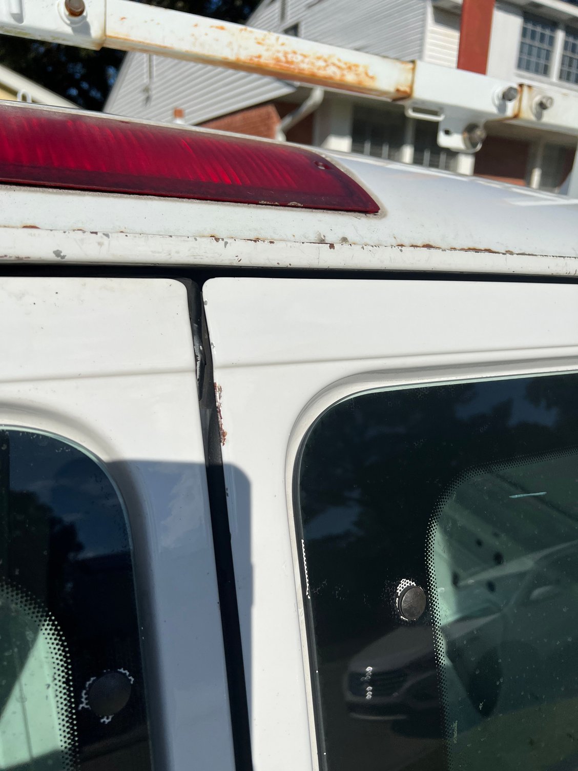

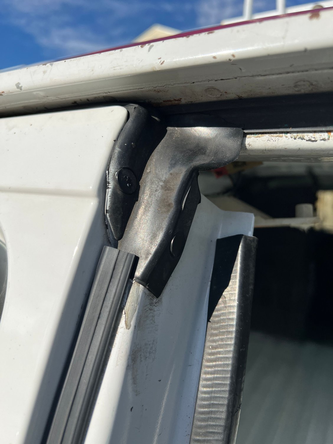

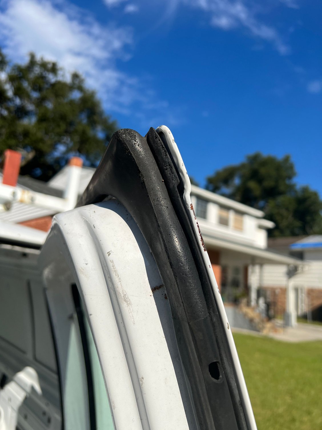

Just got this van. Rear doors are leaking at the top where they meet. Not sure if it’s bent from someone prying on it since it looks like that could have happened or if the seal is just bad since I’m not sure what it’s supposed to look like. Any input is appreciated. Thanks.

From your pictures it doesn't look as if something was mechanically changed in which case you could have 2 alternatives.
Replace the weatherstripping or adjust the door hinges and the loops that the lock piece hooks on to.
There are loops on the top and bottom center of the door opening.

ok thanks. I tried searching but couldn’t find this issue specifically. Just wanted to make sure I wasn’t missing something obvious.
