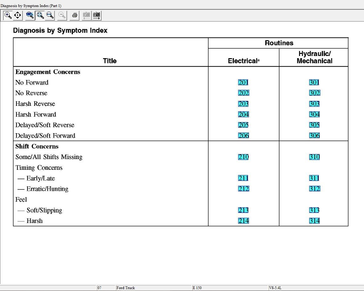

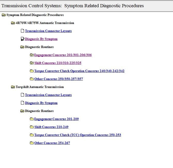

Old May 14, 2025 | 12:53 PM
4.6L or 5.4L is not specified so I randomly picked 5.4L. Check my signature below to see why.
