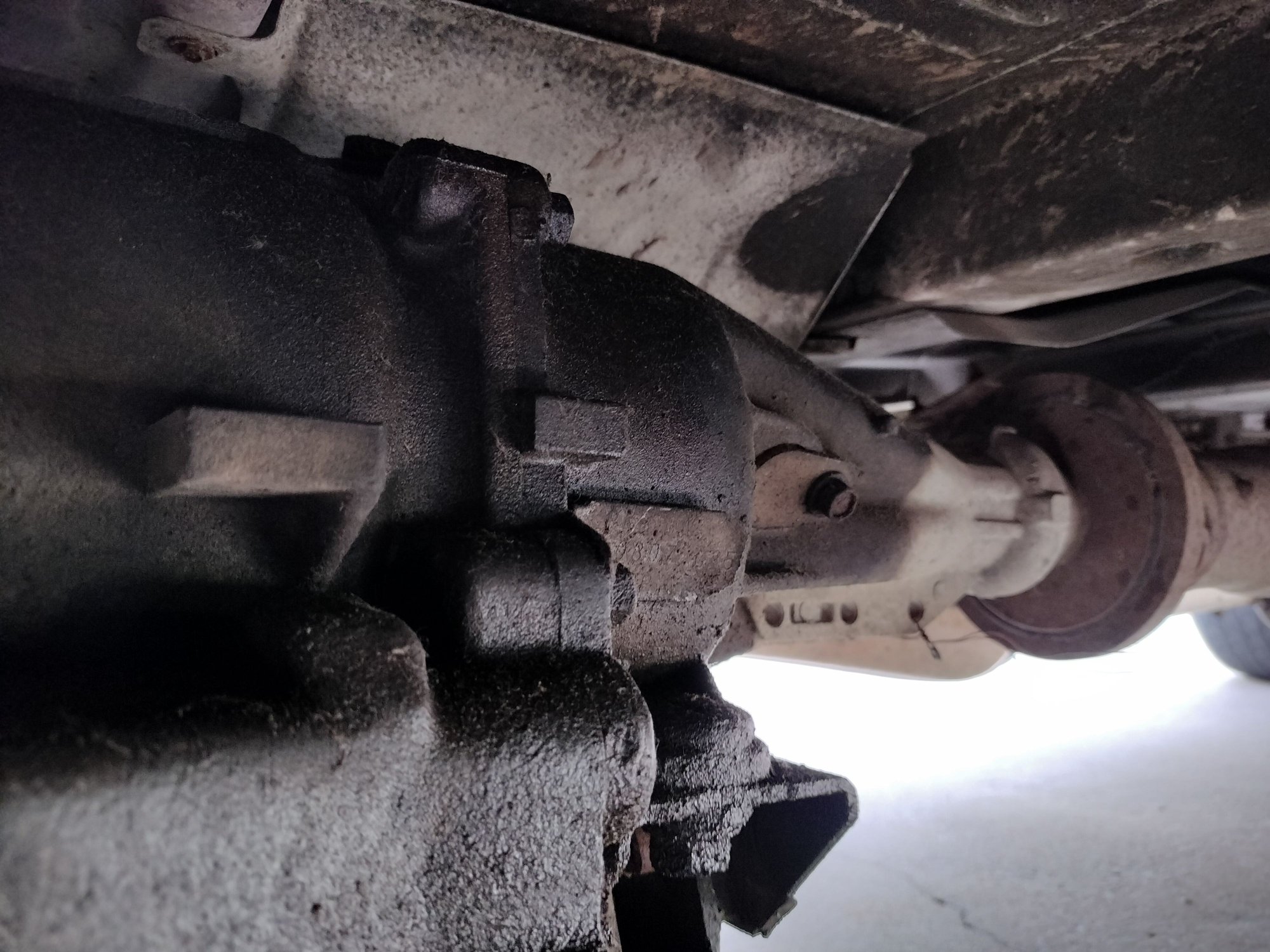

A week ago after camping started home and noticed the speedo wasn't working. I looked around to see what I could have in store for me and the speed sensor popped up a bunch of time. The service manual said I should have a sensor on the trans, 1992 E150 5.0 motor, but there isn't one there. I have the sensor in the rear diff and is part of the ABS. I went ahead and swapped out the VSS in the rear end since it was easy and the original was still there. This didn't work so I am looking into other things that can be causing this thing not to work. All other cluster gauges are working so it is just affecting the speedo and odometer. My cruise control stopped a while back and after this happened I read that a speedo issue could also cause this. I can still drive the van using an app for speed so it is not a total loss of use. I also noticed that I have been getting some hard shifts into and out of OD. I will keep looking into this and take any suggestions if anyone else has an idea.

Pretty sure the speedometer is driven by a cable from tail shaft of trans. If you disconnect the cable from the driver's side back of trans, you can rotate the inner cable and watch the speedo. If it works there is a problem with the part that is bolted , with one little bolt, to the trans. They are made of fiber and can strip out if there is a lot of resistance from a dry cable insert. You should have heard some noise if that cable insert was dry.

Thats the rub Hanky. On the tail piece of the trans is a bolt that is holding a blanking cover. Even the service manual said it should be there but it isn't. The only sensor is the one on the rear diff. Believe me I wish that I had the one on the trans and have looked all over hoping that it was broke off. I am going to pull my cluster out and see if there is a cable attached but I think it has the PSOM and an electric speedo and odometer.
