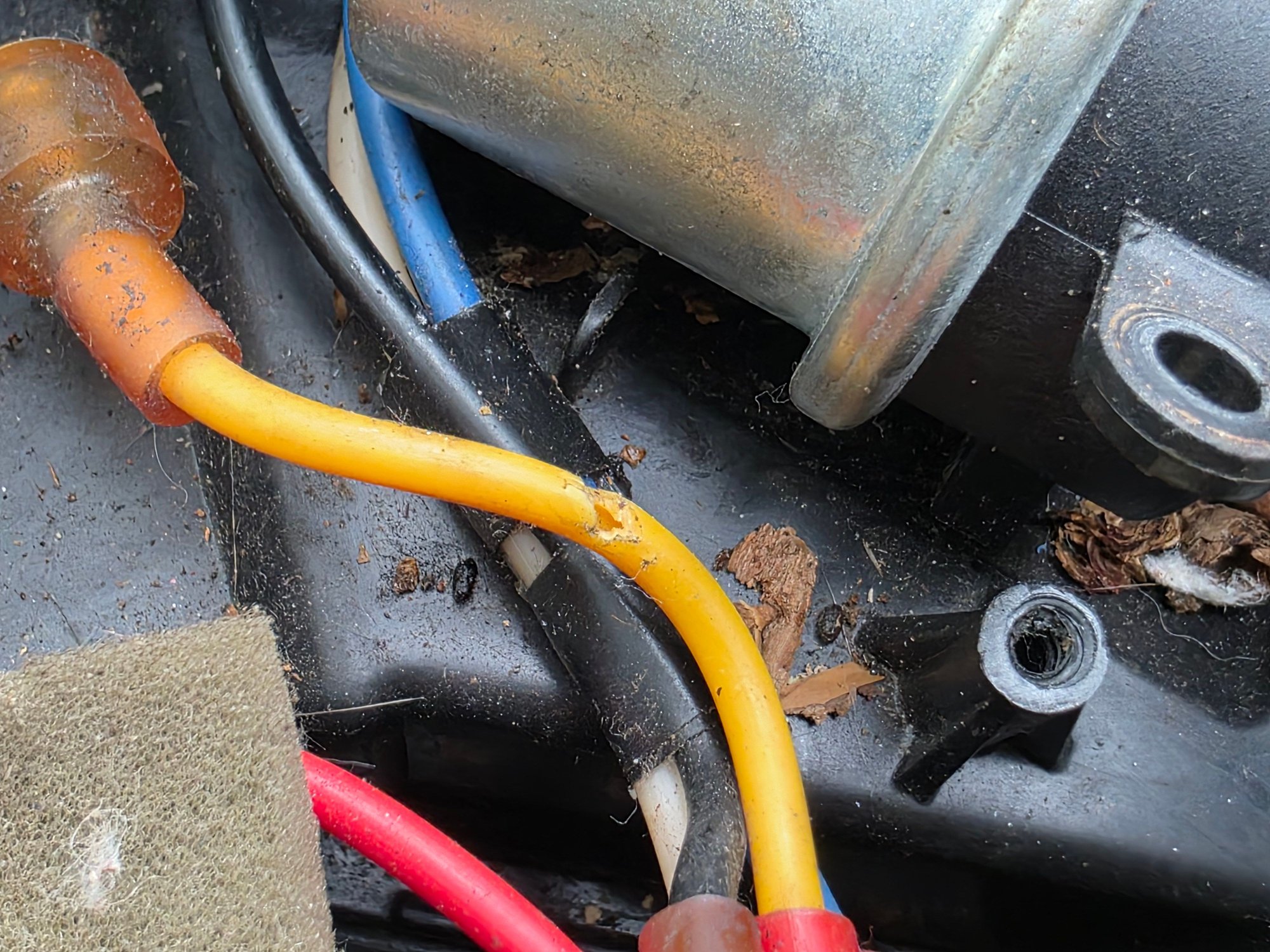

Center of my dash this panel gives you access to vacuum lines. Mouse  chewed hole in on line everything stop working. Oriellys has vaccum line repair kits.
