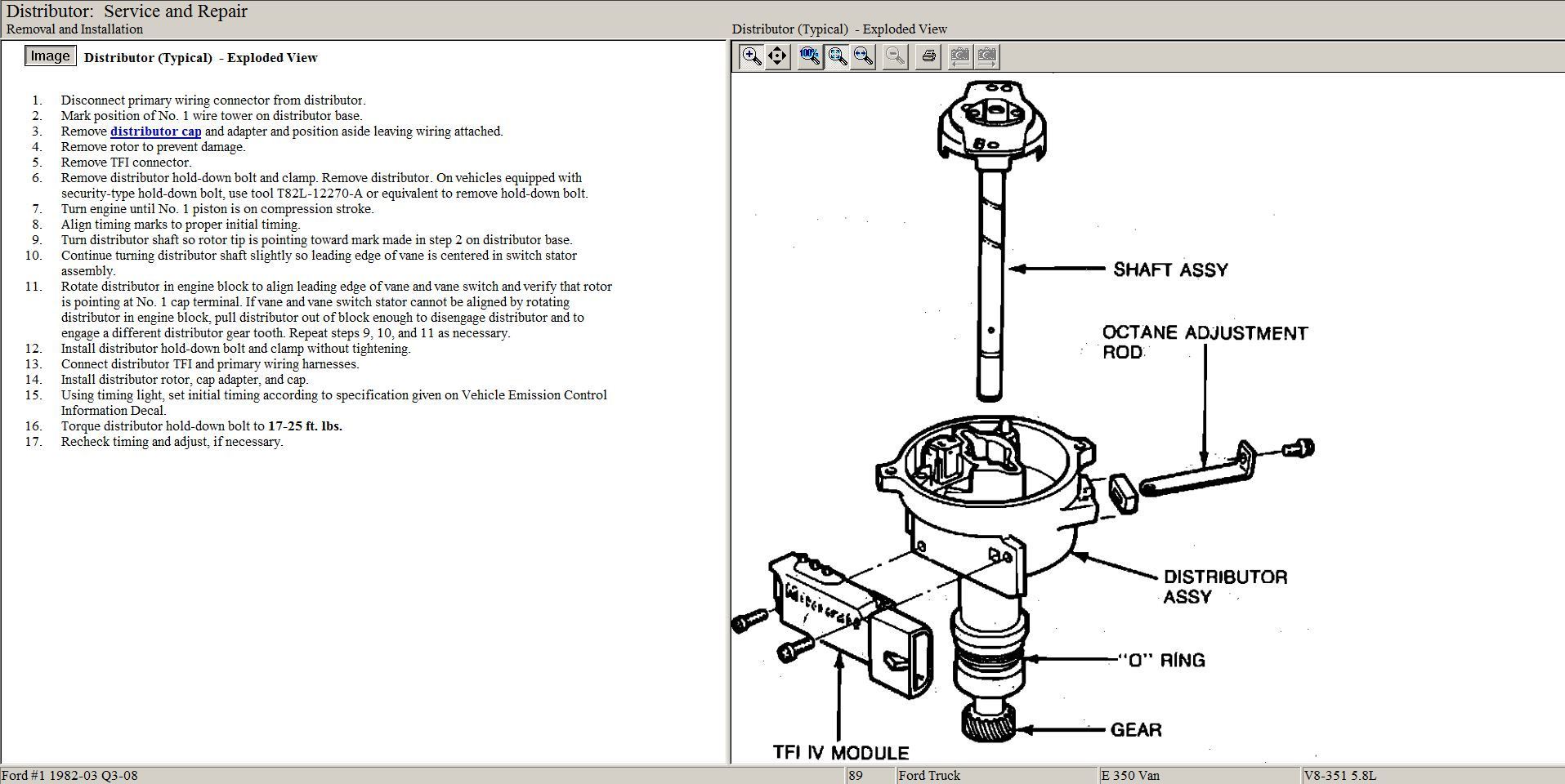

At this point we don't know just where the problem lies, sooooo, lets eliminate some possibilities.
To do this correctly, you will need to remove the #1 spark plug.
What we want to do is line up the TDC mark on the crank pulley with the pointer on the timing chain cover. When you feel pressure coming out of the spark plug hole it is coming up on the compression stroke and that is when we go slowly and line up the timing mark TDC. If you pass it , no going back, go around again.
When you have the mark lined up the dist rotor should be pointing to the #1 spark plug wire tower on the dist cap (first cyl on pass side of engine) Need to know, YES or NO .
That timing mark can line up at the wrong position, IT MUST BE ON THE COMPRESSION STROKE.
