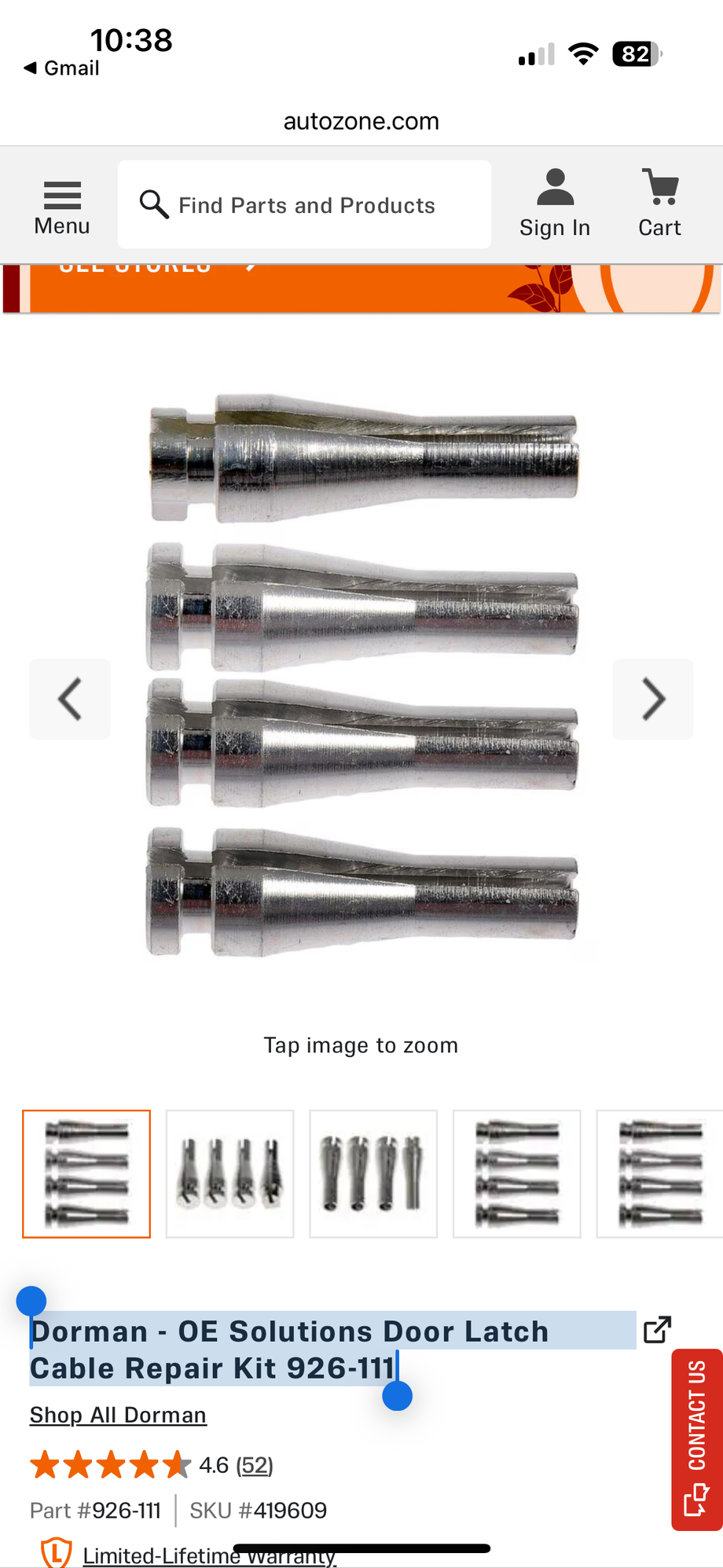

Thanks for the reply! Dorman part number 926-111
i am away from the van currently, but I’ll go mess with it this evening and get some pictures at that time
i I am pretty sure the door latch will need to be removed in order to get the cables out and reinstalled with the new ends (pictured). Hopefully I am wrong to think that, (I’ve been wrong several times in my life) but I don’t see any way to remove those cables any other way

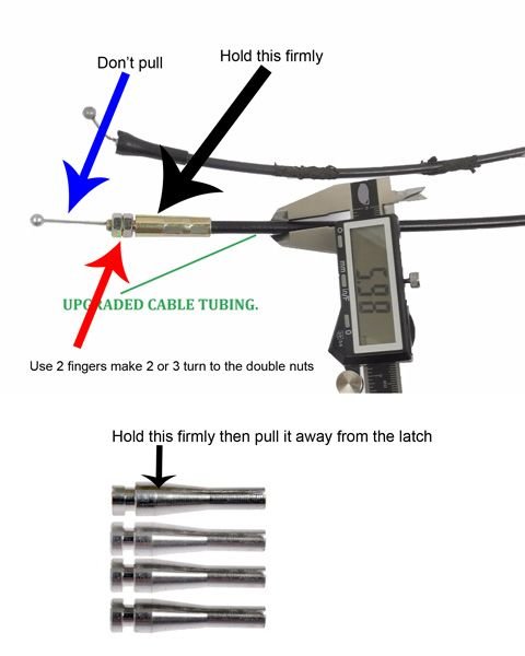

For the side you should get the whole cable like this: https://www.ebay.com/itm/392036075175 (more permanent fix then dorman replacing just the ends)
And to replace the cable you don't have to remove the latch, you have plenty of room to access it on the opening on the left side. If you remove the latch it may introduce another problem.
When you have power door lock there should be actuator underneath the latch, I want you to see when you push the unlock on the remote, can you see the actuator hook rod is pulling/pushing at all or not.
While doing all these grab a spray can of WD-40 Specialist Dry Lube if possible, you use this for lubrication.
Have a look at this: https://www.ebay.com/itm/224489853987 this is the left side of the side door but mechanism wise same on right door, so you can see where to hook the cable end back to the latch side, you can see you don't need to remove the latch.

Yes replace the whole cable is the right approach for a permanent fix. When you replace only a dorman's metal ends you are still using the 20+ years old cable. Most importantly you don't have to worry about the length and its pulling force being too tight or too loose. Imagine if you have the latch and cable on the bench, I'm sure it takes only 2 seconds to attach it onto the latch.

My bad, I was just trying to say when doing it on the bench it takes 2 seconds, so when the latch stays intact, it still doesn't take 2 minutes to remove.
The dorman type above you can see a little slit (will eventually come loose by itself), that's how it stays on the latch. The whole cable type above with a double nut new design you turn to loosen the nuts to remove away from the latch. Your inner door has big enough opening on the left side you just need to remove the slit away from the latch, then the rod and the ball will come loose.

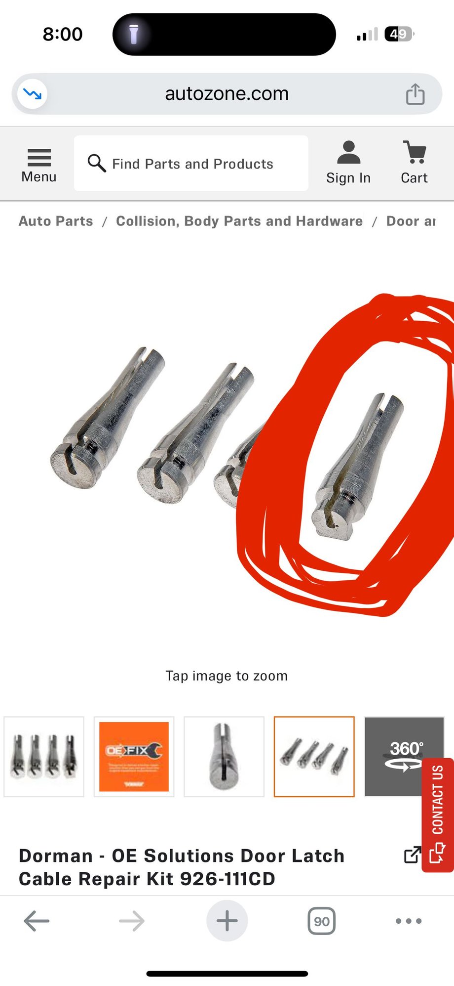

Okay guys I’m starting to see how this thing goes together. For starters, in addition to the cable ends being broken, the exterior door handle was also broken. For what it’s worth, I plugged the repair cable end (without the cable) to show what exactly I was struggling with when I started this project. What happened to is that there is one cable end in each pack that is squarish in shape (I posted a picture to show that). Apparently that one doesn’t seem to fit in the exterior door handle.
does anybody know which cable that squarish piece is supposed to go on as well as the handle side or the latch side? I know both of you guys recommended against that solution, but I already bought these so I figure I may as well try them out. I successfully installed these on the interior door handle and it seems to be working great. I used the round cable ends on both sides of that cable, so I really can’t figure out where that squarish piece is supposed to go. Maybe that squarish piece is a big part of the reason you guys are recommending against these!
