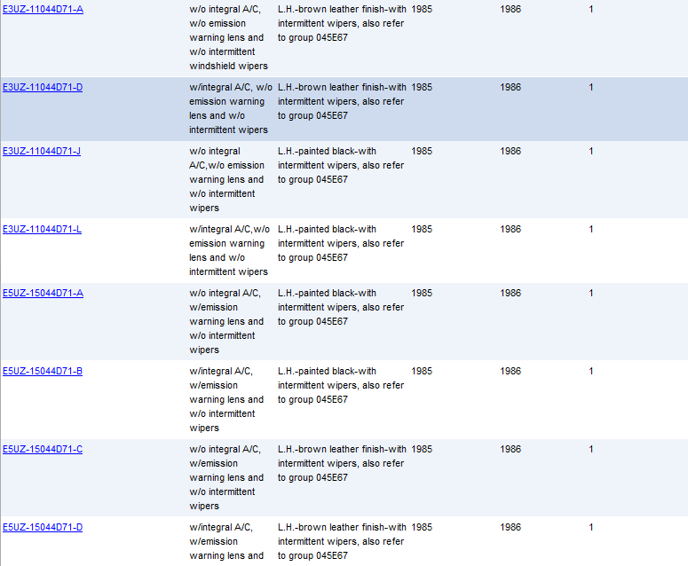

That takes me back to my childhood! The van looks really good for an '86! I would suggest checking eBay for that part... I have attached a list of old Ford part numbers for that item but they are all obsolete.

I love Vintage, they help me help customers so much. Unfortunately I ran the part numbers I posted previously and they have none of them. I also did a nationwide search to see if they were available anywhere and I had no luck with that either.
According to the Ford catalogue the same part from a 83-86 should work. There must be some design change after 86 that would require modification for other years with a similar part.

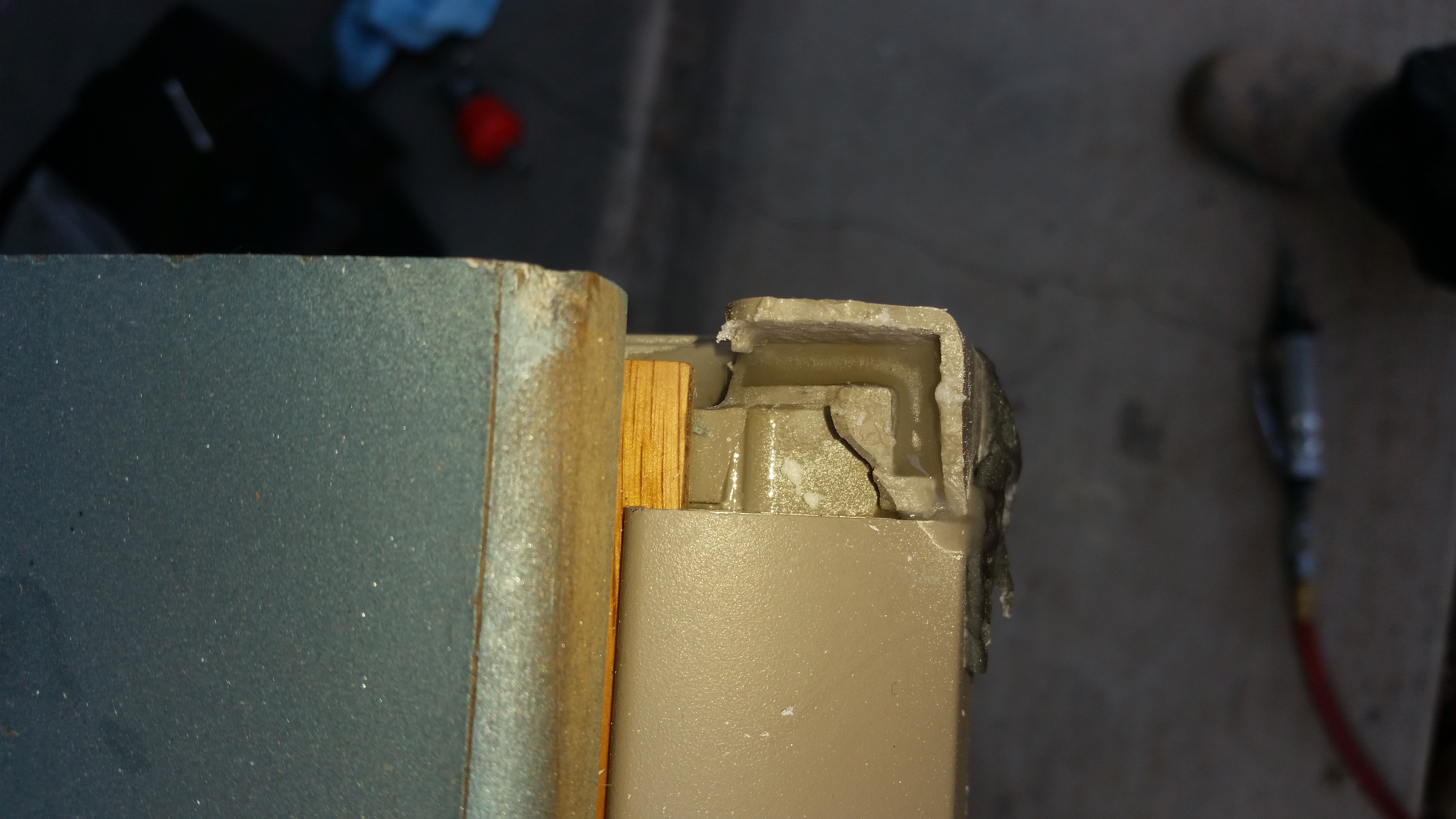

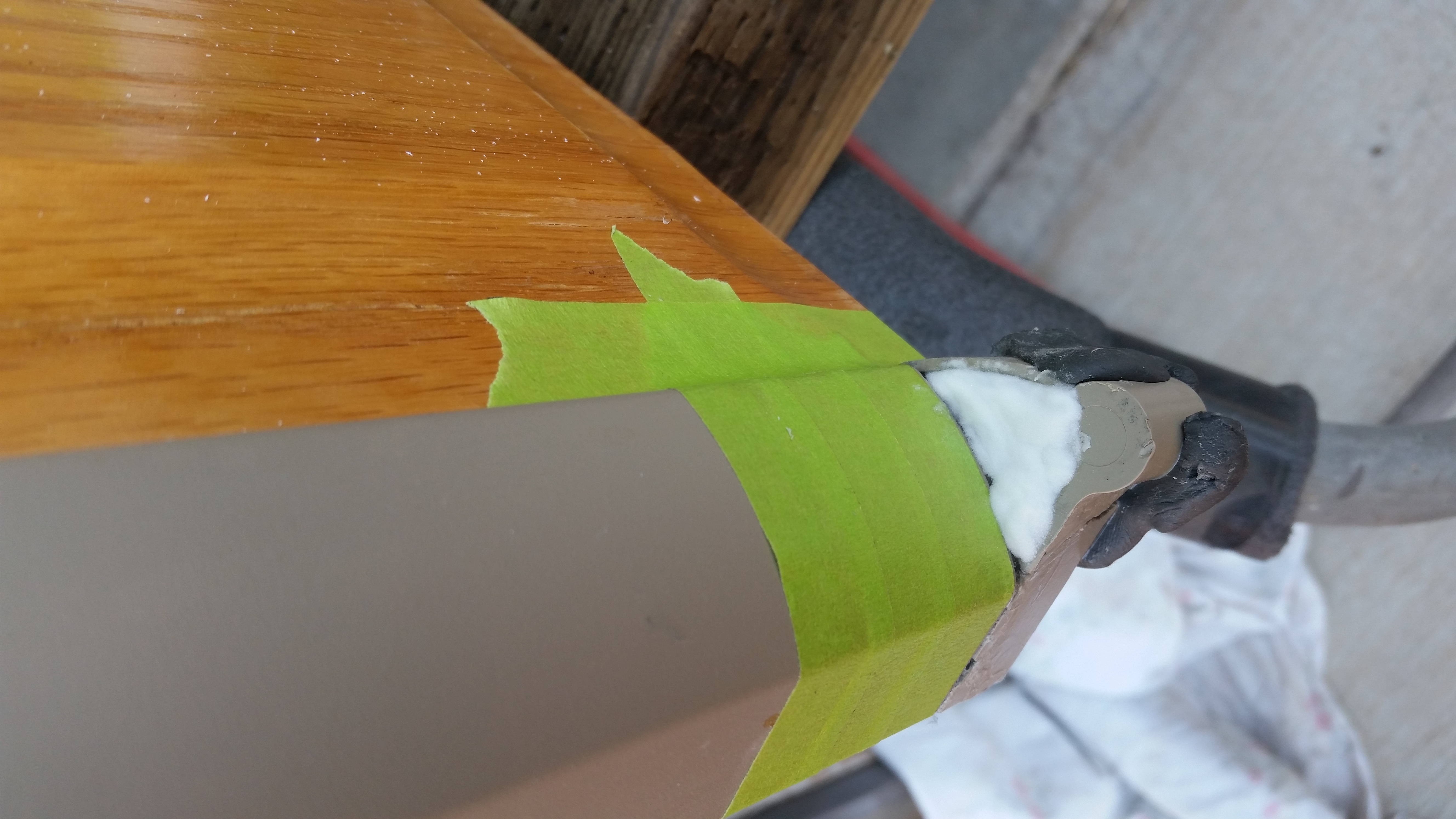

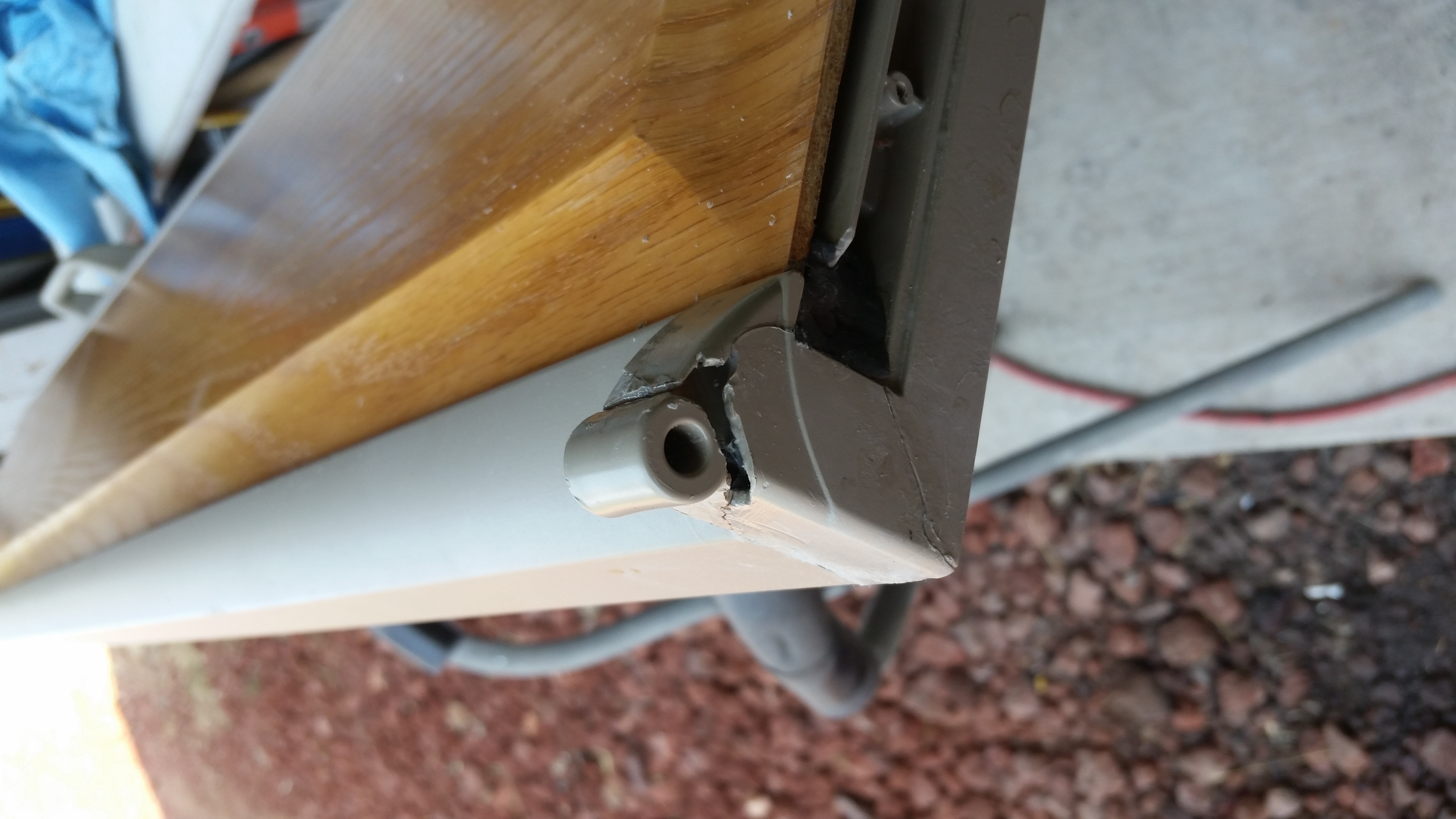

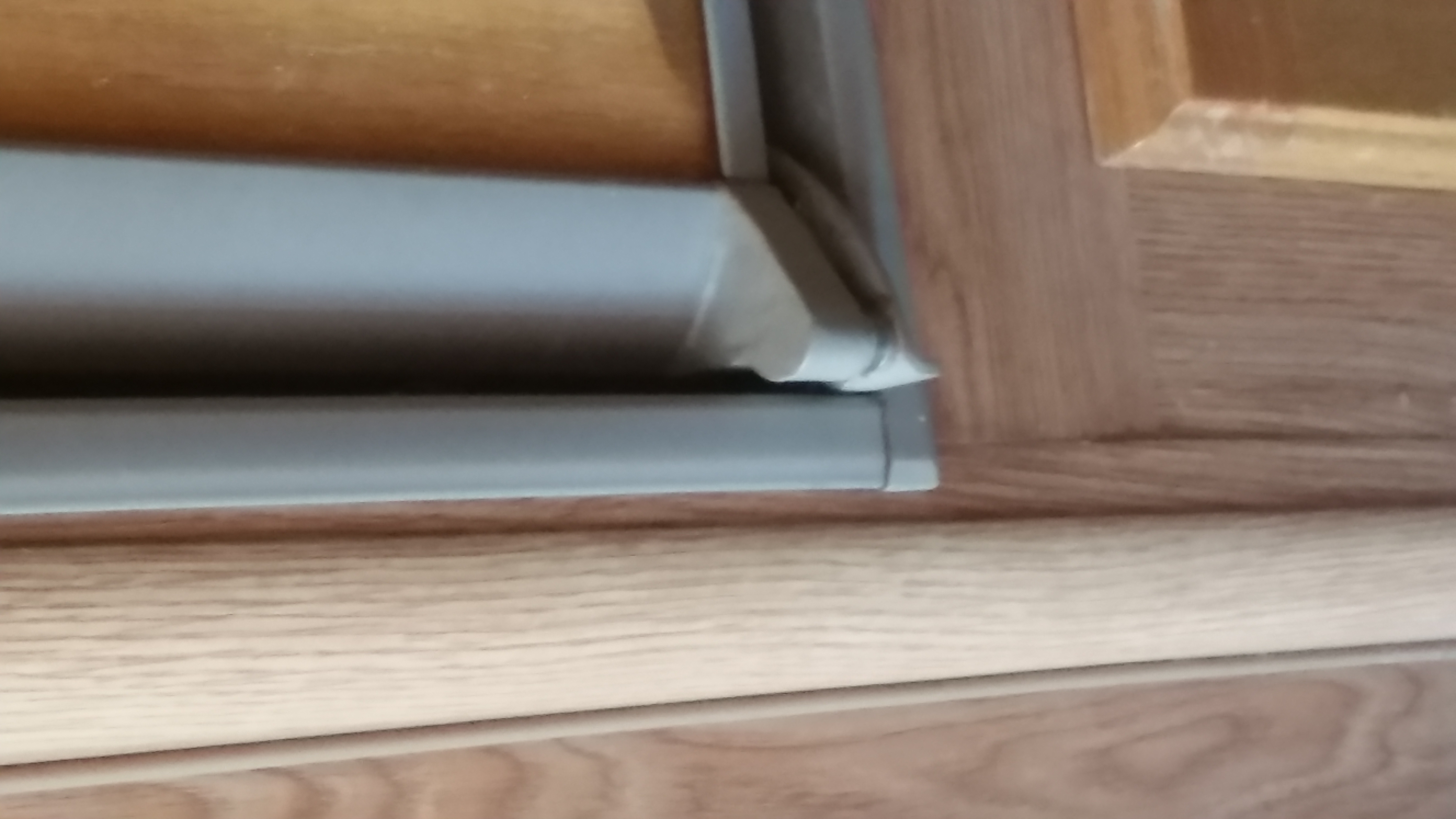

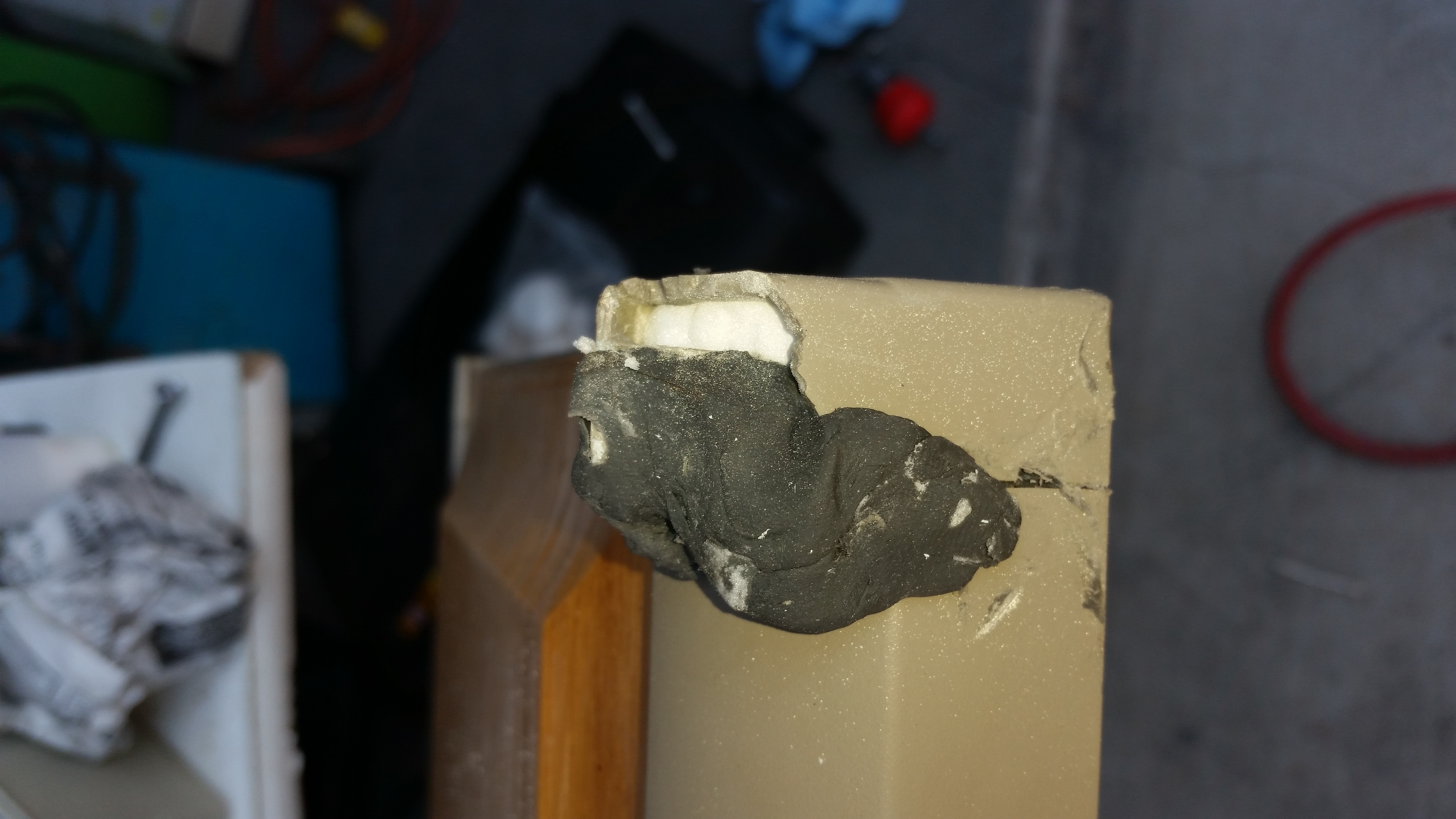

Here's a Plastex repair I did on my brothers RV fridge door.
The plastic door frame is all one piece and lucky if you could find one $$. He wanted to sell it, and his options were, a cobbed hinge of some sort, a new fridge, or try and source a salvage door.
You can see the hinge was shattered and snapped off, and carries the weight of the door. Originally a webbed molded hinge from the underside, the powder was used to fill the voids and root into the lower frame making it stronger than OE. Using Plastex as a powder 'fill' with a back up putty and then activate it , or, you can use the applicator and dab a small amount of powder lifting and/or dropping it in place with the activator for small finish areas. Like wetting your finger and lifting powderd sugar to place. A dab of activator over the top and it flows out like melting butter. Easy to use, very strong..
