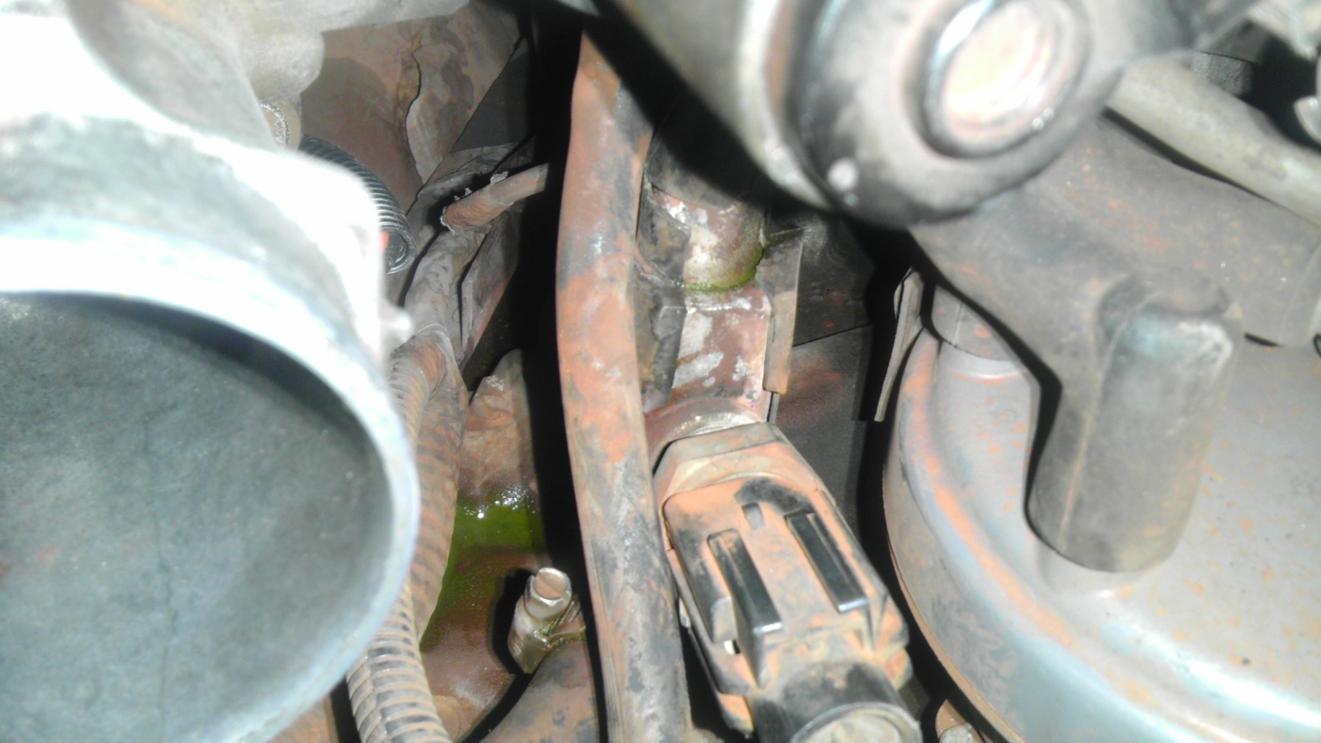

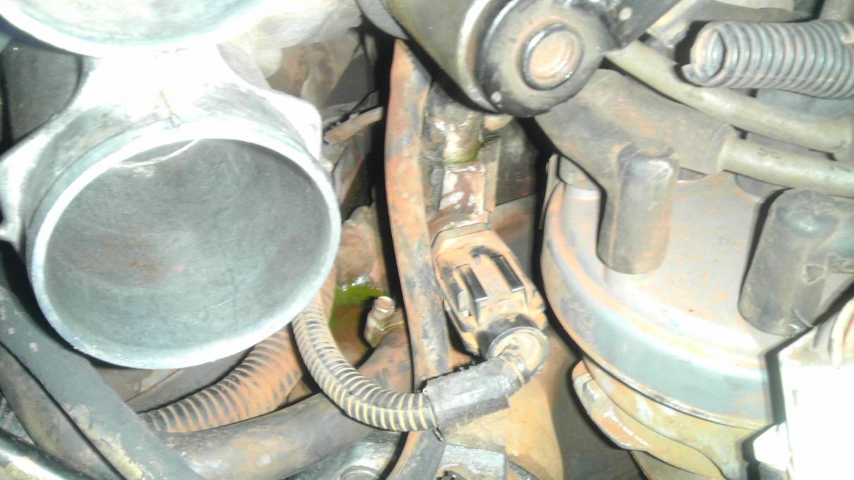

I need help identifying this part on my 94 econoline
94 Club wagon , 5.8 engine
On left side of distributor cap there is a ?( i am trying to find the name of the part) that is screws in to manifold. That part also has and tube, and a connector. see pics
That area there leaks antifreeze on and off and i am trying to find out what is the name of that part
Thanks for your help.
A suggestion, clean the area good and make sure the coolant is actually coming from the sensor. I see other things there that could also be a source of a leak. Once cleaned you can be positive where the coolant is coming from. Maybe the fan is blowing it around and spreading it.

I thought it was leaking from somewhere at or near antifreeze coolant sender( and that it why I posted the pictures because I was not sure what that sensor was) but last Sunday when van was slightly leaking I removed all the parts to look at coolant sender and I could see it was not leaking from there either

In looking more closely at your posted pix I would check the area just above where the coolant sensor is mounted. I don't remember what is mounted up there , but it probably leaks only when the engine is cold and as everything warms up and expands the leak stops and some of if not all of the coolant dries up. The easiest way to find this source of a leak is to pressure test the cooling system with a pressure tester when cold.
