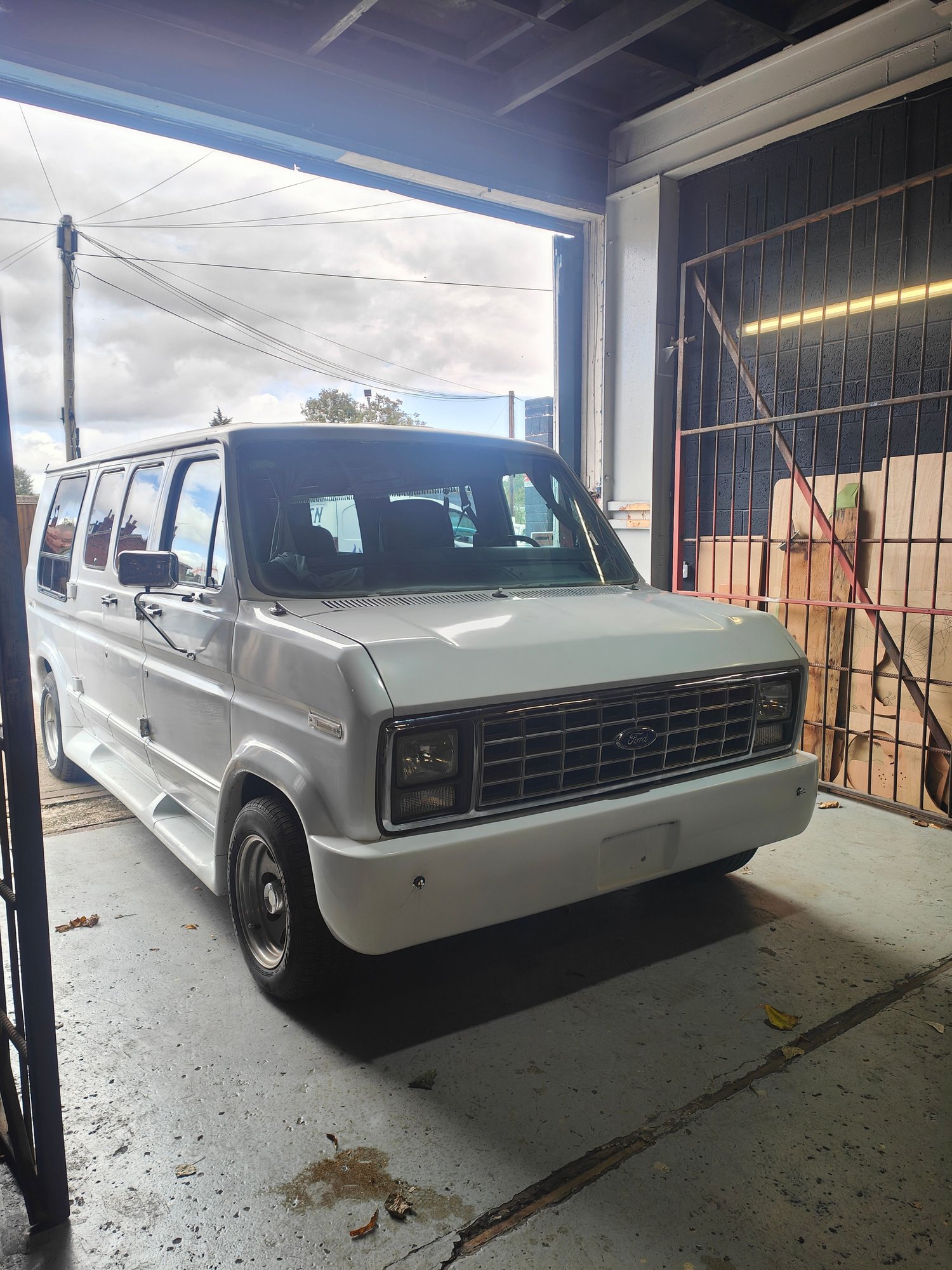

**1991 e150 7seater 302 2wd auto**
Evening all,
I'm new to the forum, so first of all, thank you for having me here.
I have recently acquired a 1991 e150. I love this thing, and it's been running a dream, untill recently.
The problems I have are with the headlights (mainly). They did work fine, but the. All off a suddenly they don't. Not only the headlights, but the rear side lights also don't come on. Along side that (also confirmed to work then suddenly stopped) are the horn and the central locking system.
I have tested quite a few things already, having browsed similar threads, but I'm still stumped.
Any ideas as to what it could be? Why would these seemingly unrelated systems stop at the same time?
Thanks in advance all 🙏
