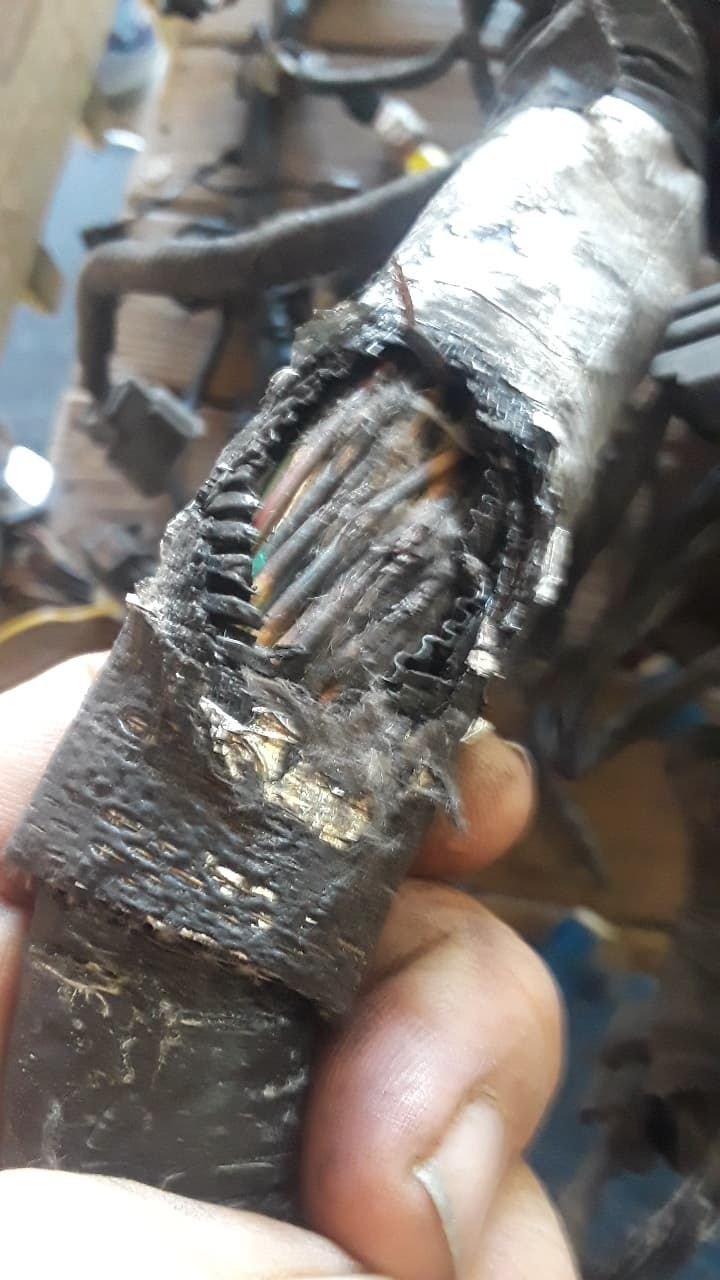

Old Jan 7, 2021 | 11:23 AM
Gaszak Stefan's Avatar
Joined: Jan 2021
An Update to this Issue. I can not log in with my Nolacool account...idk why.
I took out the Main Engine Wire harness and found right away the burned/rubbed spot.
Called Ford to order the new harness but Ford does not sell them anymor...WTF ?....so i looked online and found one by Ebay for 300. Installed it and the Van is running like NEW.
Spread the news...if OD Light is blinking its not allways a bad Transmission.
I attached a Picture of the Harness.
Th
anks for help and Happy New Year
