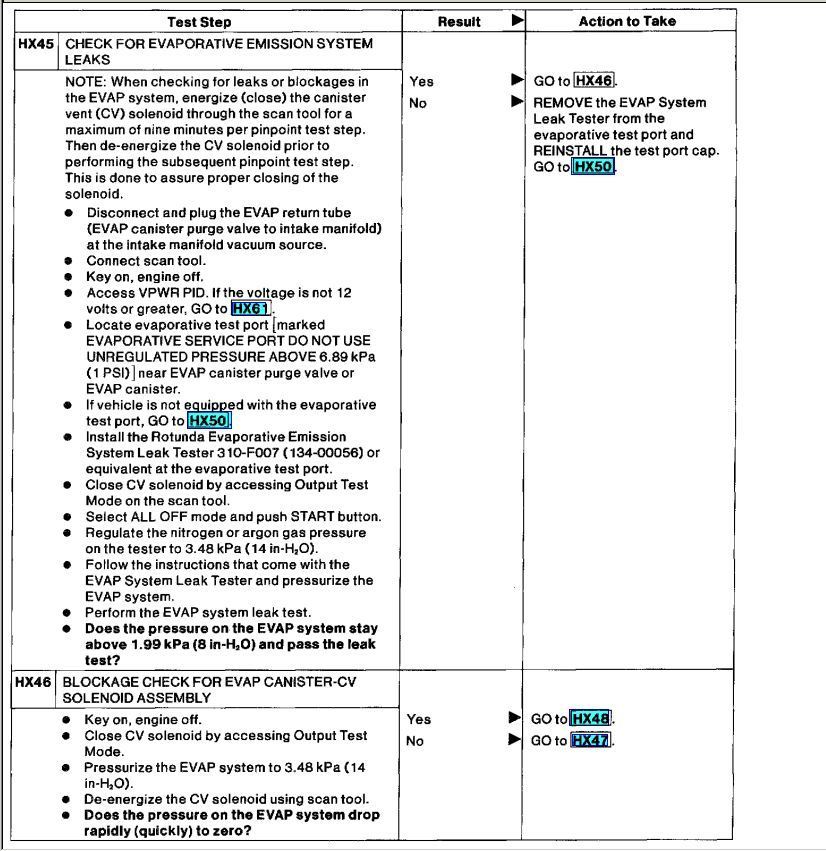

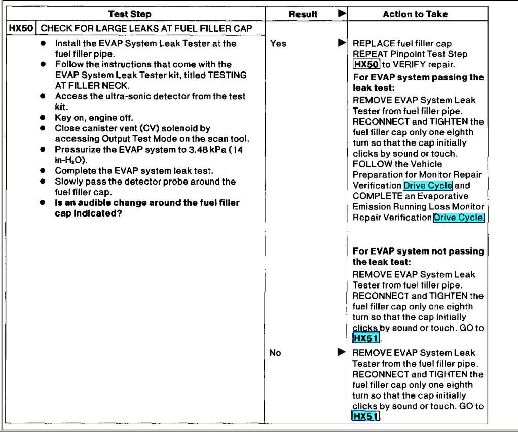

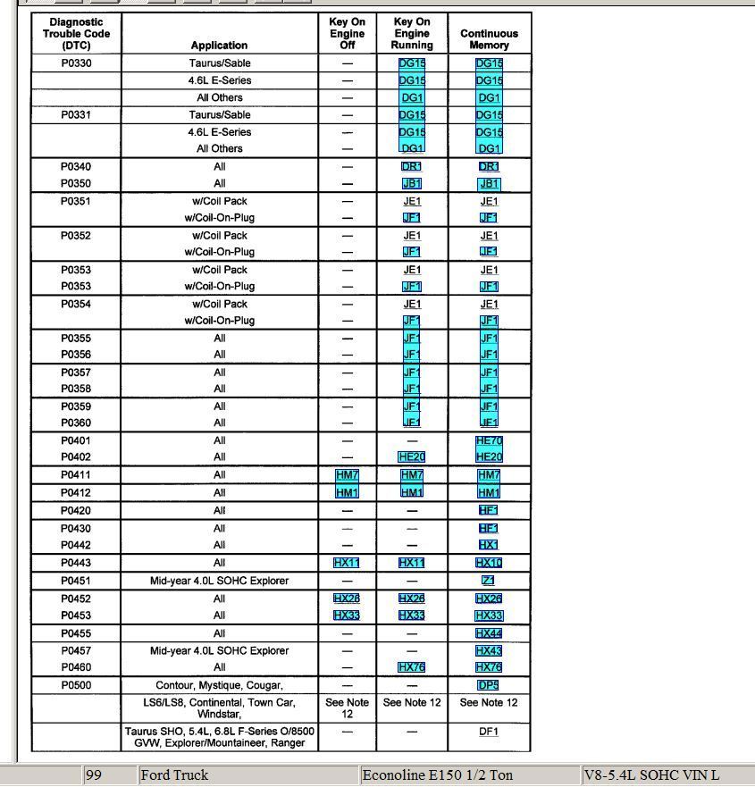

What is the most common issue with that code p0455 van run fine start fine accelerate fine only thing i can smell little bit odor vapor gas when i get out and walk beside van driver side
Old Jul 23, 2025 | 01:05 AM
Simply follow the HX numbers accordingly. I picked out a few HXs, if you need more download the HX-ALL.pdf below.
Wow this is fast and detail like champs know what im talking about 😁🤙 thanks
