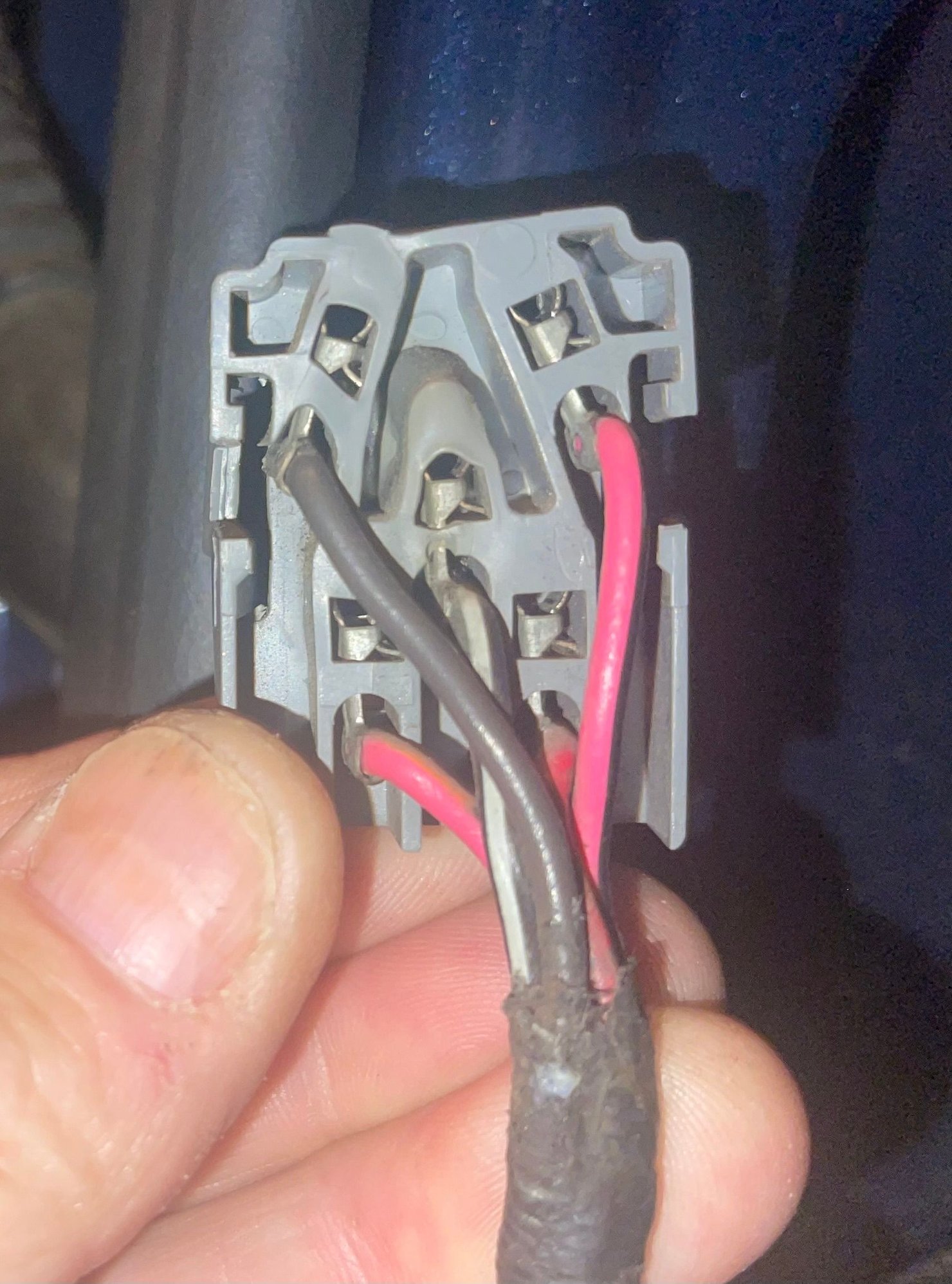

I’ve got a feeling the rear cargo door switch is the problem. It’s been working on and off lately, and when I took it out to inspect it, it looks pretty roached and when you shake it there’s stuff rattling inside it. Anyway the trouble is that the switch is discontinued and not available anywhere. I’d like to try bypassing that switch first to see if this is the problem but I’m not sure how I’d do it. I assume I’d have to jump some of the sockets in the connector but there are 5 pins and I can’t figure out which is which.

Ok so here’s an update. I took the rear switch apart and the rattling sound inside was one of the switch contacts corroded off (you can see it in the picture below on the right).
If I can’t find a new switch (unlikely since it’s been discontinued for over a decade) I’m going to have to figure out a way to bypass this switch so the others will still work. Any ideas?

To bypass the switch, connect BN to PK/OG, separately connect RD to PK/BK and insulate BK/WH.
Note that the wiring is completely different if you have Remote Keyless Entry - Those only have three wires on the switch.
