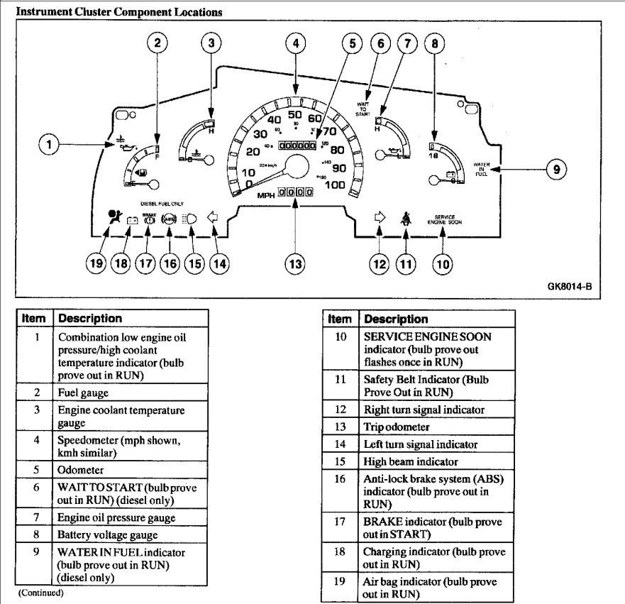

16 - Yellow ABS
19 - SRS
These 2 are voltage sensitive and don't like LED bulbs. If they can't prove out you might want to switch them back to non-led or by adding load resistor.
