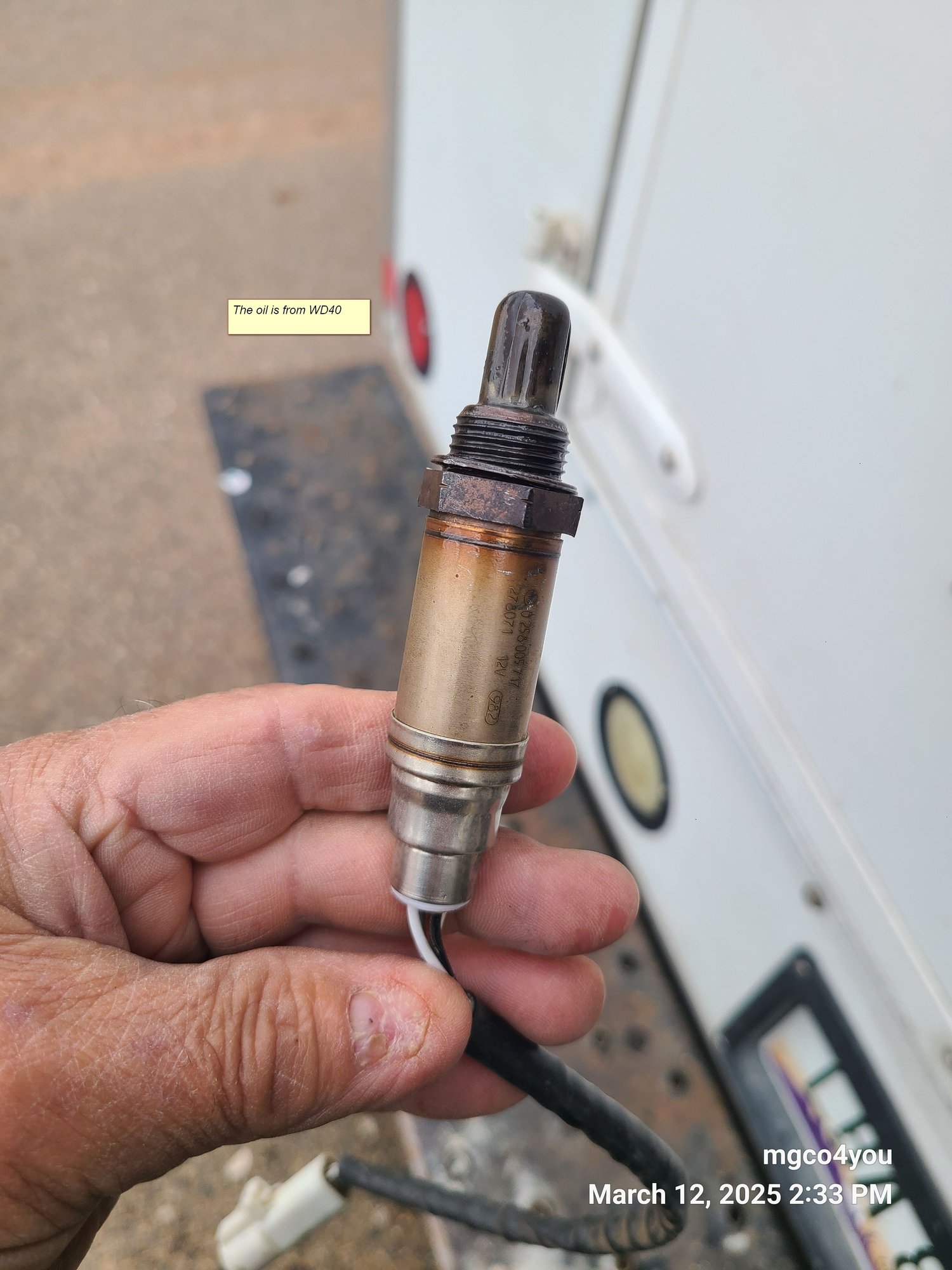

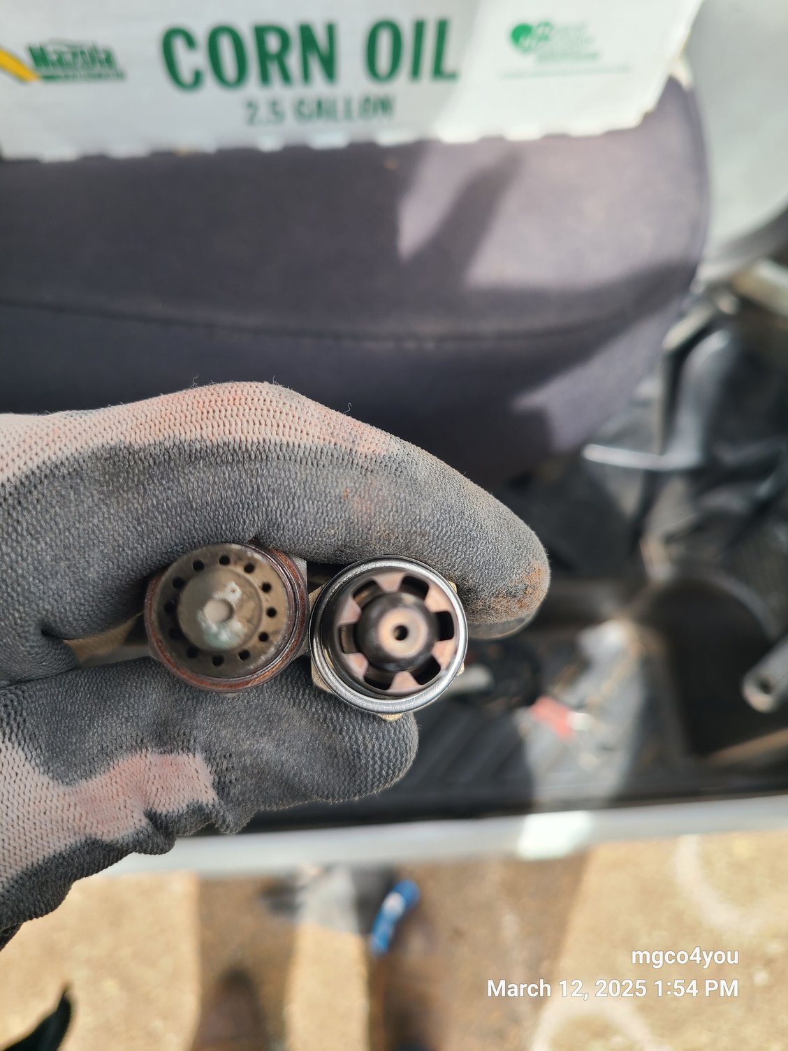

Hi
My 2009 E350 5.4L starts up very nicely and in idle putting in gear she will move but if I accelerate she quits. I was told is catalytic convertor problem but the convertor looks new replaced, one may think it maybe the sensors so I got two upstream and replace them but now she wont stay on but two seconds. I did not replaced the downstream (one only)
Are the old sensors cleanable? or what mite be the right part in case the one I got was not the right ones. So what you guys think it may be the problem
Thanks

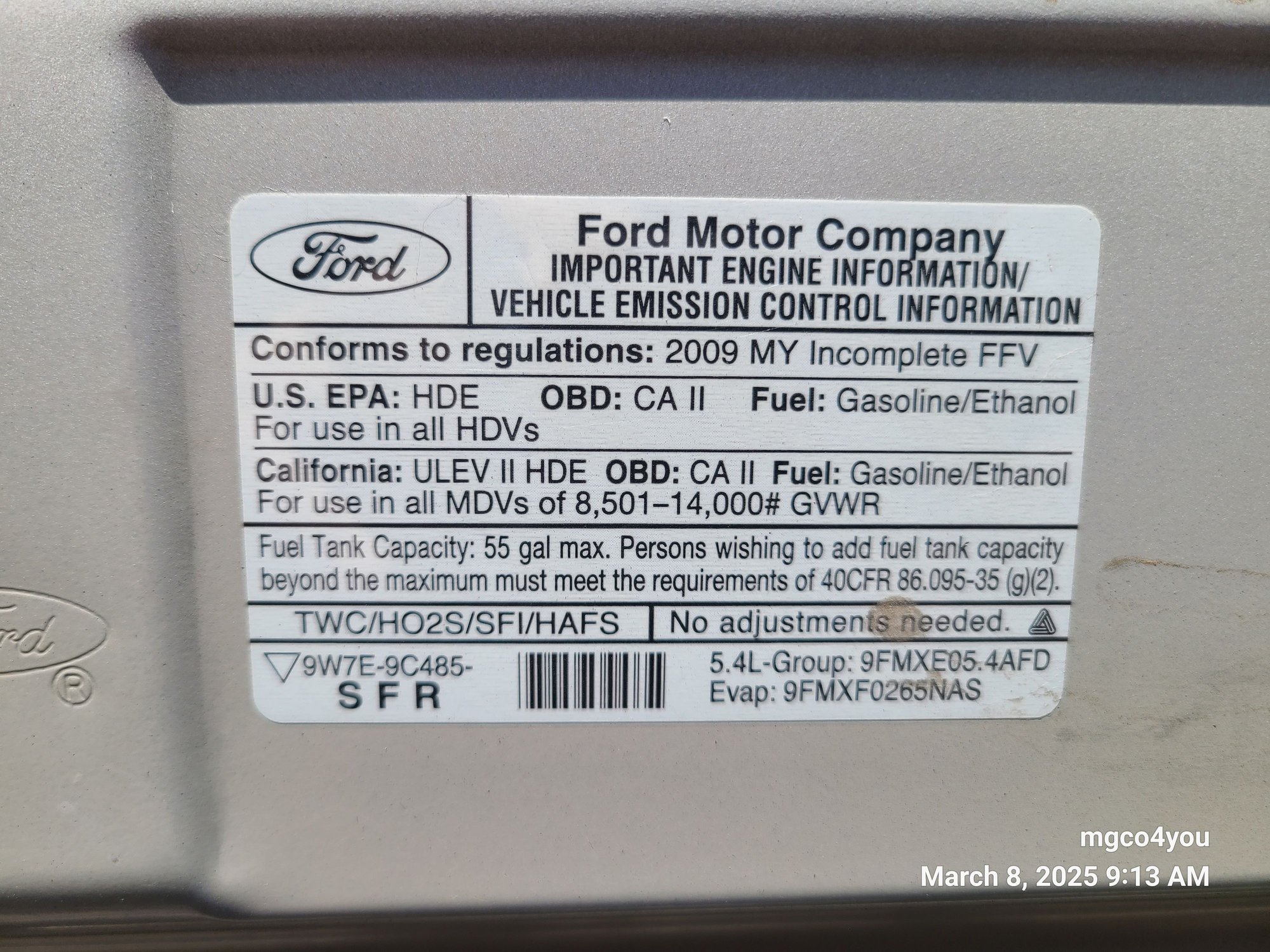

Something is not right here.
You are telling us your vehicle is a 2004 - E350 and showing us a sticker for a different vehicle.
A plugged catalytic converter will produce the symptoms you describe..
The problem is with the cylinders on the passenger side of the engine.
You should consider getting the correct oxygen sensors in there and replace that converter. If you give the parts store the wrong info , you will get the wrong parts.

You right I have the wrong year I changed the year for future participance
