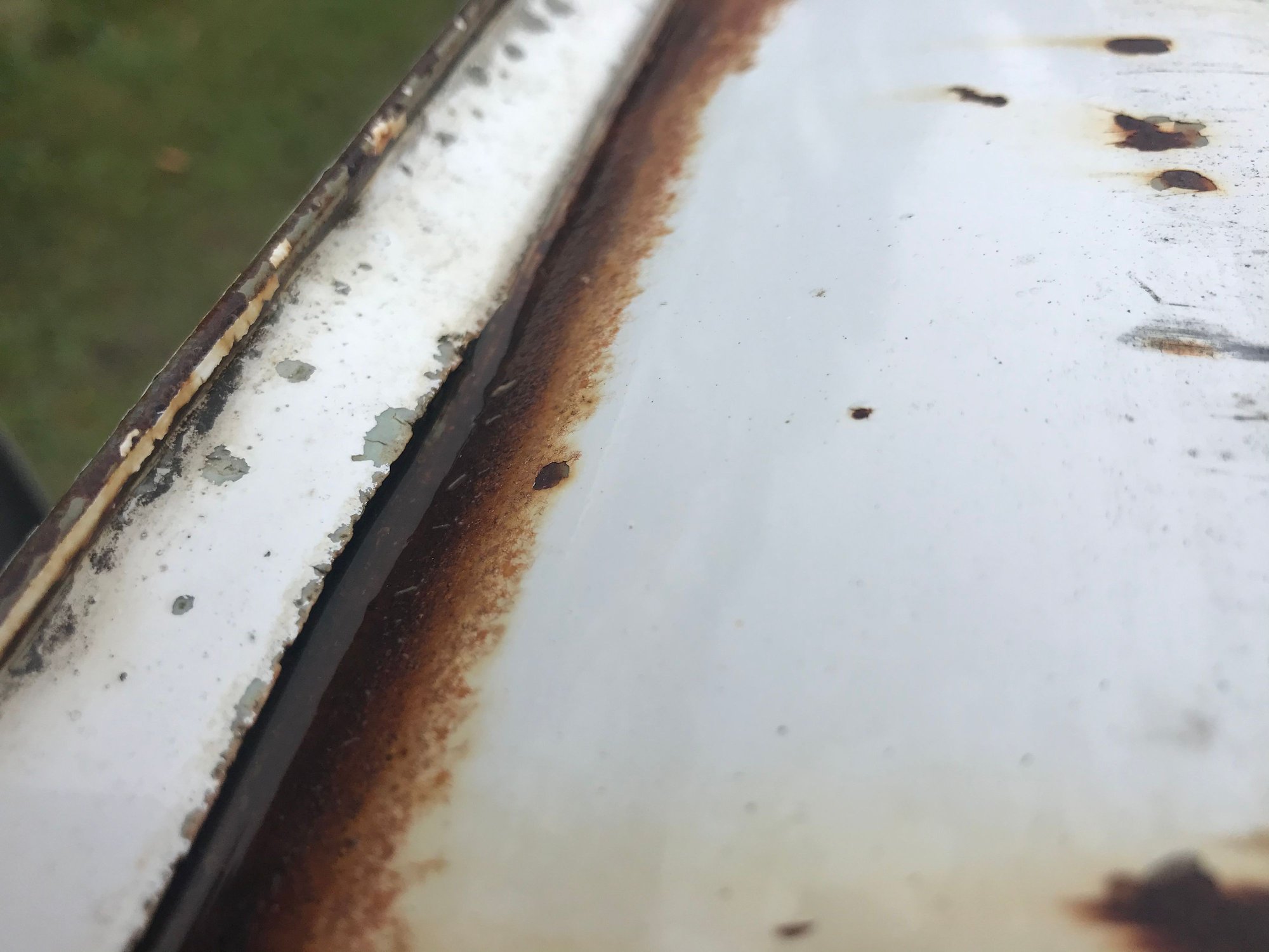

I also found this parting of the roof seem

I used ‘thru the roof’ a contractors flexible roofing product which stays somewhat flexible
I bedded in the roof brake light and did that roof seem.. at over $70 for a replacement brake light I can live with having to pry out the old one if it needs to come out.
this has reduced the leaking but sitting inside the back when it rains I can see drips rolling down the back of the doors. Until the floor is repaired and I get the bottom door latch welded on I can’t make a decision on the door seals .. they’re probably ok once the door is held in it’s proper position
