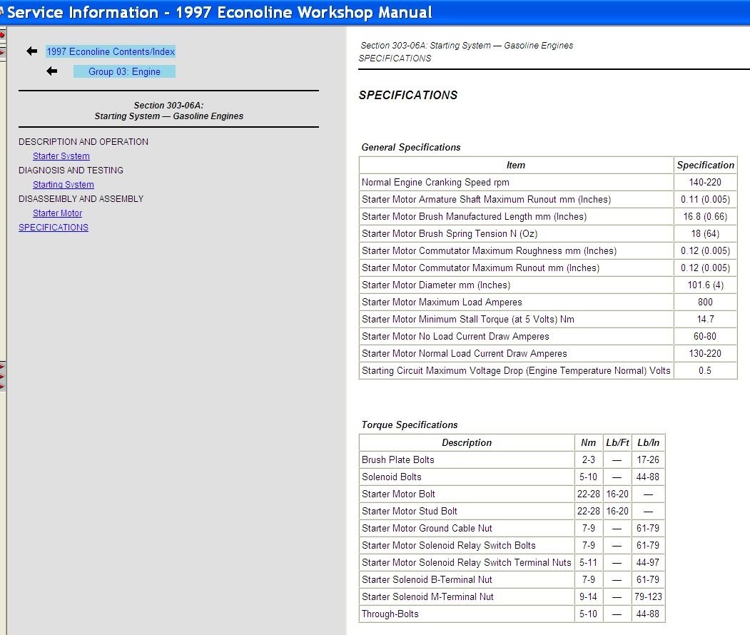

Quick question... '97 E150 5.4L E4OD RWD.
I'm replacing the starter. As I unbolted the old starter I noticed a small crack in the bell housing where the one starter bolt mounts. It doesn't look like it's completely through the casting and obviously has held all these years.
I looked in several manuals for a torque spec for the starter bolts but they just say "tighten the bolts securely". Can anyone give me an approximate torque for these bolts so I hopefully don't make the crack worse? I'd hate to accidently make it "apprentice tight" and crack it completely.

Starting System specification page from the Factory Service Manual...

To etinpa, thanks for the quick information. That's exactly what I needed.
