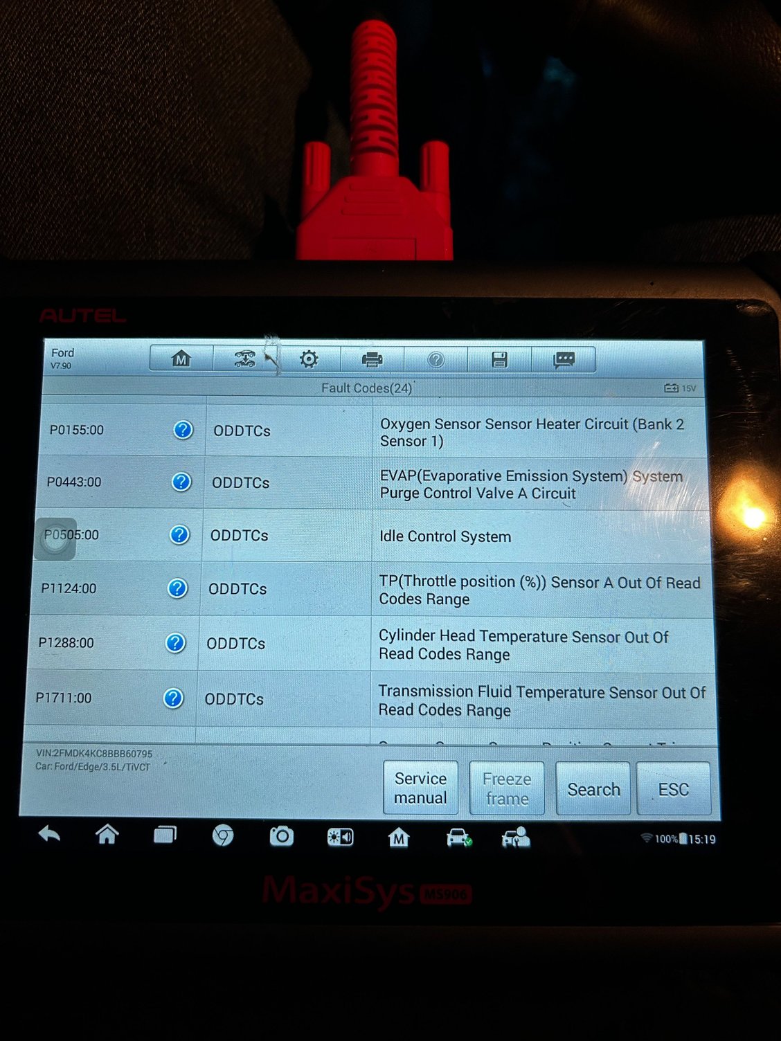

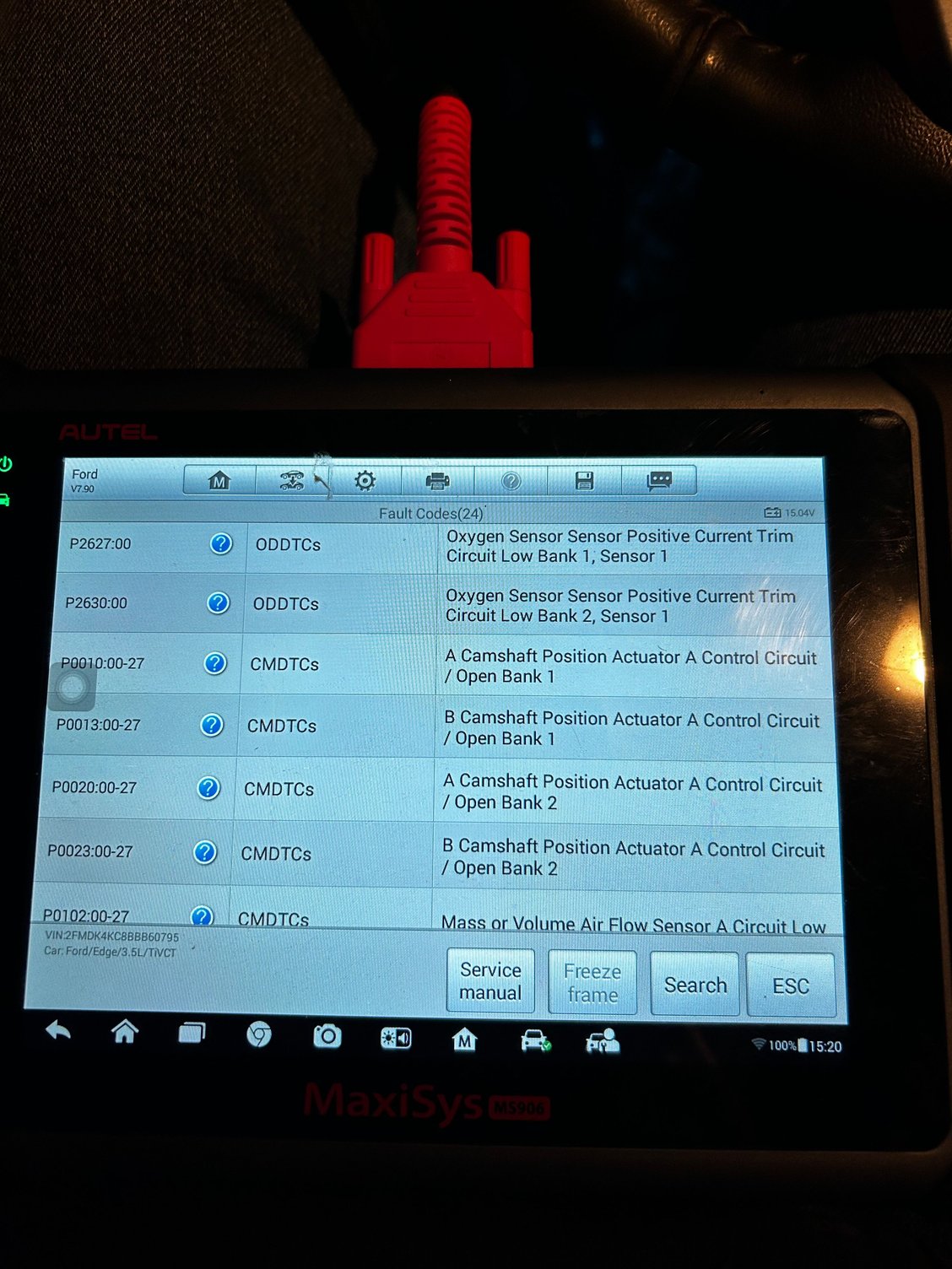

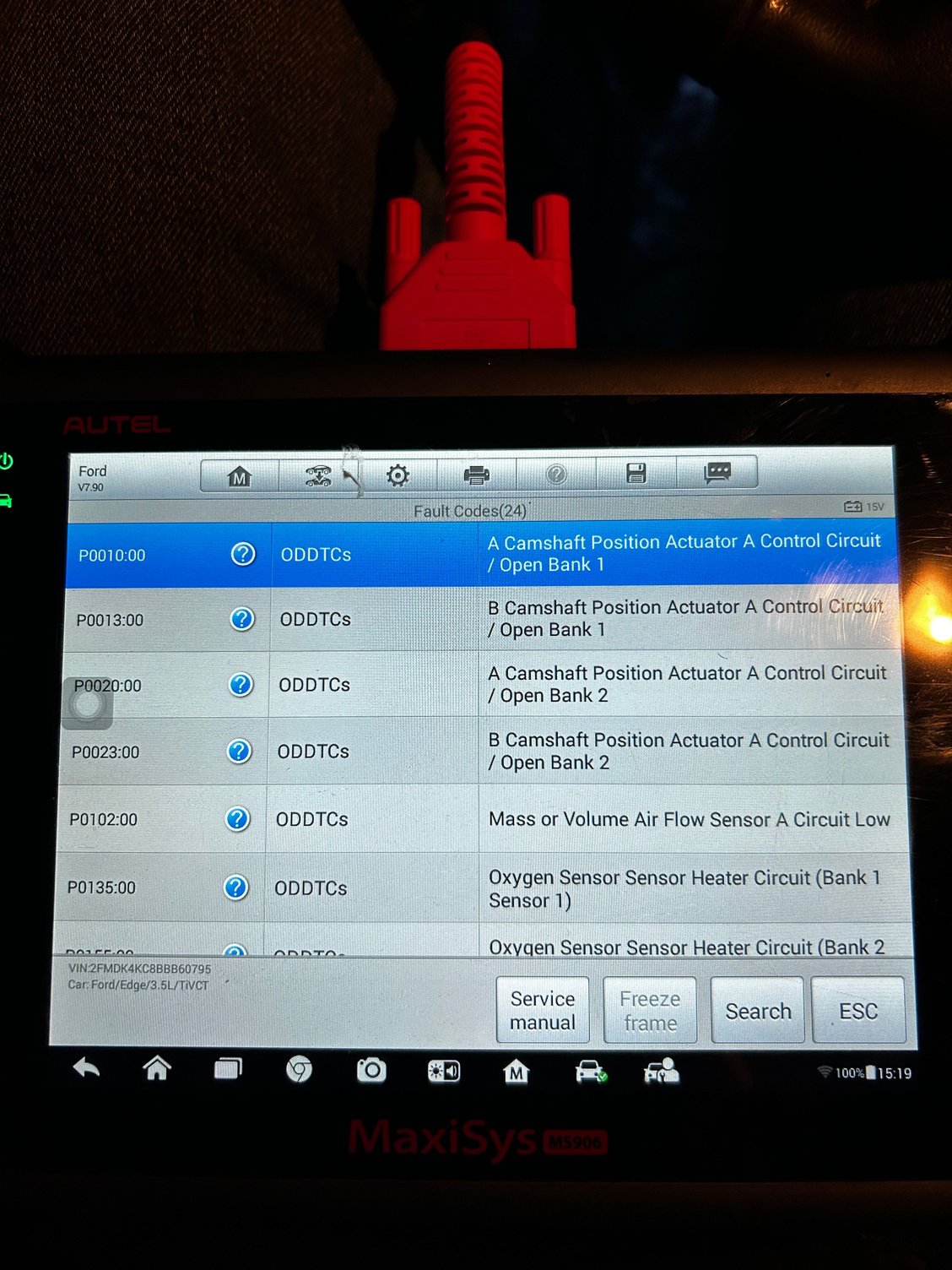

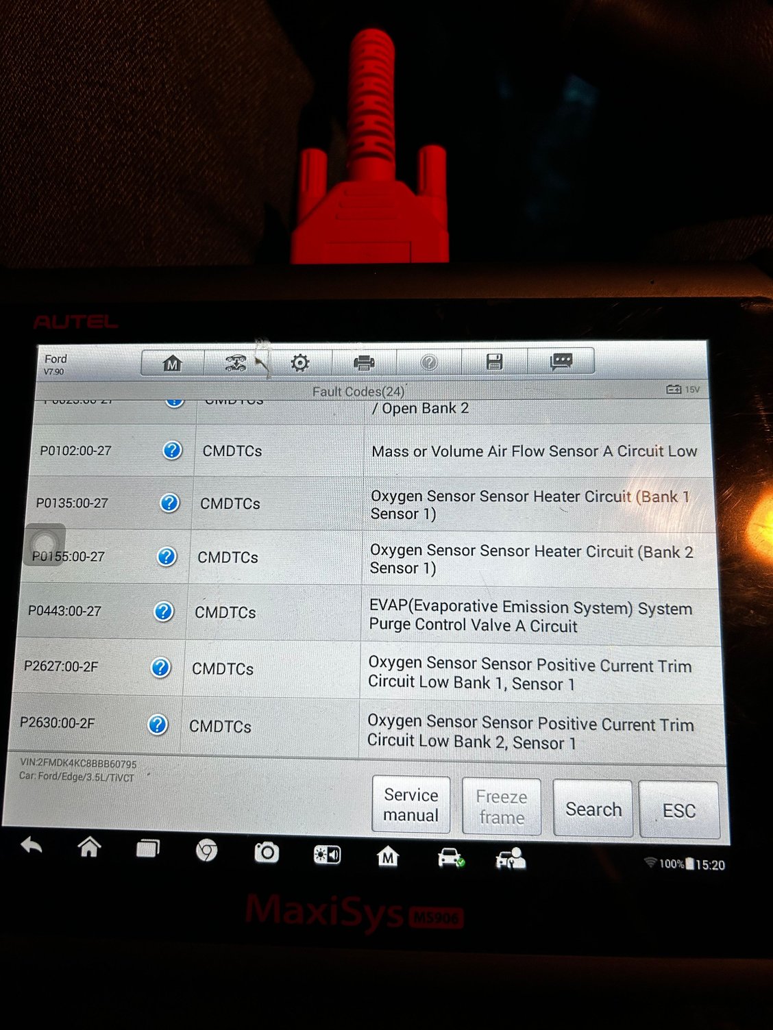

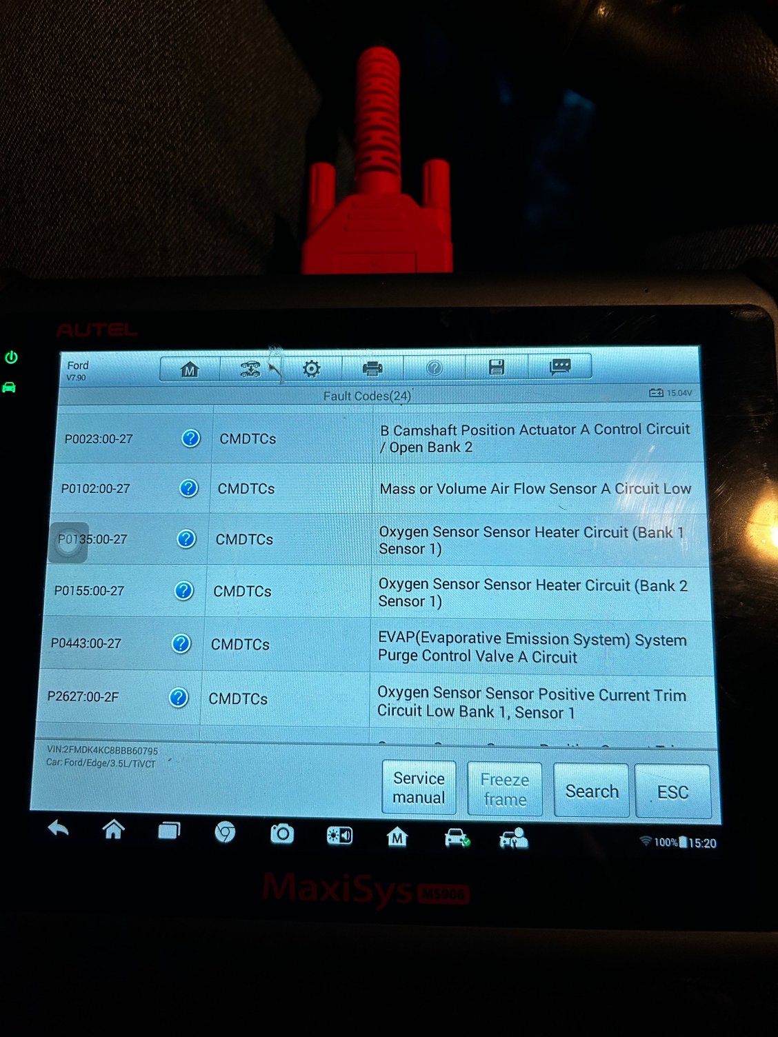

So I have a 2011 Edge 3.5L with about 277,XXX miles. When I was driving home from work the other day the Service Advance Track and check engine light came on. The vehicle lost all power but from my understanding it went into a limp mode. I borrowed a buddies code reader and found it has 24 active codes. From my understanding I have a harness or ECU issue. Does anyone happen to know if there is a common rub spot on these vehicles? I attached the codes that come up.

The PCM provides the reference voltage , which appears to be missing.
Suggest you start with checking the fuses.
