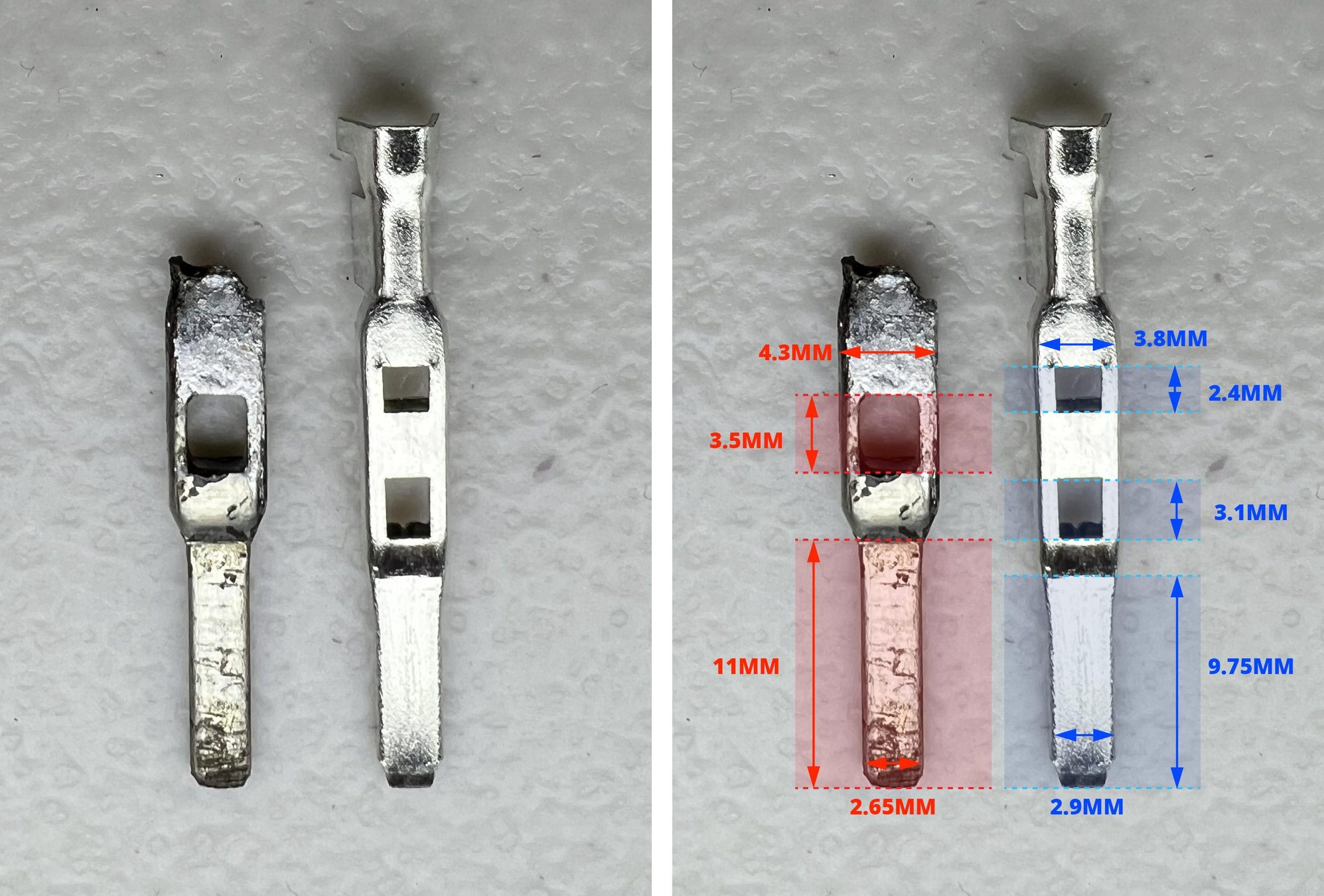

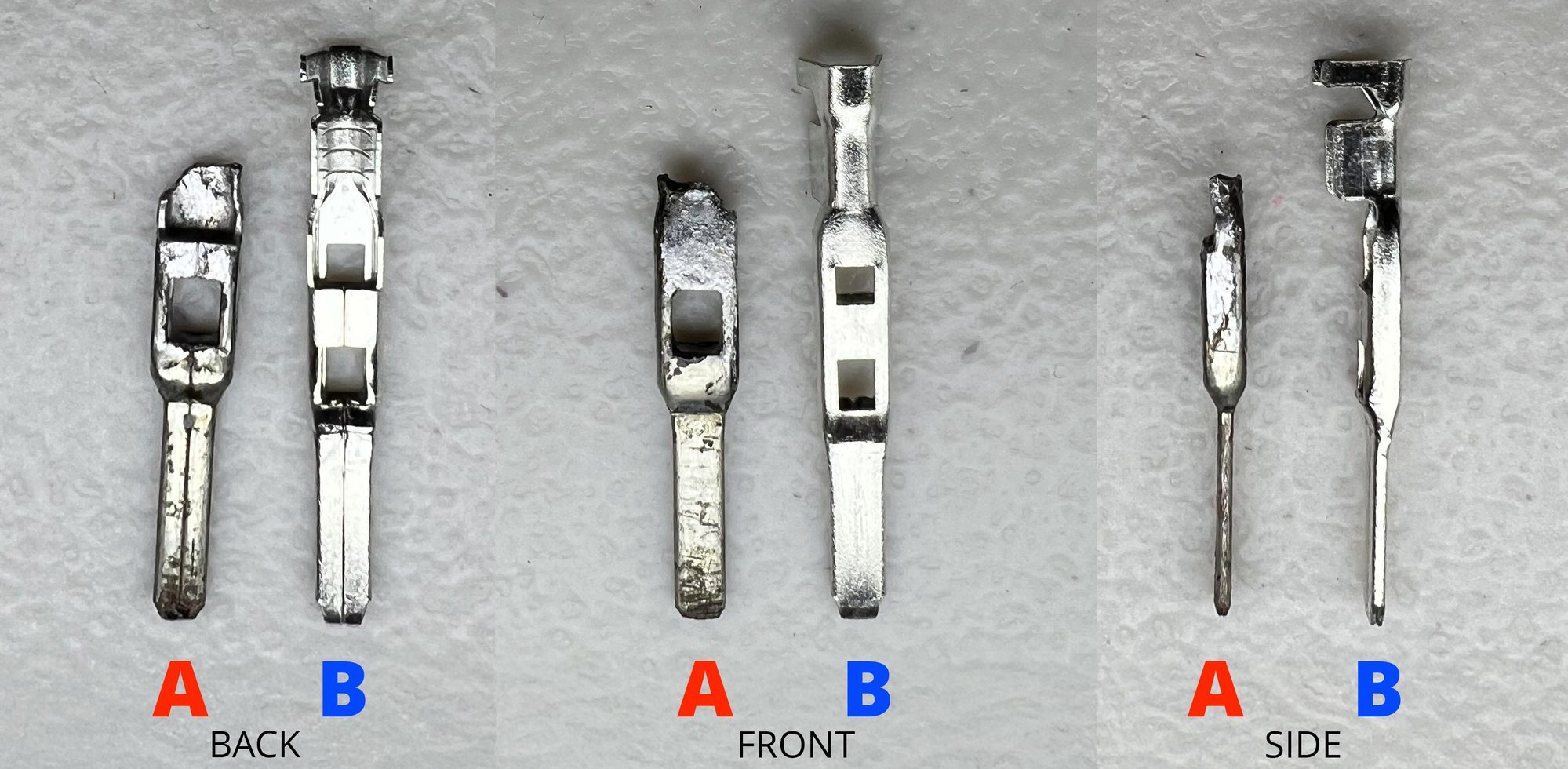

Awesome, thank you heiko! I got the Terminal pins you recommend. It looks like the 2.8mm Series one that looked close to the one that came from the 2014 Edge won't work. I've attached two images to showcase. A (red) = Old Terminal Pin, B (blue) = New Terminal Pin. It was hard to see that there was a second hole in the new terminal pin based on the amazon product images for 2.8mm. Back to trying to figure out which is the correct Terminal Pin
