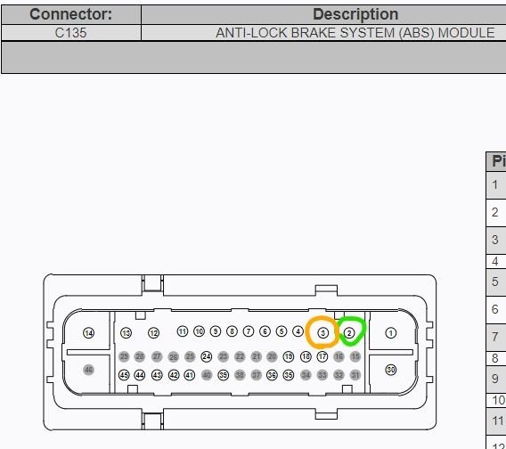

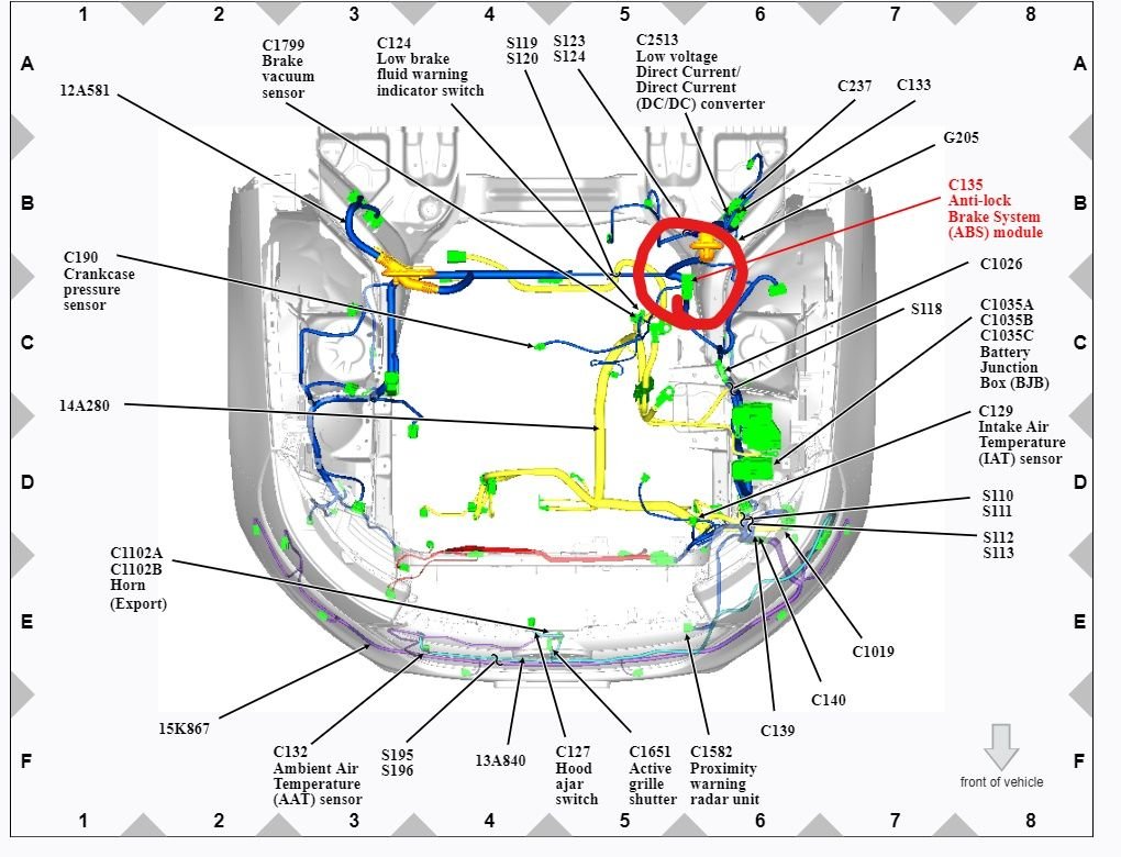

Here are wiring diagrams and connector faces, its only two wires so its easy other then the fact the connectors are about 20 feet apart, buy about 20-30 of wire (I would buy at least 14 gauge) and crimp/solder a alligator clip to each end of the wire.
C2007 is suppose to be diagnosed before other codes. Really all you are doing is checking if the wires between the ABS module and the parking brake motor to be less then 5 ohms and they are not shorted to each other, or either wire shorted to power(with key on) or ground(with key off), in addition checking the resistance of the parking brake motor itself to be less then 10 ohms.
Pin point tests lose all formatting and the yes/no questions when copy and pasted to this website so they are next to useless.
