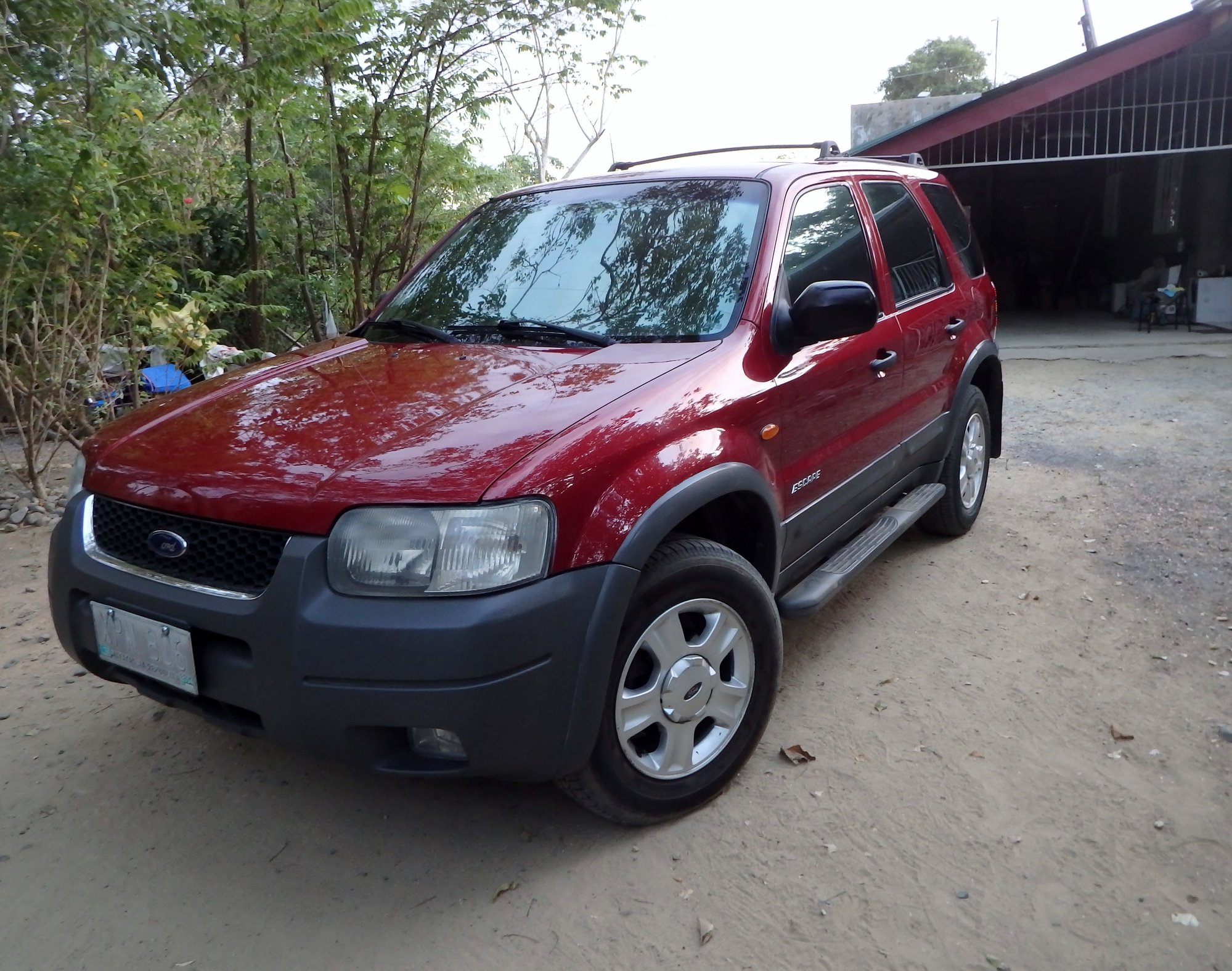

This is it 183,000 kilometers on it when I bought it.
Hello from a newbie. My wife is from the Philippines and we go there in the winter often to get away from the cold. I got tired of being at the mercy of relatives to get around so we bought a 2004 Escape to keep at the house there. It needs new headlights, I tried to polish the old ones, but the silver on the reflectors is now dull gray from the humidity. I have tried searching for info, but no luck I would like to upgrade to the 05 headlights if they will fit. I know I will have to make adapters for the wiring harness as the plugs are different so all I need to know is if the will physically bolt in and look right? To me, it looks like they are the same shape, dimensions, and mounts, but I want to be sure before I invest my money.

Since no one replied I went to the bone yard to research the problem. The 05 lights will fit if you use 05 horn brackets to relocate the horns. I will be making wiring adaptors to change to the newer style plugs for the 05 headlights.

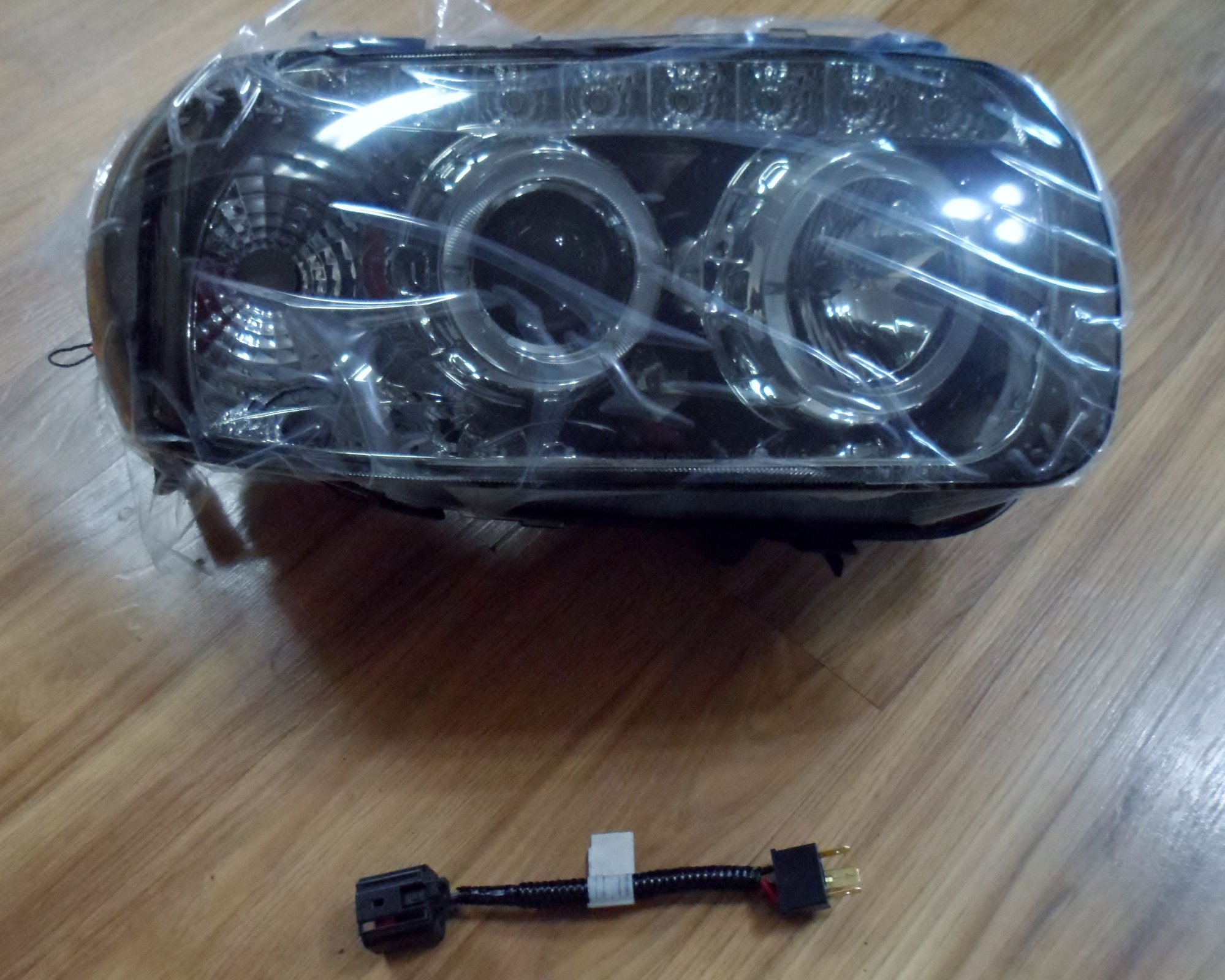

I could use info on the wiring so I can make the adaptors if you could. I can figure it out on my own if I have to but it would be easier if I had wiring info. I cut the plugs off an 05 from the bone yard and have new old style male plugs to make the adaptors, just need to figure out which wires to connect together.

I sent the connector views to your email. They have wire color/tracer, pin number/locations. If you want the front schematics, let me know..

My new headlights arrived today and I made the wiring adaptors.
