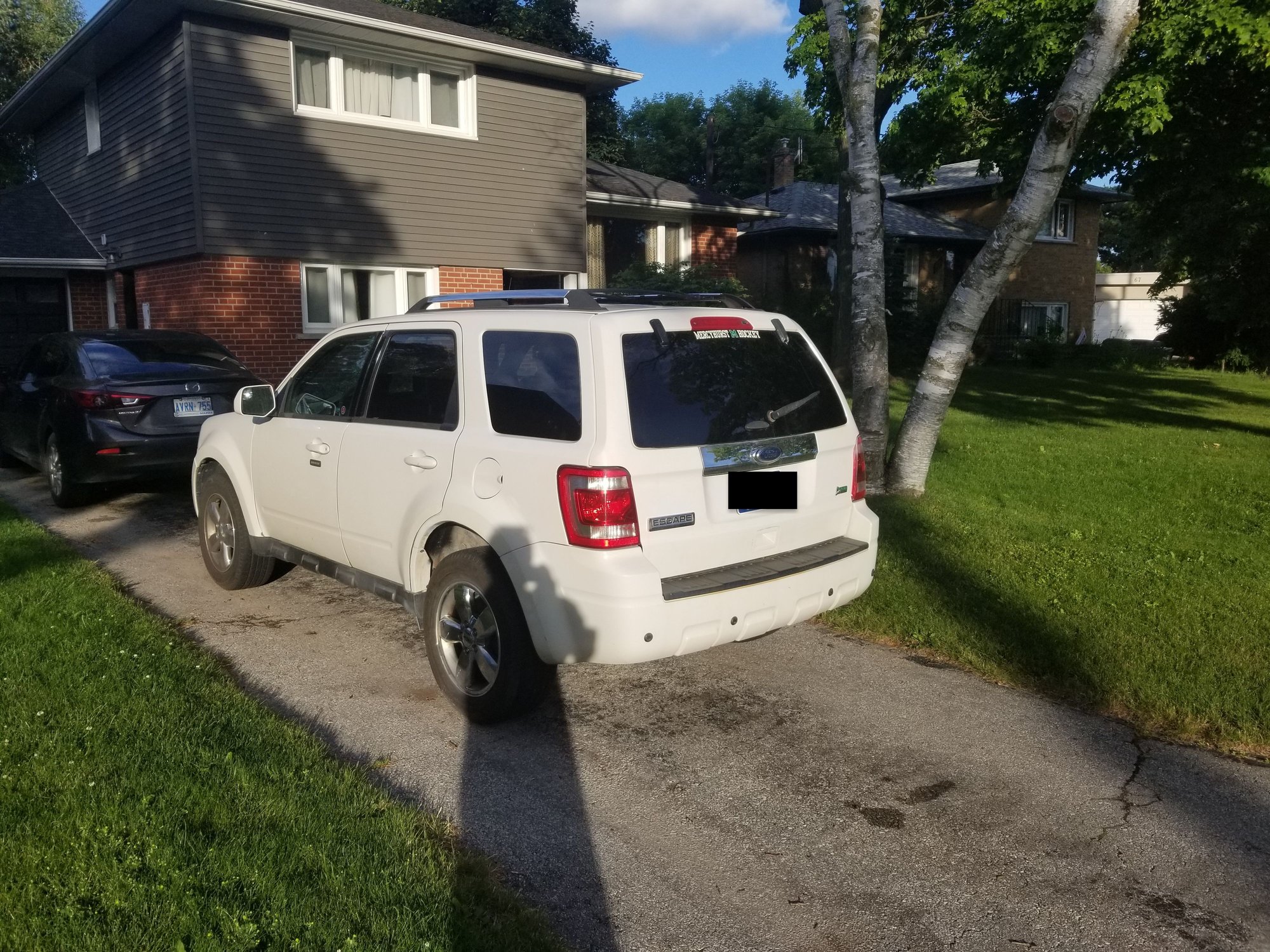

I absolutely love this vehicle and no reason to be scrapping it, or passing it to another when i know there is a gremlin in there.
I bought this beast for my son when he was a teenager and it has sentimental value seeing it reminds me of him, and i woudn't mind putting some money into this to get a lot more years but this random stalling issue has to be addressed first. I did the body work myself on it so that is excellent, and like i mentioned this thing runs as well as it did when i purchased new back in 2011....just this crazy stalling when hot is killing me.
