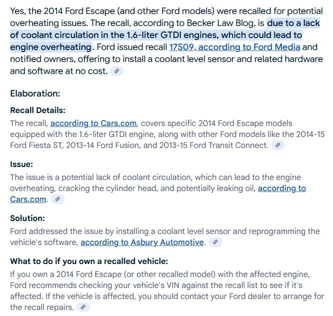

I think there is a recall on the overheating on your 2014, you might want to check that first, simply search 2014 ford escape recall overheating at google.
A quick screenshot below:
