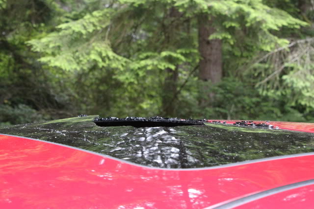

Default Taurus Sunroof Exploded
It just happened to me. Driving at 70 mph, open highway, 74 degrees F outside. Sounded like a shotgun was fired just outside the car.
2011 Ford Taurus is 2.5 years old with 28K miles. Ford is trying to say it's a road hazard, but nothing hit the car and nothing was around the car.
I've ordered pictures incase I need to report this to the feds and send to the Ford CEO. Hopefully we will resolve this the way it should be. You can plainly see that this exploded outwards. It's a good thing that no car was behind us. If we were on an LA freeway, there could have been a huge mess in the rear view mirror.
