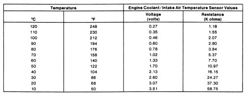

Just in case somebody is interested -found some data about sender and sensor
Attached Thumbnails 95 wagon coolant temperature-coolant-temp-sender.jpg   95 wagon coolant temperature-ect-iat-temp-chart.jpg

I dont know if you can trust the resistancies of the sender I posted earlier
I couldn't find any with 500 ohms cold and 17 ohms hot, but I put a Standard Motor Product TS 300 in that measured at about 2.5 Kohms cold and it seams to work, although the gauge worked fine when i probed it with resistors
Very strange
