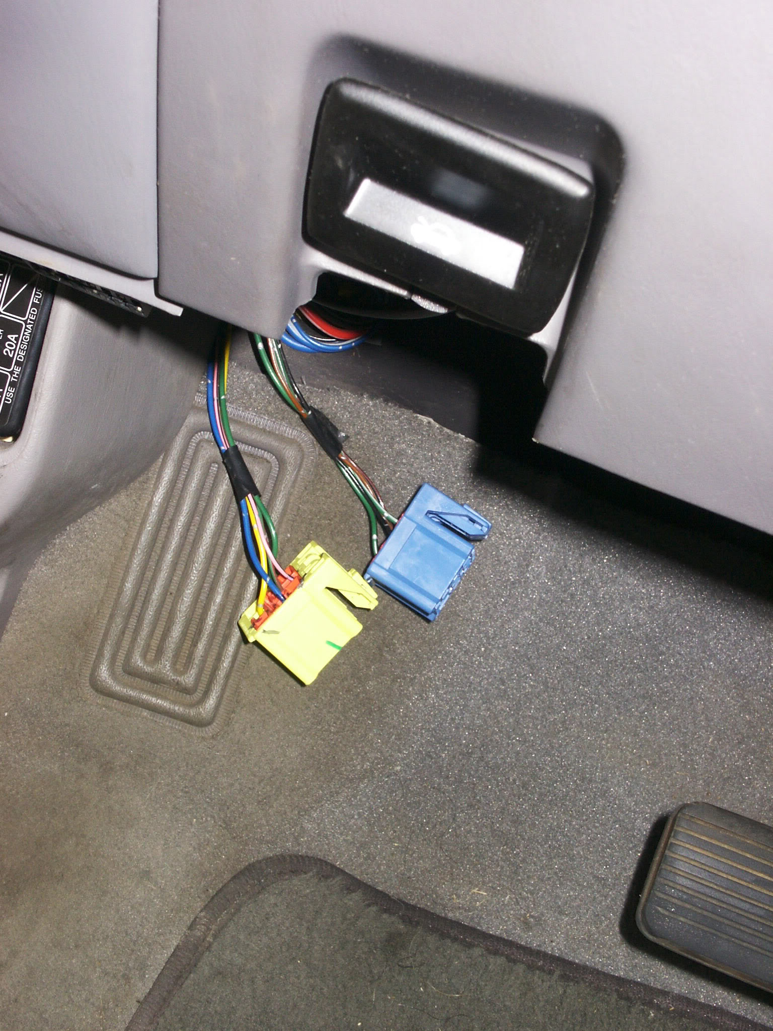

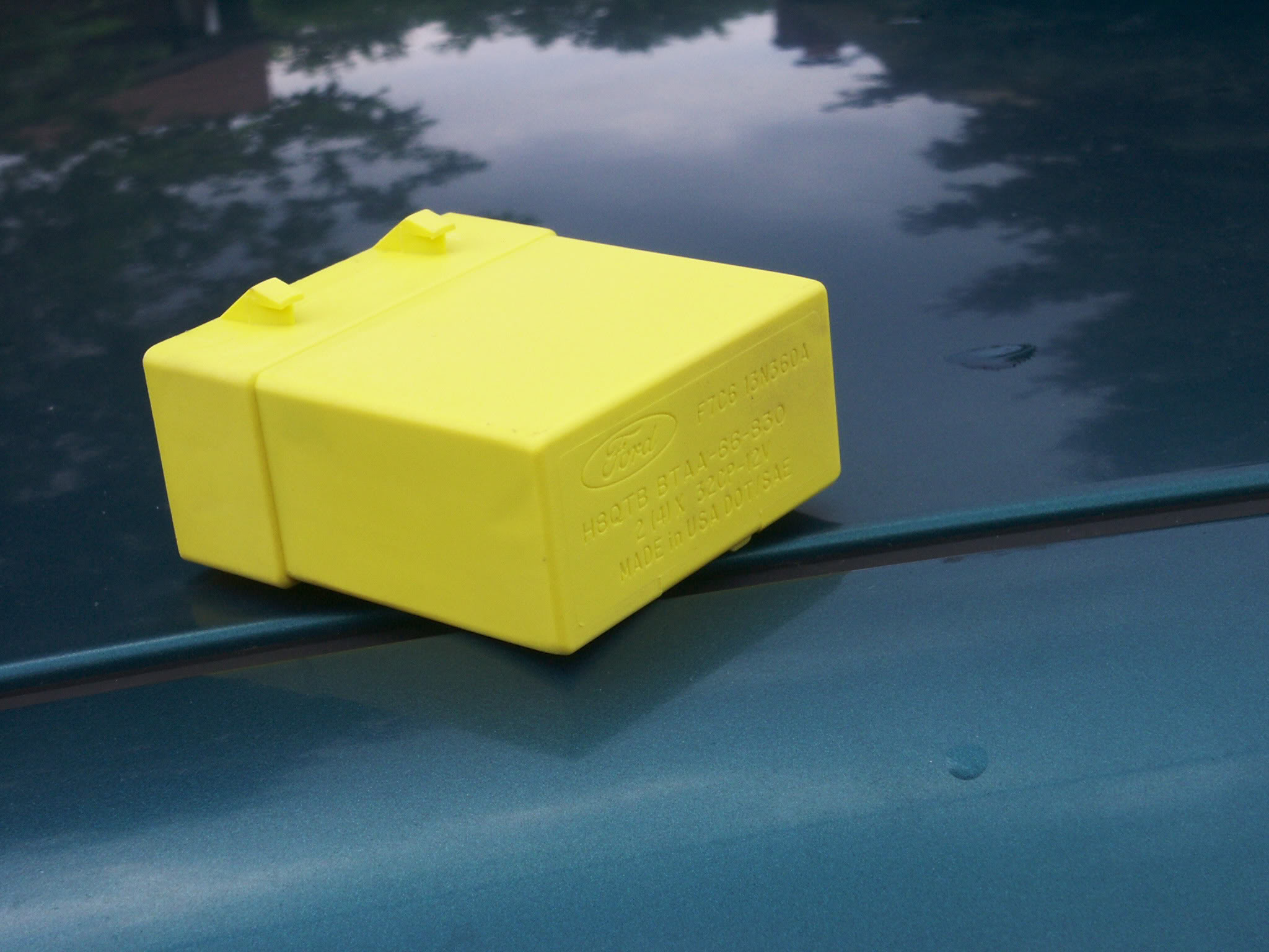

Now, the problem: they're flashing at crazy speed, due the low current draw. I checked with a technician at local Ford dealer and located the flasher unit:

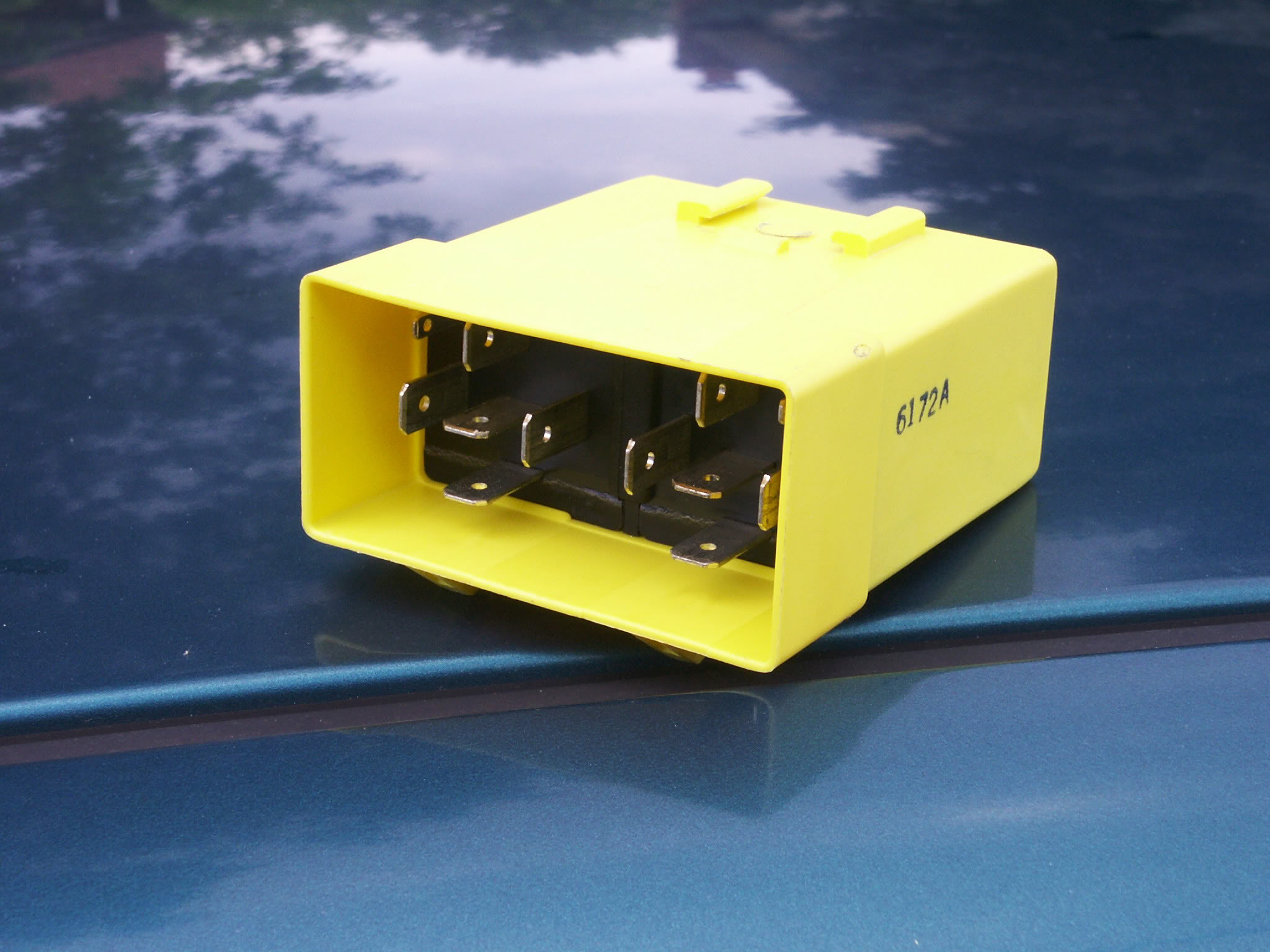

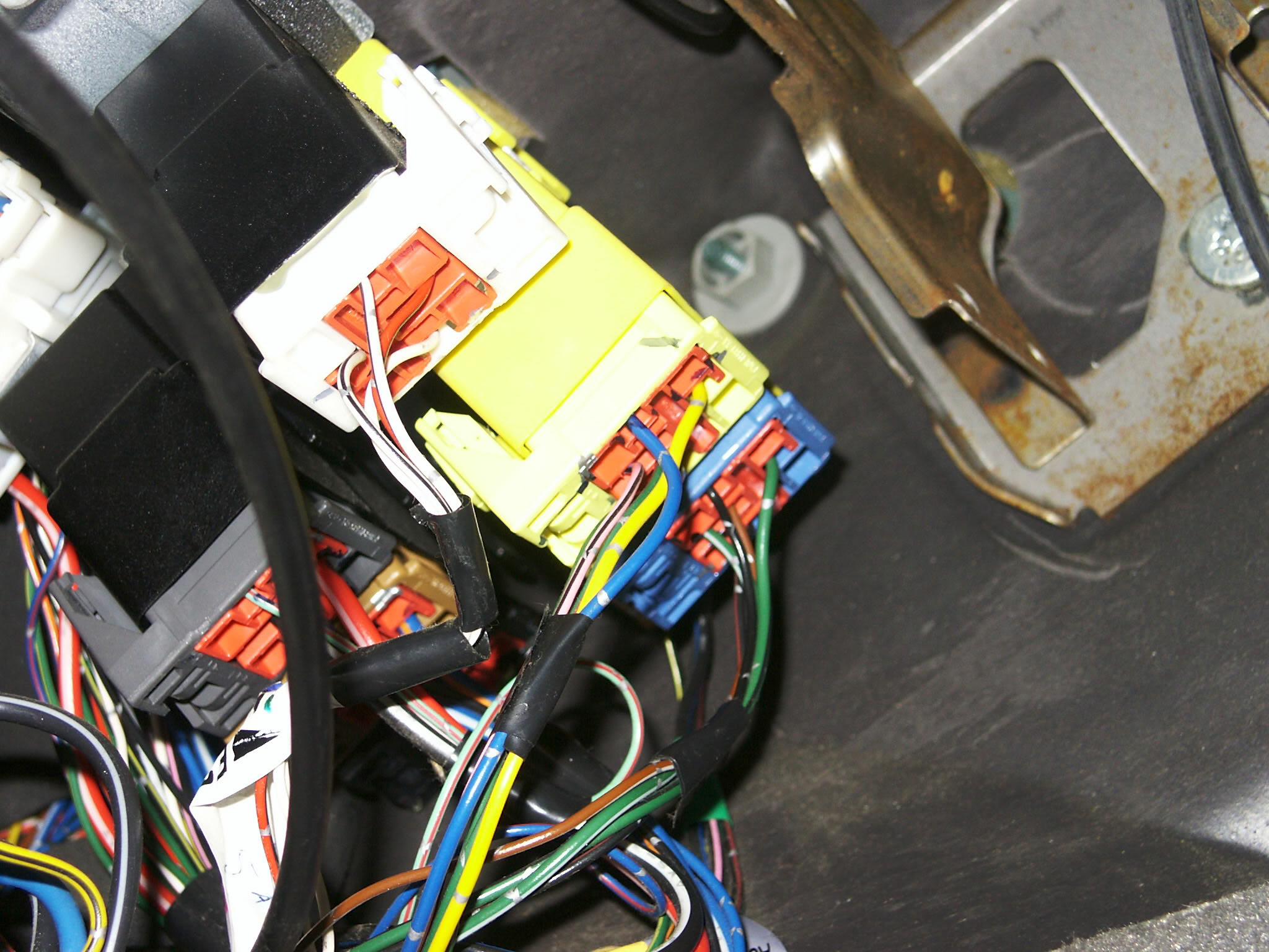

It's a big yellow chunk under the dash, to the left of steering column. It looks like two flashers combined into one as there're two plugs go into it. Each has 5 pins. The yellow is for turn signal, we tested that by unplugging it. The blue, I'm not sure but maybe it's the emergency flasher...

The part number is F7C6 13N360A. I can't find an exact replacement on eBay, but this one looks pretty close(not sure if posting eBay auction is allowed here. If not, I'll remove it later):
eBay Motors: LED Replacement Flasher Ford Dodge Jeep 5 Pin EP-27 (item 220118362630 end time Jun-09-07 16:52:48 PDT)
I'd like to know if anyone can confirm this is the right one, and if I need to buy two and duct-tape them together. I'll check with the seller as well...
