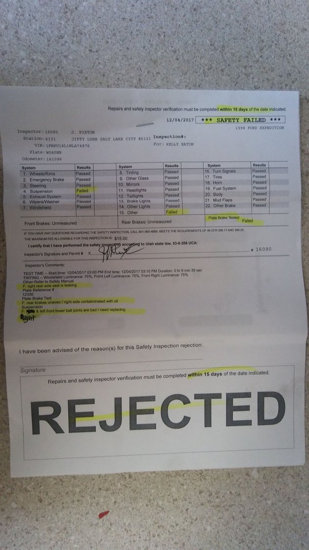

As the title suggests I own a 1998 Expedition and try to maintain it myself so often as I am able. Last September I replaced my front rotors, calipers, and pads (along with a few connecting pieces that had deteriorated), and now my front and rear brake force is imbalanced, as are the right and left of my rear. I literally live in my truck and have little income, so anything I do needs to be evaluated against my ability to feed myself.
Brake Force Results:
The essence of my questions: Please recommend a good resource for repairing a rear axle seal, along with the necessary tools.
Please recommend cost effective brand for rear brake pads, calipers, and rotors.
Please recommend resources for replacing my right and left front lower ball joints.
Thanks so much for any input!

Not knowing the condition of the rear brakes and parts , it could be anything from worn parts, self adjusters not working, yes even grease getting onto the brake friction surfaces. The better thing to do is to shop around and get a few estimates from different shops only make sure to ask them to please put in writing exactly what you will be getting for your hard earned money. Without the written itemized estimate , a shop can low ball an estimate and you think it's a good deal only to find they don't do a complete job, if that is what is required. Different areas of the country charge different labor rates and cheap parts certainly are not the same as good parts.

As far the as the Report, and the rear brakes,, the best bet would be to break it down for inspection and like with the images you provided, post them here so we can see what your up against, as well as brake wear patterns for the fronts. If you haven't driven the X much, it wouldn't be unlikely to see some discrepancies in Front patterns from R-L. Until the new rotors and pads 'Bed In' meaning slight differences in surfaces equal out, there's always the potential for some slight application differences.. If it proves out that the rears are lube contaminated, we can provide you with some tech help/images..
