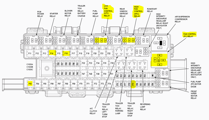

Ok here is the diagram for the cooling fan.
The wiring is fairly easy, PCM supplies a ground to the fan relays depending on which fan and speed it wants them to be on.
Since you want to know what is next to replace I guess it would be the relays and fuses. They are not that expensive and very easy to replace compared to the cooling fan, the relays are 5 pin relays and it will not work right with 4 pin relays.
I would look over the wiring harness in the engine bay for any chaffing or damage, I can also post connectors views so you can test the wires but that can be difficult since its a intermittent issue.
At least try to get it to act up once with the hood open so you can tell if both fans turn on or only one turns on.

check relay below glove box.
