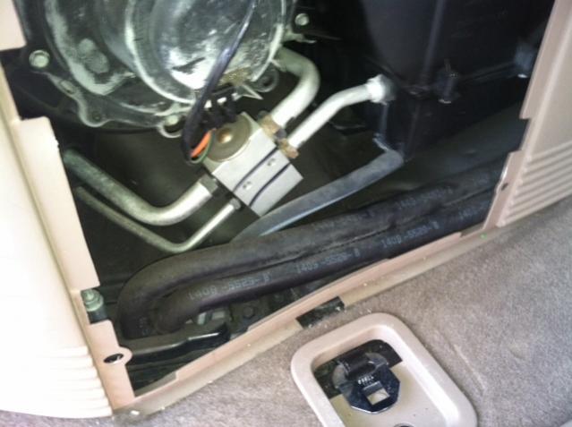

Additionally in the rear of the vehicle near the sub woofer there are two hoses and they seem very hot to me after driving around???? Is this an issue. Thank you guys and gals in advance.
In the pix it appears to be A/C components.
