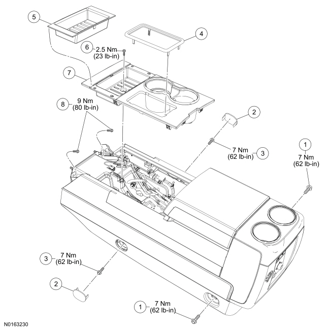

Is it really hard to take the console and shifter area a apart? I would want add some felt pad to reduce the noise.

Console — Front, Floor, Expedition
Item Part Number Description 1 W710806W710806 Front floor console rear bolts (2 required) 2 78045H8878045H88 Front floor console bolt covers 3 W710806W710806 Front floor console front bolts (2 required) 4 78045K0878045K08 Selector lever trim ring 5 045G34B045G34B Front floor console utility tray mat 6 W707382W707382 Front floor console utility tray screw 7 78045A7678045A76 Front floor console upper finish panel 8 W716533W716533 Front floor console front screws (2 required) 9 78045A0678045A06 Front floor consoleRemoval
All vehicles
  1. Apply the parking brake.
  1. Position the selector lever in the NEUTRAL position.
  1. Position the front seats forward.
  1. Remove the 2 front floor console rear bolts.
  1. Position the front seats rearward.
  1. Remove the 2 front floor console front bolts.
    • Remove the 2 front floor console bolt covers.
    • Remove the 2 front floor console bolts.
Vehicles with floor shift
  1. Remove the selector lever trim ring.
All Vehicles
  1. Remove the front floor console utility tray mat.
  1. Remove the front floor console utility tray screw.
  1. Remove the floor console upper finish panel.
    • Disconnect electrical connector(s).
  1. Position the selector lever indicator bezel aside.
    • Release the 4 retainers and position aside.
  1. Disconnect the selector lever cable from the selector lever and the floor console.
All Vehicles
  1. Remove the front floor console front screws.
  1. Disconnect the front floor console electrical connectors.
    1. Loosen the bulkhead electrical connector bolts.
    1. Disconnect the bulkhead electrical connectors.
    1. Disconnect the electrical connector.
  1. Remove the front floor console.
Installation
All vehicles
  1. Install the front floor console.
  1. Connect the front floor console electrical connectors.
    • Tighten the bulkhead electrical connector bolts to 3 Nm (27 lb-in).
  1. Install the front floor console front screws.
    • Tighten to 7 Nm (62 lb-in).
  1. Install the selector lever cable.
  1. Install the selector lever indicator bezel.
All Vehicles
  1. Install the floor console upper finish panel.
    • Connect electrical connector(s).
    • Make sure to align the trim panel retaining clips to the retaining clip holes in the floor console.
  1. Install the front floor console utility tray screw.
  1. Install the front floor console utility tray mat.
  1. Install the selector lever trim ring.
All vehicles
  1. Install the 2 front floor console front bolts.
  1. Install the 2 front floor console front bolt covers.
  1. Install the 2 front floor console rear bolts.
  1. Position the selector lever in the PARK position.
All vehicles
  1. Release the parking brake.
