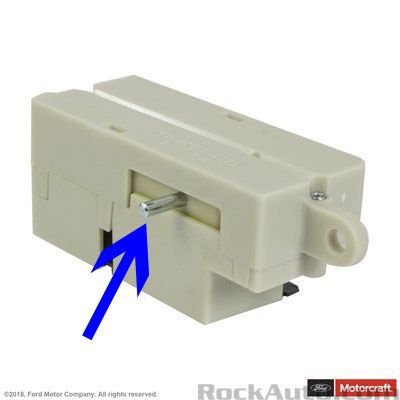

The ignition lock cylinder, when turning, will only move the **** (as shown above) on the ignition switch. If something is stuck more than likely it's the ignition switch, not the lock cylinder. The ignition switch itself is under $20, you don't need to buy motorcraft.
When the ignition switch is removed, move the **** left and right by hand there is a spring return from start back to run position and it's pretty tight, 2 fingers to move it. If the spring is too loose or stuck just disassemble it and try to fix it or just buy a new one. Your lock cylinder should be fine, no worry about the need to replace new keys.

I've been driving it by manually cranking it with the ignition switch, the ignition cylinder turns and the key comes out, but it is stuck in the "on" position even when the key is removed. It felt like something snapped inside the lock cylinder, I'm trying to find a way to repair the cylinder without replacing it. The ignition switch is working fine. Otherwise, I guess I'm lucky that it is stuck "on" instead of "off" - because I can still drive the damn thing lol.
