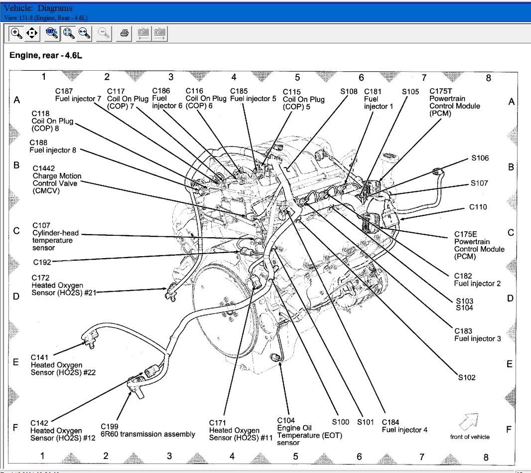

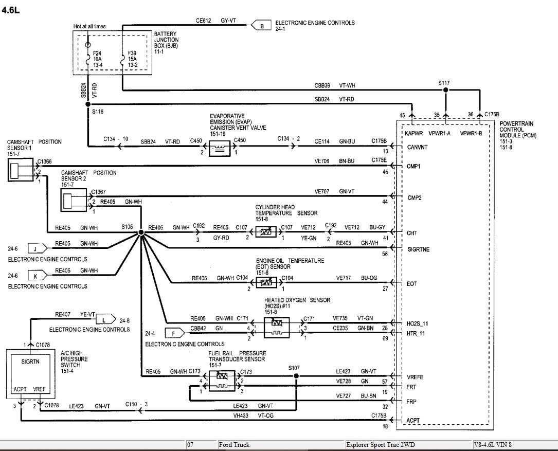

Locate C107 (CHT) above, you can see it goes to C192 and S105 (Splice), then back to the PCM So locate them below and disconnect and clean them using 91% isopropyl alcohol (pour into a spray bottle and spray). Also check all the wiring, replace if needed.
The ECT appears to be for 4.0L V6 only.
If you look at below diagram and locate C104 (EOT), you can use your scanner or OBD2 adapter and retrieve the reading in a cold start. The temperature of your CHT should rise much quicker than EOT, to reach let say 200 degree F, CHT in 5 minutes vs EOT in 10 minutes. If not, there could be a problem with your thermostat (stuck open) or non-OE opening temperature or even problem with your fan clutch.
It looks like your temperature gauge on cluster gets its reading from CHT, indirectly. And replacing a cluster probably doesn't help, so don't waste money at this point. If you must replace it, you can remove just the temperature gauge from another one and replace yours, not necessary the whole cluster. The temperature needle, when fluctuating, 90% of the time you have a bad/broken/short wiring. The CHT should last the life of your vehicle, but the wiring is not.
