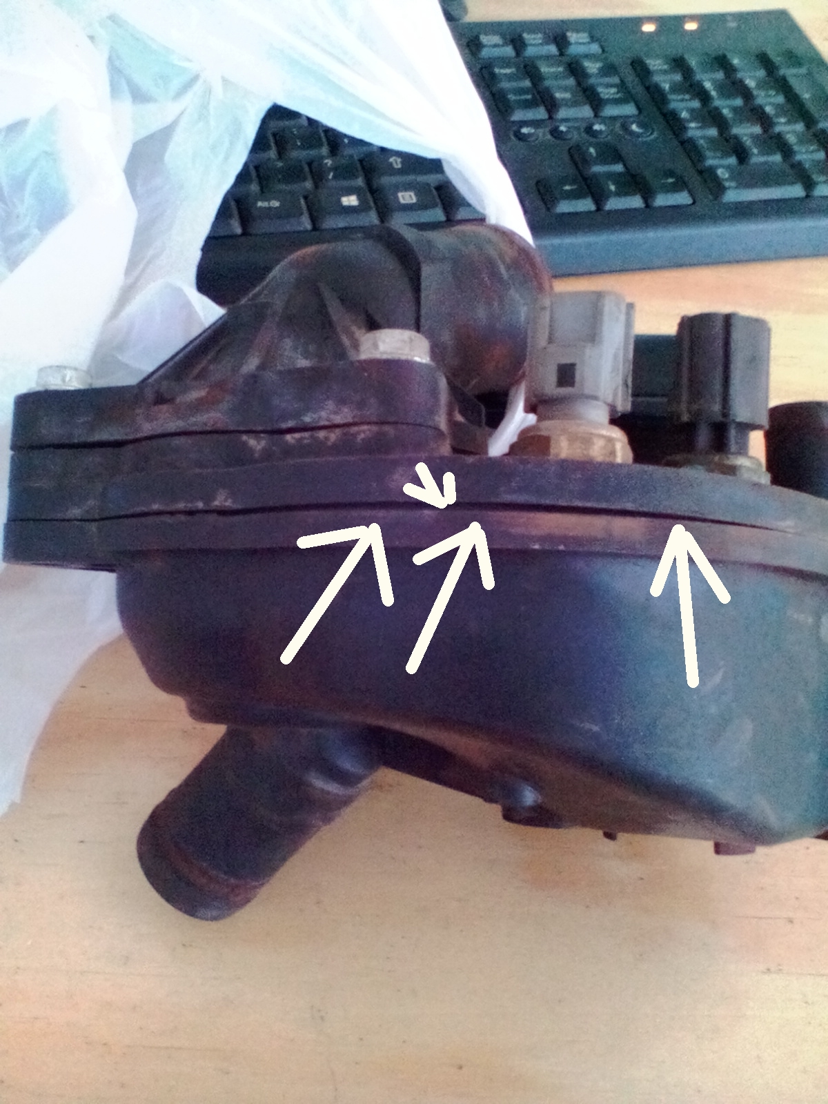

Thanks for the reply, but as can be seen from this second image with the arrows pointing at the leak area, when I reverse flushed a garden hose it was spraying in a fan type display. I check every week so it happed suddenly, I think it was a Thursday hissing noise and overheating and high ideal in neutral.
Definitely not the mounts or hose connection issue. My Ex is in perfect condition save for this issue and a non functioning AC.
I wish someone could shade light on the better aftermarket substitute quality : a Four Seasons make Vs a Gates brand being better. Of course I would have loved the Motorcraft but at 10 times the cost it is illogical. I have seen them from $40 (generic) - $400 (motorcraft) only for my model - probably saw a sitting duck
The ones after 1999 (ie 2002 etc) are about $60 (motorcraft) but not for mine.
I have put the Gates one since I don't know it origin!

That's the common leak point, even OE housings.
